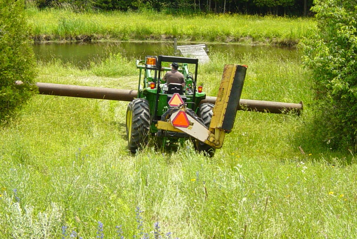

I have a PERFECT 3ph Boom Flail mower by Van Wamel. It has the duckfoot blades. I had a customer whom I did his ditches for once a year, and then did some of my own stuff, but that property was sold and the new people aren't interested. So, it never left the shed this year. Hitting stones will destroy the blades and any profits in the job! Having got the new hydraulic sickle bar, it may have even less to do in future.
It's kind of a difficult thing to keep at the right level. You basically have three adjustments, the 3PH height, the mower angle and the distance it is out. A lot to do, along with watching where you are going. Definitely best used with a hydro, although I don't.
Considering it will shred 4" material, it works surprisingly well on grass too.

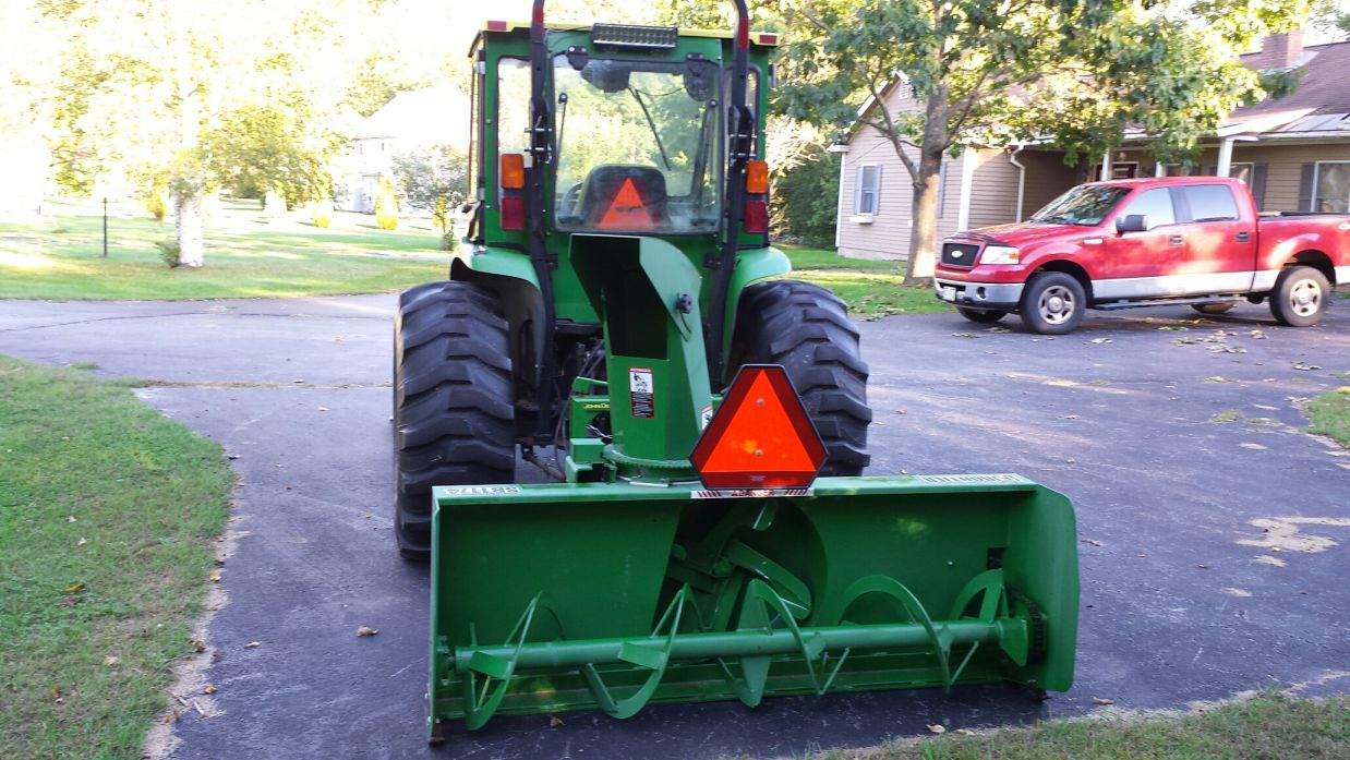

Good suggestions and something to think about. My tires are set pretty wide
and I will have to do some measuring and investigation.
Since where I mow is pretty flat, I may not need them set that wide, unless the backhoe boom requires it.
