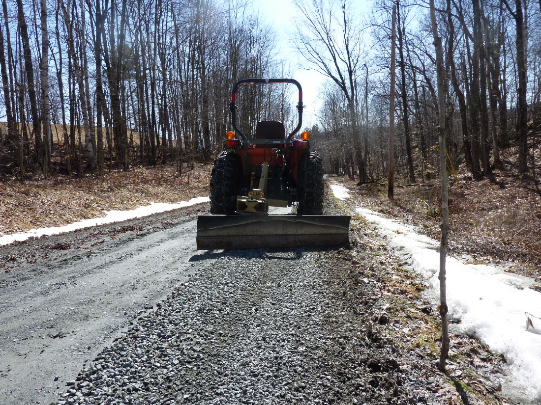

I offset my blade in the spring when I clean up the road edges for the spring melt and don't want to run a tire on the soft edge. If you have dry snow the side pull shouldn't be bad. If the snow is wet it is tough no matter what you do.
I would try it both ways. Then you will know. Nothing like personal experience you can share with us.
It is a small pita to offset that blade. I have the RBT1572.
