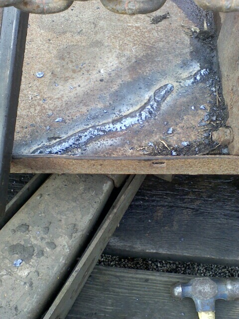

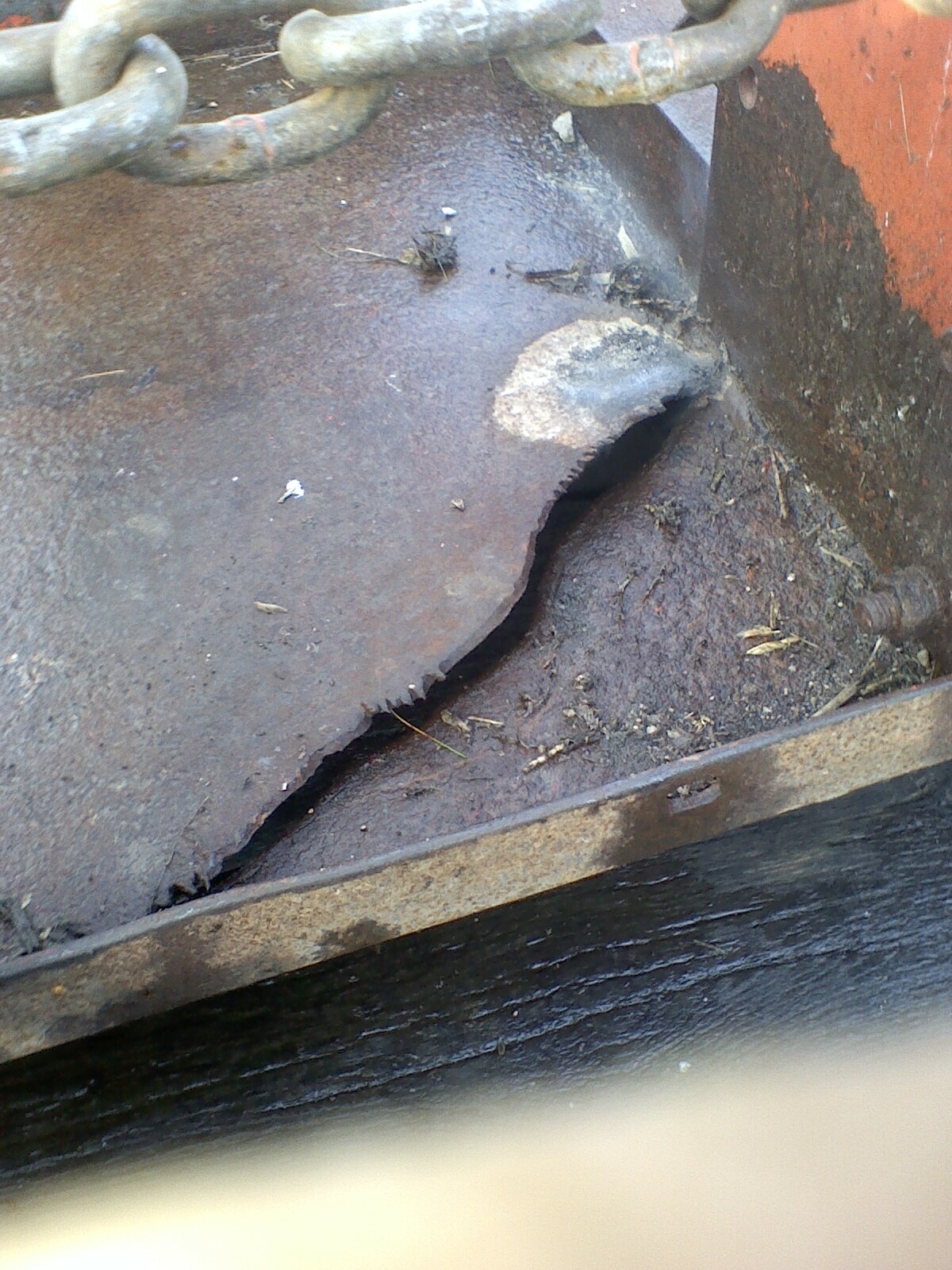

Here is a pics of a weld I just did this weekend on this machine. Not bragging or anything:laughing: The first ones are a before and after repair on the Bushhog 306 deck. The pic really doesnt do it justice. But it is all 7014 rod:thumbsup: Not to mention the two trailers that we have built that I have posted on this site several times over the years. All done on that machine and all still going strong:thumbsup: I have some pics of some better welds I have done, I just cant find them at the moment.

You guys can bring out all the charts etc that you want to show the characteristics of each welding rod and such. I didnt say it didnt make a pretty weld. That is why that shop foreman liked them because he was a somewhat welder in that he could put a hood on with the lens facing the right direction and he could lay a pretty bead with the 7014 but not so much with anything else. The fact that ShieldArc made a coupon bend with them is also not surprising given his welding skills. If you can keep the slag out of the puddle, it looks OK. As long as they are welded slightly uphill, and with a wide gap when in a V groove they work ok. Slag entrapment is a problem in thick specimens and you can end up with a slag line down the middle of your weld sometimes and never see it forming. For your average Joe welding of sheet metal, they will do ok. I merely provided my 40+ years of professional welding experience to the forum. What you find in charts and text does not alway equate to what you get in real life, like the Murex chart that gave 6010 a 4 for open butt groove welds. I would guess that several thousand pipeline welders would disagree with that as nearly all of the gas pipelines in the world prior to 1980's were welded with 6010 electrodes downhill. My advice: Use whatever electrode you find does the trick for you, if it breaks, you still own both pieces and can weld it again. The welding done in your shop is not going to release a toxic gas cloud into the air should it fail. That is the reason 7018 is specified for 99% of all carbon steel SMAW filler welding in pressure piping.
By the way, 7014 rods should also be kept in a moisture controlled atmosphere for optimum shelf life and porosity free welds.
By the way, I am a certified welding inspector with American Welding Society and ASNT-TC-1A and have held pressure pipe welding certifications in practically every weld metal used in modern construction and have been a certified welding instructor for many years. For the last 25 years I have managed Quality programs for a major engineering and construction company. I am not a metallurgist, but I can make two pieces of metal stick together and can pretty much tell when a welder is doing something wrong by just listening to the arc, but feel free to disagree with my findings through experience if you so desire.
