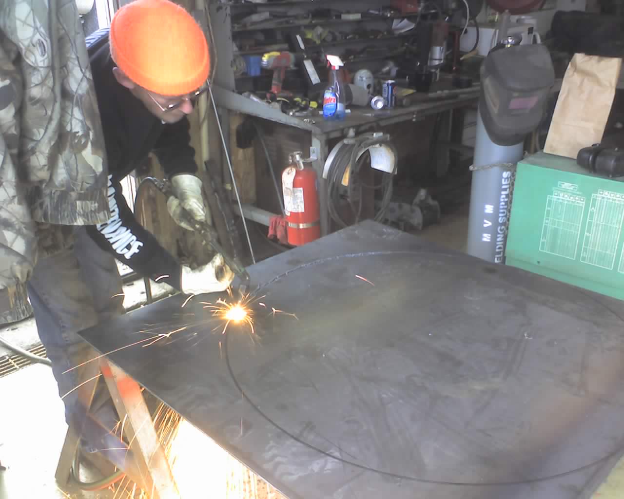

No switch to choose betwee AC/DC.
The only swich is the Main On/OFF at the top.
One thing kinda puzzling though, if it were an AC only machine, why would it matter which hole the singer and which the ground is plugged into??? Because they ARE different sizes.
I can remember which one is which, But one has the A and B option, And the other has about 10 or 12 different holes to choose from. Beside each of those holes is two amperage ratings, one for A, and one for B.
I'll have to see if I can find some pics. The welder isnt at my house currently:confused2:
   / Oh baby, where you been all my life? #48

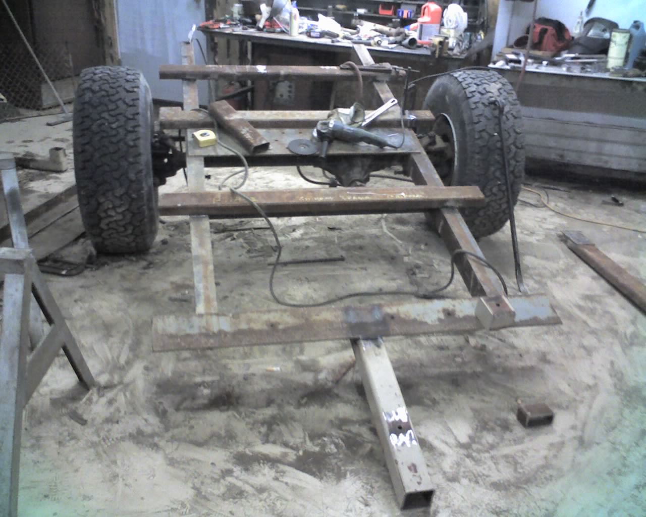

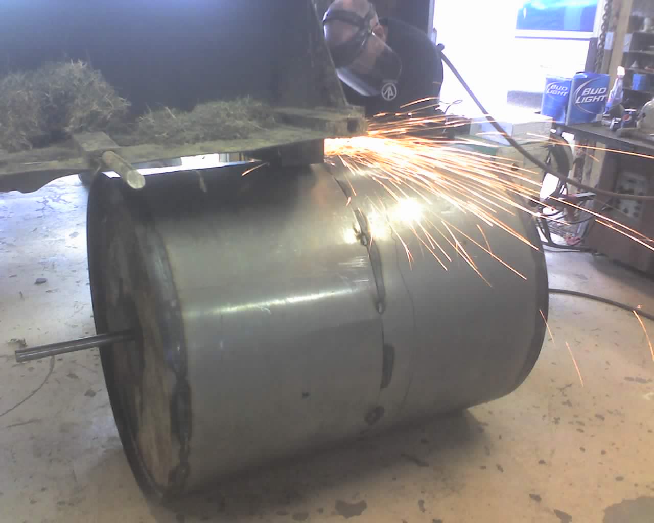

Maybe these pics will help. Sorry but they are the best ones I can find in my inventory. But look close any you can make out the welder.
And it does appear that it only has 8 holes for the amperage setting PLUS the AB. So a total of 16 different options.

On AC there is no such thing as polarity since polarity is autimatically alternating back and forth at 60 hertz. My guess is the original maunfacturer made the plug on the ground wire different to idiot proof it so to speak. It keeps someone from accidentally plugging the ground clamp into a hot tap right right next to a stinger hot tap. This would not weld and might even damage tranformer if someone accidentally did this. With AC you theoretically could move your stinger to end of the wire with the unique tap and move the ground clamp to the wire that changes tap ports for amp selection and it will not alter welding performance.
