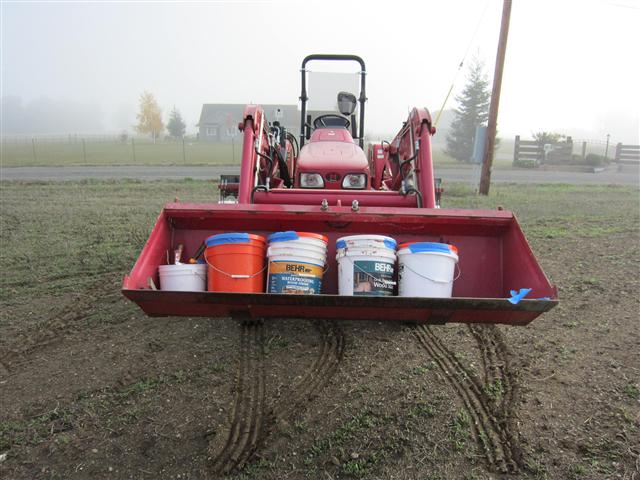

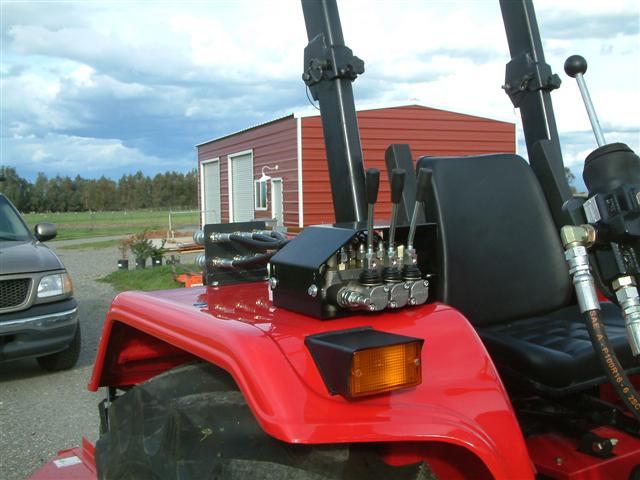

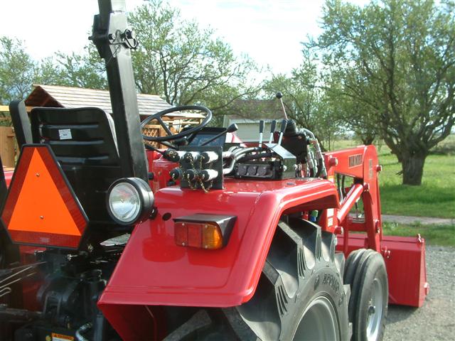

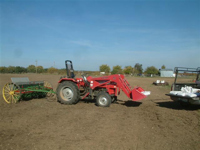

I have an almost identical situation--10 acres flat pasture that includes 6 acre hayfield, about 1.5 acre almond orchard and the remainder buildings and landscaping. My big tractor is a 2008 Mahindra 5525 (54 hp engine, 45 hp pto, 2WD, power steering, gear tranny 8F/2R, triple rear hydraulic remotes) with the ML250 FEL (6-ft wide bucket, 2950 lb lift to 10.5 ft height, skid steer quick attach feature). Cost: about $19K new. I mow with a 6-ft wide Hawkline rotary mower (aka bush hog, brush hog, shredder, slasher) that cost $1150 (bought as part of the 5525 deal).
Some folks might think this tractor is oversize for just 10 acres, but I put in 6 acres of hay with it and it's the right size as far as I'm concerned. It's really aggrevating to realize that you didn't buy large enough tractor.
