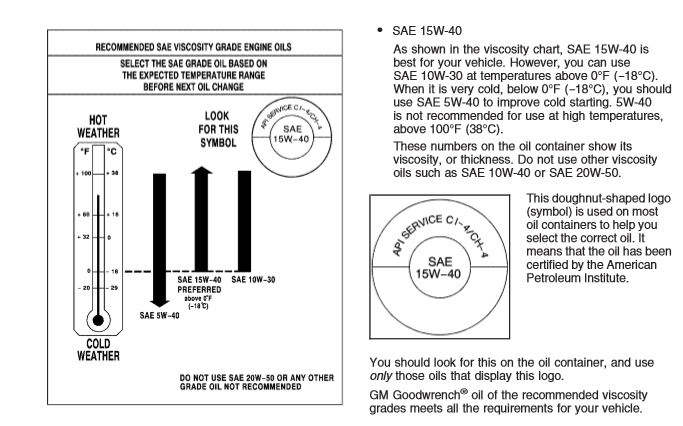

This question was why I started this thread, see attached Duramax owners manual guidelines. 15w-40 is the "best" for your vehicle, however for very cold temperatures 5w-40 may be used. Both my tractor and my truck are 2006 and the tractor service guidelines do not even acknowledge 5w-40 oil exists. I have run both 15w-40 Dino and 5w-40 Synth in my truck and there was no significant difference indicated between the oil analysis.

I have read literally hundreds of articles and reviews on oils and still can't seem to get my brain around the logic of using a heavy weight oil for hotter outside air temps. Why would you use 10w-30 for -20F thru 100F and 15w-40 for -10F thru 120F? I understand the lower cold startup winter weight however the operating weight makes no sense to me as the engine operating temp is well over the outside temp once the engine warms up to, let's say, 180F for discussion. If 10w-30 is ok for a warm engine why recommend 15w-40? My guess is it was nothing to do with outside air temperature and more do with them hedging against the quality of chemicals used to modify the viscosity to increase the span between winter and operating weights. SO, based on this assumption my take-away is if you always use a high quality oil "Brand X" than 5w-40 is the best choice for all situations.
Anyone see this differently?
