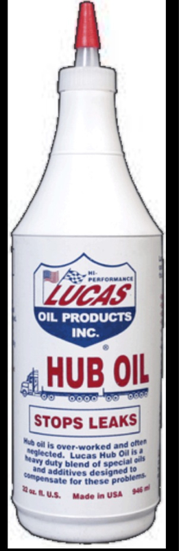

The oil bath hubs on my pj trailers take motor oil in them . They leak all the time . I run Lucas Hub oil . I over fill I feel better known'n there extra oil .
