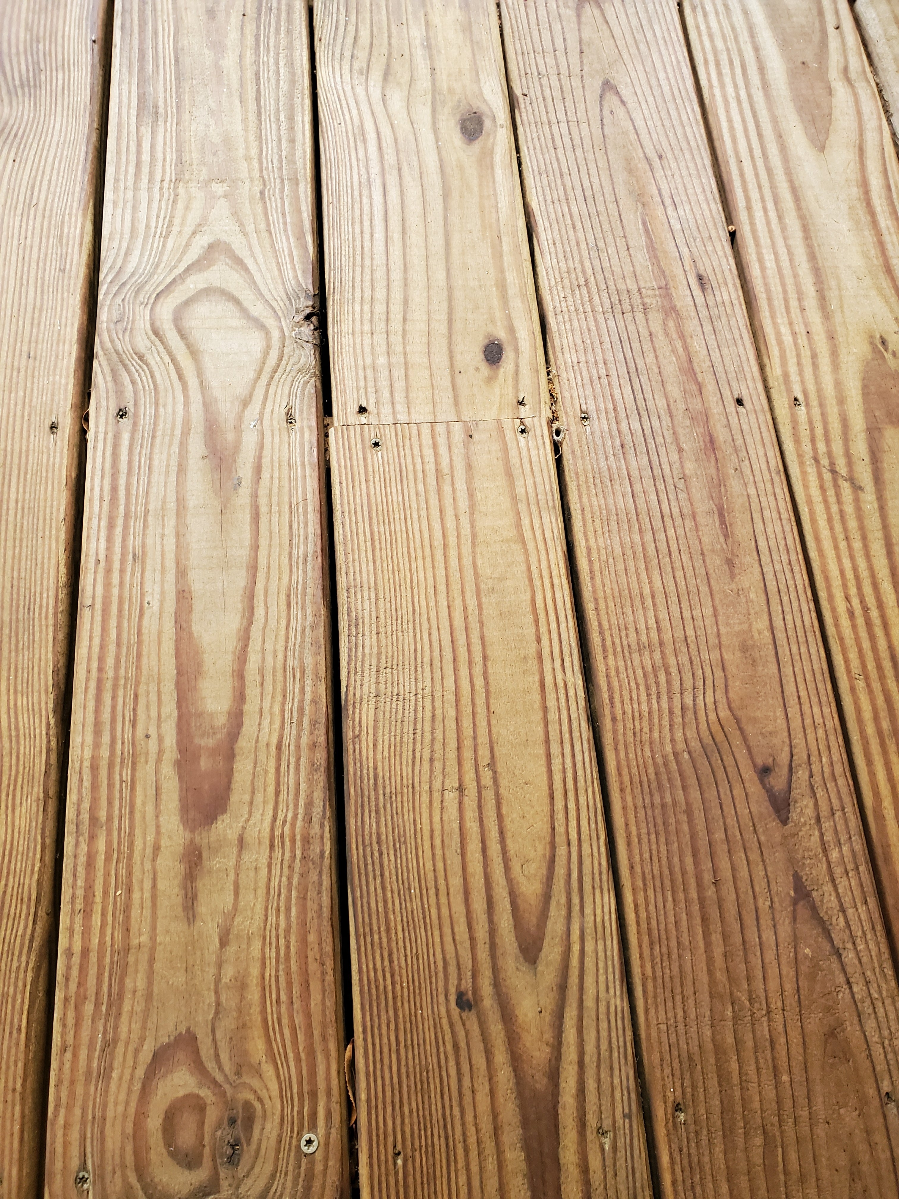

Ok, here is the question again, how long the smell is going to be there or it is indefinitely?
If it is a week or two, not a bigie. Can you give some rough estimate? Here is the wood. This part of the deck is original 8YO never saw sun nor rain. All the rest is just crap

It’s more than smell. Oil and diesel will make your deck even more flammable than wood boards. You’re basically pouring fuel on your house deck.

For me, oil/diesel treated fence posts stink for a long time, like years, but I'm sure everyone is different in their ability to smell.
I just think that there are lots of toxic chemicals in motor oil and diesel that you don't want to be inhaling any more than you have to.

Sorry but Thompsons water seal and things like boiled linseed oil are really crappy outdoor stains.
   / oil/diesel mix vs. Thompson's® WaterSeal for house deck #20
Having stained hundreds of decks professionally, if you want it to last and make it easy to clean, use a solid stain. I understand people want the wood grain to show through BUT solid stain is the best protection for your deck and makes it the easiest to clean.
