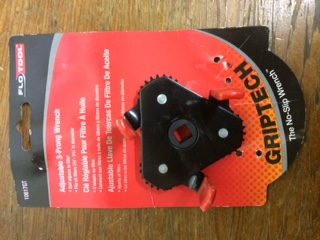

Re: Oil Filter Removal - SUCESS!
The first tool I tried based on suggestions from the group did the job. IMG_0579.JPG
The Harbor Freight "GripTech" with a 3/8 6inch extension. Didn't take a whole bunch of effort once jaws tightened around the filter. I lubed up the O ring well so hopefully the next change will not be such an ordeal. Hooked up the snowblower as the flakes are starting to fall here in the Cascade mountains of Oregon.
Thanks to all who responded!!
