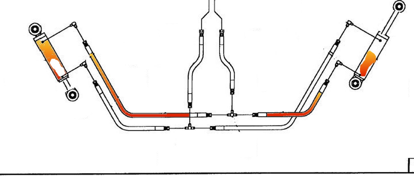

Or is the schematic this way, which would make more sense?
423762d1430959785-oil-recirculation-closed-loop-system-steering8-jpg
When you push more orange stuff in the cyl, where is the orange stuff on the other side of the piston going.
Answer: TANK

In your diagram, that is the same as saying the white hoses are supplying pressure. If the flow did not return up the vertical leg of the Tee on the "red" lines, then you have the red (low pressure side of the right cylinder) being stronger than the pressure from the pump. There is no way for that to happen if the red is connected at all to the return of a pump directly or via the tank because that line is at minimal pressure. If the red line does not connect to the tank/pump return, then there is no flow from the pump which means the tractor is not doing any work.
Ken

If you push the left rod in, it goes to the return via the tee.
If you push the left rod in, the right rod extends.
Someone just get in their car, drive over here and slap me silly cause I ain't getting it!!! :laughing:
/ Oil Recirculation in closed loop system #89
The majority is still getting transferred from cylinder to cylinder, and not much to the tank.
NOt true at all.
You are filling both cyl, period. Both are doing work.
The above is correct as the pump is filling both cyl and pushing old fluid to tank.
Turn the steering the other way and the flow reverses.

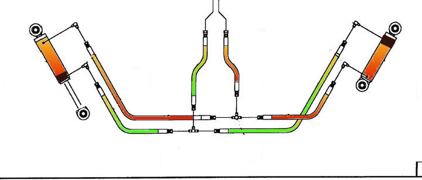

OK, I think I've got it...
The two full sides are tied together and the two empty sides are tied together.
Why didn't anyone say that before?
:laughing:
/ Oil Recirculation in closed loop system #94
Orange is pressure, green is tank. Turn the wheel and they reverse. Right? I think I finally get it. :cool2:

/ Oil Recirculation in closed loop system #96
ok, David, now lets see you animate that... and add the steering control valve for good measure...
/ Oil Recirculation in closed loop system #98
Orange is pressure, green is tank. Turn the wheel and they reverse. Right? I think I finally get it. :cool2: <img src="http://www.tractorbynet.com/forums/files/power-trac/423776-oil-recirculation-closed-loop-system-steering9-jpg"/>
So the fluid returning to tank is determined by the steering control valve position, ie whether turning left or right? This thread has been a great read.

Yes, that's the point.
