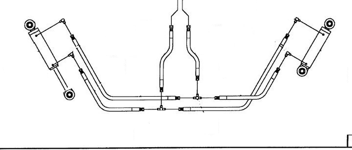

You said. [ For a given turning direction, the two supply (extend) lines are tied together. ]
Actually, One cyl extends and one cyl retract and are teed together.
If all the steerings circuit for the PT are identical, go back and look at the pictorial on post 21.
It is clearly laid out .
True, i had the function switched on the one cylinder but the principle is the same.
Ken
   / Oil Recirculation in closed loop system #72
If you push fluid into one side of a cyl, the fluid on the other side moves out or returns to tank.
And there's where you are mistaken. When you push the fluid into one side of this steering cylinder the fluid on the other side moves into the other steering cylinder, not the tank.
   / Oil Recirculation in closed loop system #73
If I put fluid into the base end of cyl 1 and put fluid into the rod side of cyl 2, both cyl will operate , with one pushing and the other pulling.
At the same time, fluid is leaving the other side of cyl 1 and other side of cyl 2.
Why don't you go out to your machine and tell me what fluid is where, and how much.
Will you look at the diagram you posted and tell me why there is a return hose from the steering valve to tank.
Tell me again about no fluid on the other side of the piston.
Just ain't gonna happen.
If I turn the steering about half way, will there be fluid on both sides of the piston.
If I am mistaken, so be it, but I don't think so.
By the way, what is the purpose of the tank return line from the steering valve?
Think about it, even the power steering in your car sends the used fluid to tank.
The steering cyl gets new fluid every time you turn the wheel. Does not matter which way you turn.

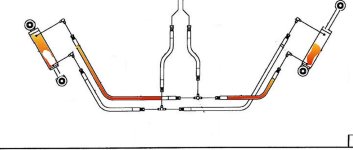

   / Oil Recirculation in closed loop system #74
Here's the circuit with the left rod extended and the right rod retracted.
423755d1430958343-oil-recirculation-closed-loop-system-steering2-jpg
   / Oil Recirculation in closed loop system #76
If I push that left rod in, where's the majority of the fluid going to go?
   / Oil Recirculation in closed loop system #78
Yes, the bottom of the cylinder contains more volume than the top of the other cylinder. I know that. The point is, the majority of the fluid just gets shoved back and forth between the two sides of the opposite cylinders. If the oil is getting exchanged completely, why is the oil in the cylinders discolored when the oil in the tank is not? It should be the same color.

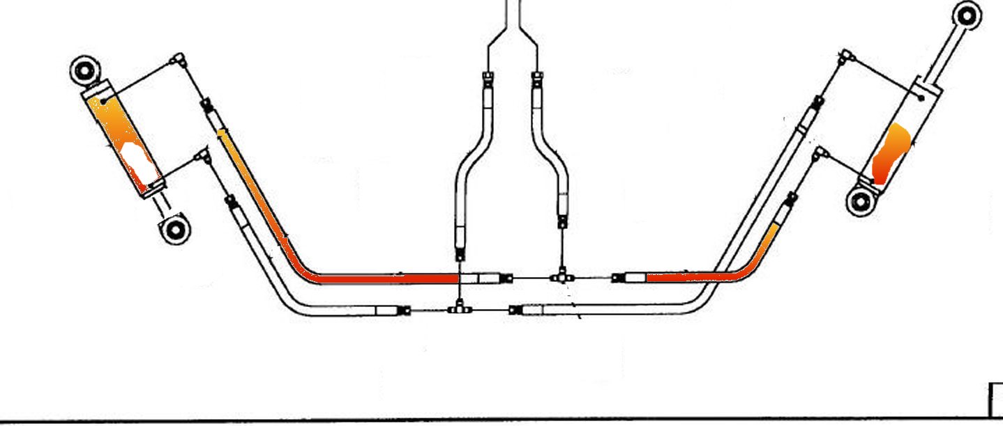

   / Oil Recirculation in closed loop system #80
Or is the schematic this way, which would make more sense?
