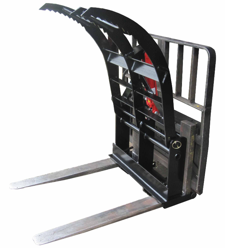

Here u go!
Just what you need for you forks! :)

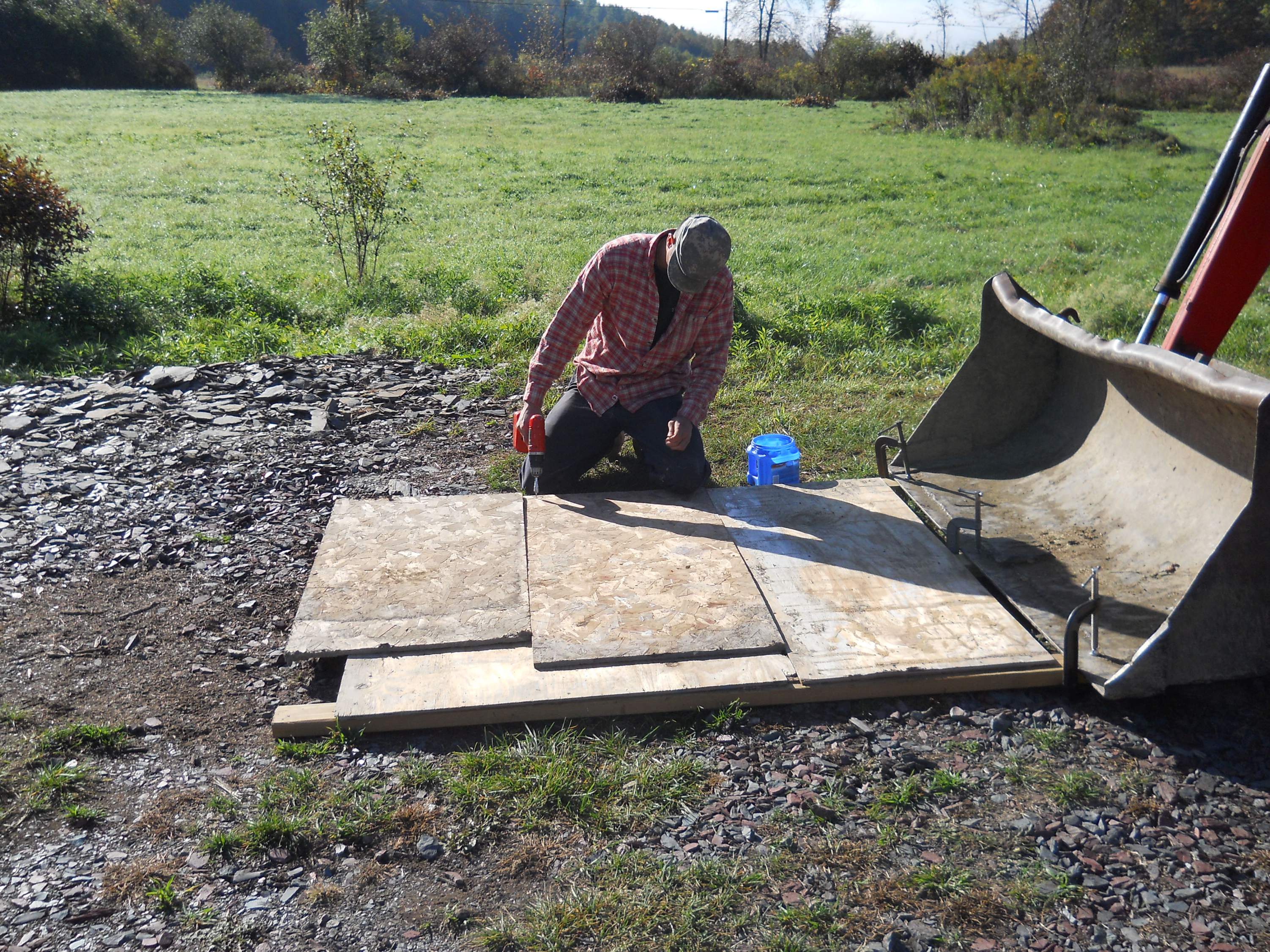

This is what we use for moving light weight bulky brush and cut off tree tops.... Easy to put together with three pt 2x4x8' screwed to scrap plywood deck pieces etc.... The assembly is attached to the FEL with three 6 inch C clamps... Great for moving a lot of brush at one time.... And very cost effective.... BumpyTruckBrushMov 001.jpg

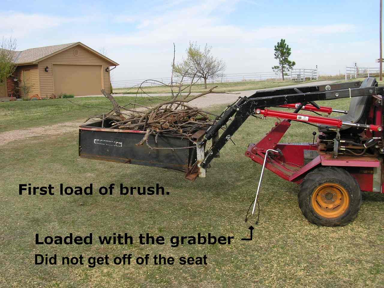

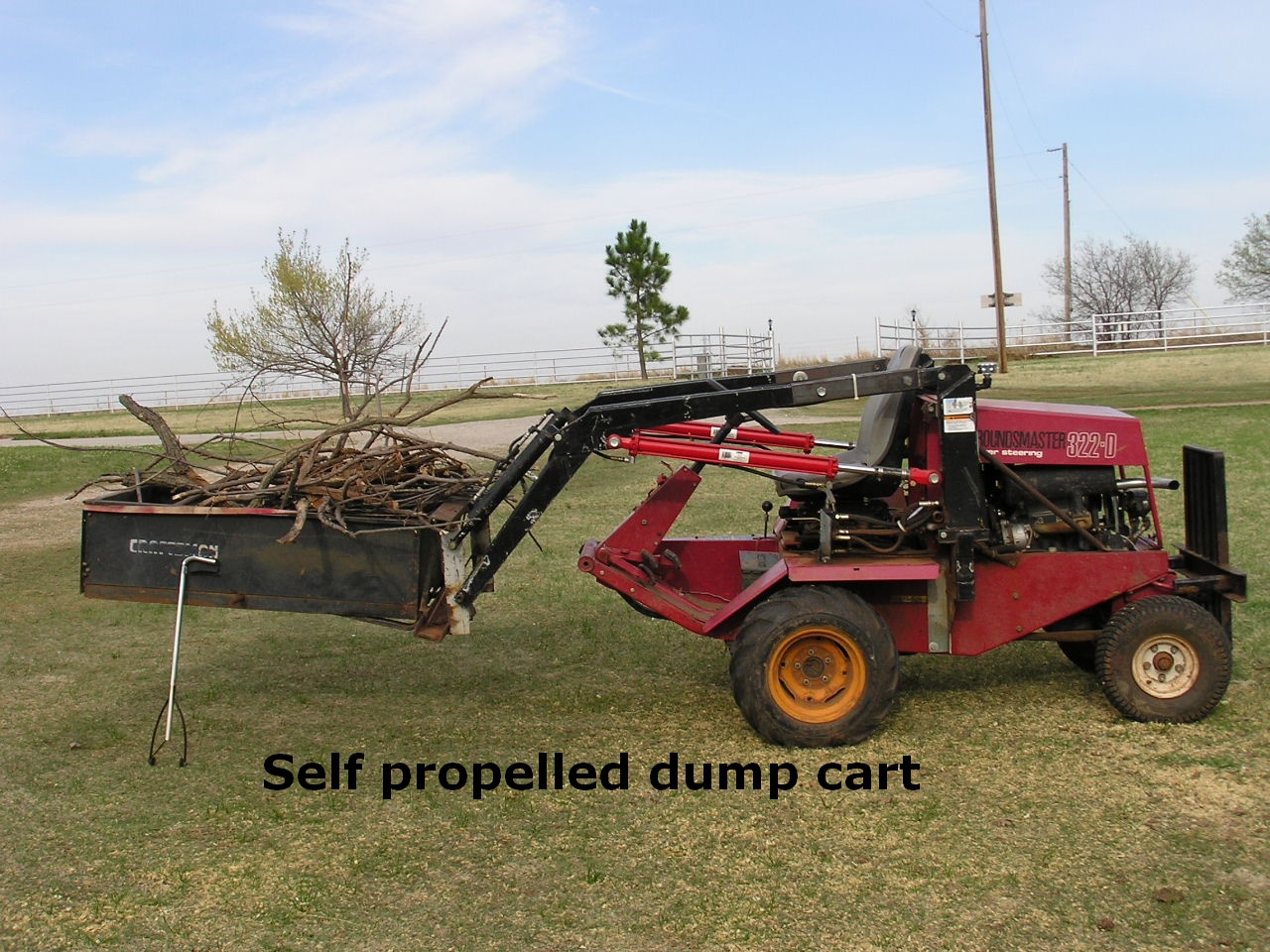

Everybody has to start somewhere. This is my first grapple, from four years ago, a hand squeezed grabber!
I still carry it in the cab of the Versahandler.
