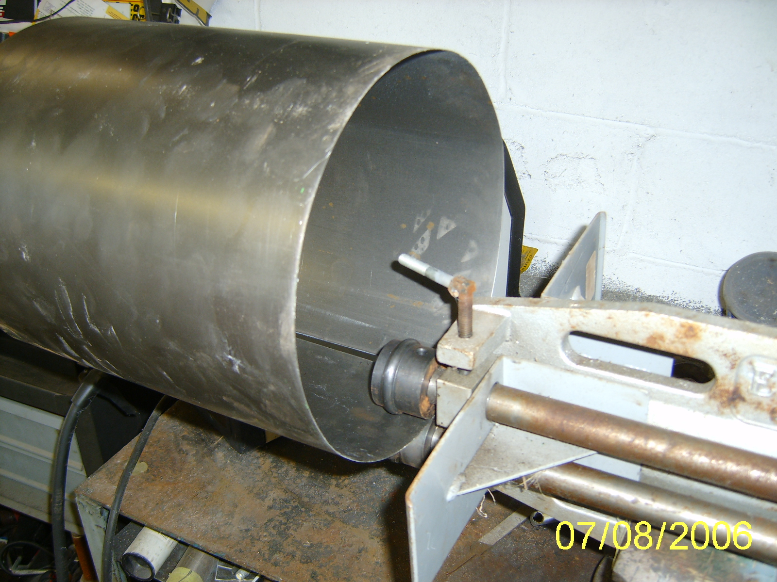

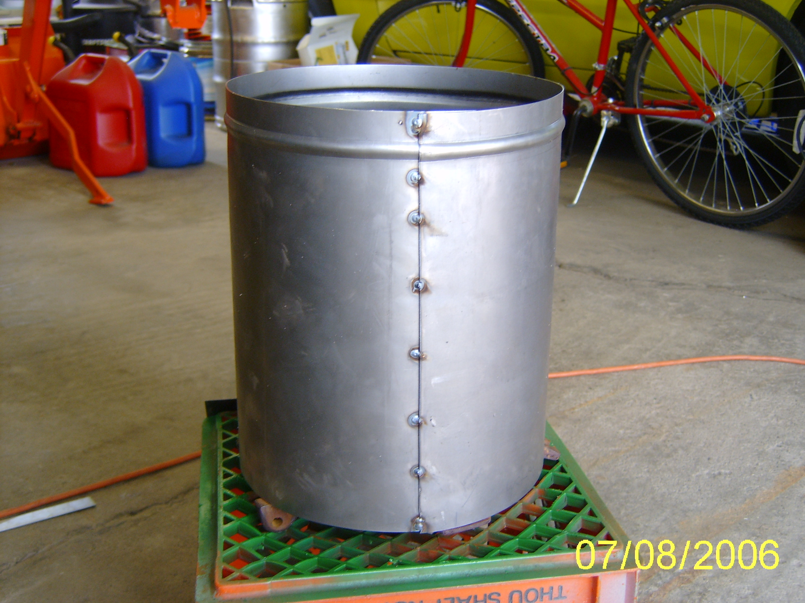

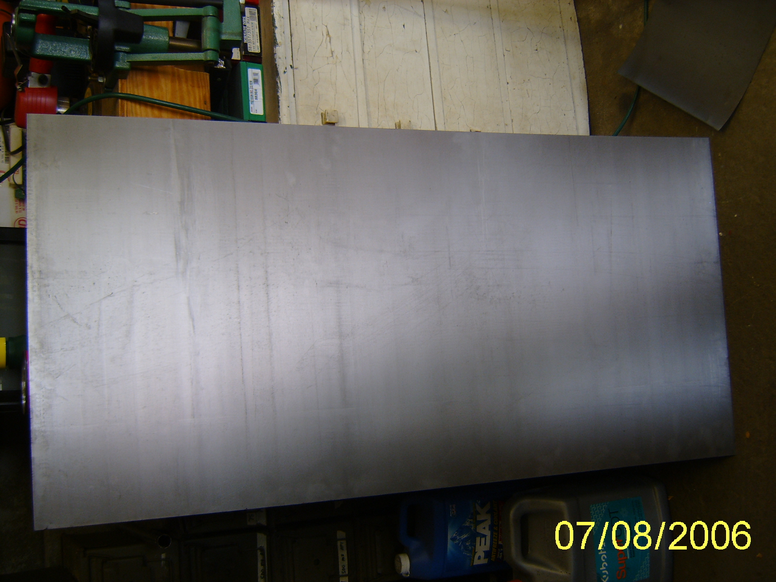

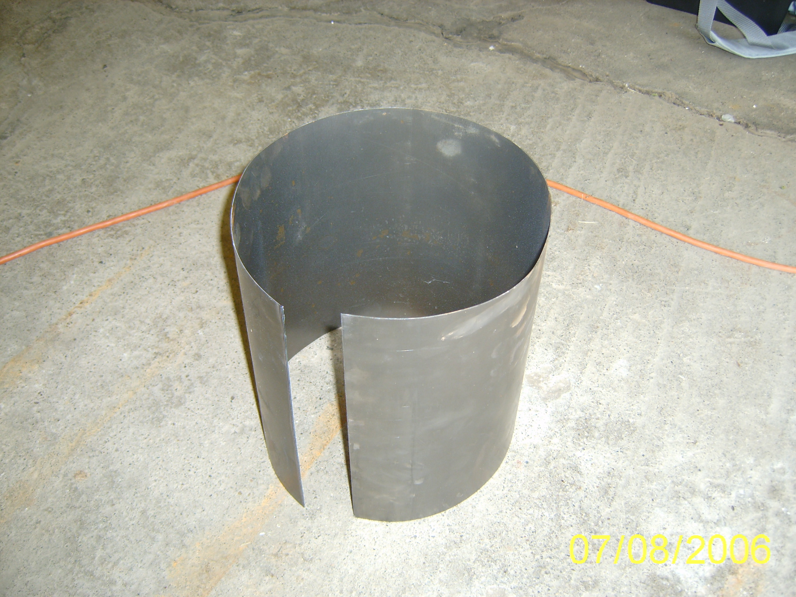

I made my own seed cans on a JD 290 that I restored a few years ago. Just bend some 20 gauge steel sheet around a gas cylinder (argon, co2, etc) and then weld it along the edge. Best to overlap it by 3/4" and spot weld it using Mig welder. Then roll a bead along the top of the can using a 3/8" bead roller. Obviously, you will need a welder and bead roller or at least know someone who does.

Brian, I hope my hoppers are salvageable, but just in case, what type of business has a beading tool? I have a good mig welder, but have never seen a bead made. Pretty cool. Thanks for sharing that.

Eastman tools has a bead roller as does Harbor Freight (Fright) tools. Metal working shops use them as well as automobile restoration. You can look either up on the respective vendor's web pages.

Brian, NICE seed tank!!! Did you also come up with a cover for it?
