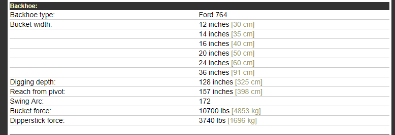

anyone know how this would handle a large 3 point backhoe? Tractor data shows the 3 pt hitch on this thing is only CAT 1 rated which seems crazy for such a big heavy machine
   / Old rusty Ford 545c industrial tractor 4x4 what do I need to know? #14
The backhoes I have seen for industrial tractors do not mount on the 3 point arms. Typically, the arms are removed and the backhoe mounts on the pivot points for the 3 point arms. In some cases, there is a subframe that mounts under the tractor.
As to size, it is relative. Just saying that it is a large backhoe, you need to look at the weight and the force generated by the hydraulics. The recommended backhoe for this tractor is the Ford 764. You need to look at the 764 specifications and compare it to what you are looking at. 545 backhoe.PNG

Ya i know about the 764 but seems pretty hard to find a 764 around here with proper hydraulic installation kit and all. which is why i was looking for a simple 3 point hitch mount variety. the 764 specs are utilizing different anchor points i think not using the 3 point hitch. https://www.tractorbynet.com/forums/hydraulics/217017-ford-new-holland-345c-764-a-2.html i did some reading on this thread here.

You can always make a frame mount for it. And or keep looking for the 764. The 764 is probably not the only one that will fit, so you probably need to do some research on models before and after to see what will fit. And just keep looking.
