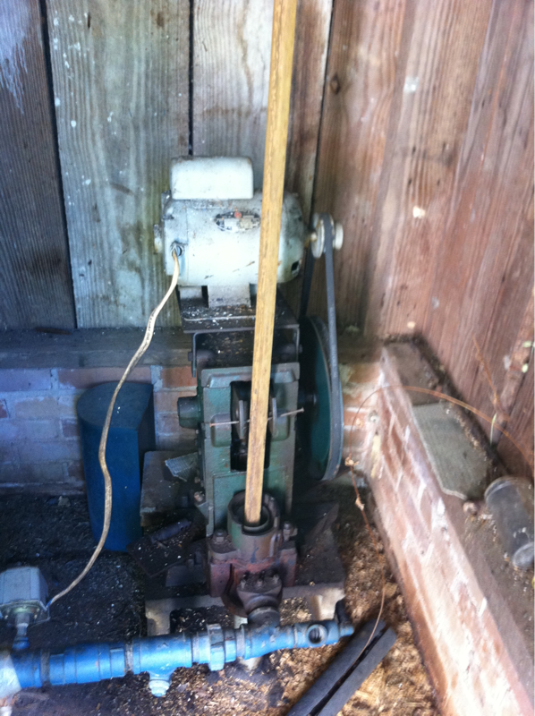

Pull the whole casing up? Is that possible?
Then what?
   / Old Water Well - Sucker Rod Down The Pipe #12
Then you can take out the sucker rod and disconnect the pump and service what needs servicing and replacing.:D
I was under the impression that you wanted the pump out. :)
The pump is screwed onto the bottom of the tubing. The piston [plunger] is inside the pump. No way does it come out with just the sucker rods.
The tubing should be hung from the wellhead casing.:)

the setup is a single pipe casing with several wooden sucker rods joined together. I thought if you pulled up the rods they would pull up the piston?
Would the well wall collapse if the casing was removed?
This is something a lot different than I've heard of but that don't mean much.:confused::confused:
Was the well pump in operation when the rod broke?

Yes, previous owner was having the leathers replaced when one of the rods broke.
No telling when this happened though.
   / Old Water Well - Sucker Rod Down The Pipe #18
Any chance this well was drilled, not cased and the tubing and pump run down the bare hole??:confused:
Might be why the sucker rod broke when the previous owner was trying to pull out the plunger?

There is only one two-ish inch pipe with a sucker rod coming up the middle.
Here's a picture of the setup.
#20
This is a better picture.
Now, the farm is about an hour away so I can't run out and check it out... But in this picture, you can clearly see the casing coming through the concrete floor.
If you look at where the pvc I have going down where the sucker rod goes.... It looks like the pipe the pvc is going into is a smaller diameter than the casing?
Could this be? Could I have this all wrong, and there IS an inner pipe with a sleeve attached at the bottom like yall are saying?
The size difference is pretty small if it is at all different... I won't be able to get another look at it until Friday...
