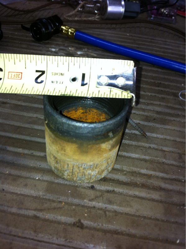

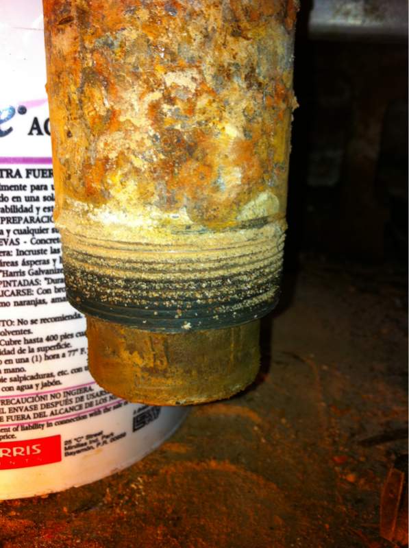

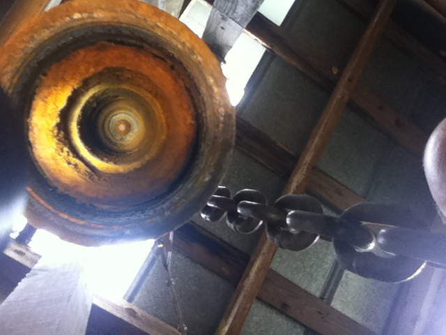

I finally got back to trying to disassemble the casing I pulled out of the well.
At the bottom of the last twenty foot section was a coupler that attached to the screened section and point. I got the coupler off and there was another coupler, it had about a 1-15/16" OD 1-1/2" ID. Above that in the casing was what looks like a check valve. The coupler screwed onto it. I could not pull the check valve down, out of the pipe. I tried putting the coupler back on and banging on it with a block of wood and little sledge, but it wouldn't budge.
So it looks like the sleeve is probably right above the check valve and is wedged against the wall of the casing. Instead of having a down pipe, it just used the casing with the brass sleeve up against the wall of the casing.
Now I'm thinking of cutting the casing a few feet from the bottom. I have no way of rethreading the pipe, it's a little over two inches. I looked for a tool to rethread it, but only could find two inch threaders. Do you think this is a good idea?
It looks like I'm going to have to go back with a 1-11/16" cylinder and down pipe with a 7/16" steel sucker rod.
The well was 40' with the water level somewhere just over 20'. Now that I have everything pulled, I'm not exactly sure what to do next. I'd like to have ten or five foot casing sections so I could more easily handle them. Any suggestions?

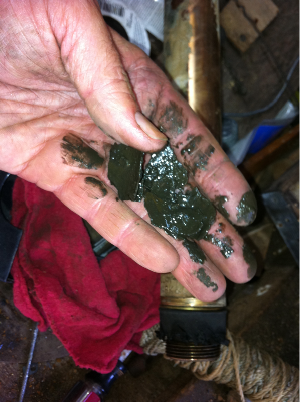

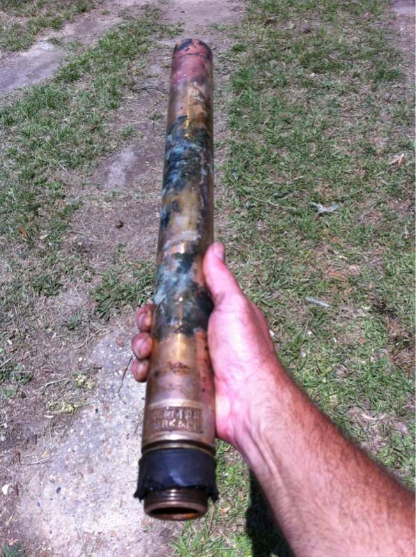

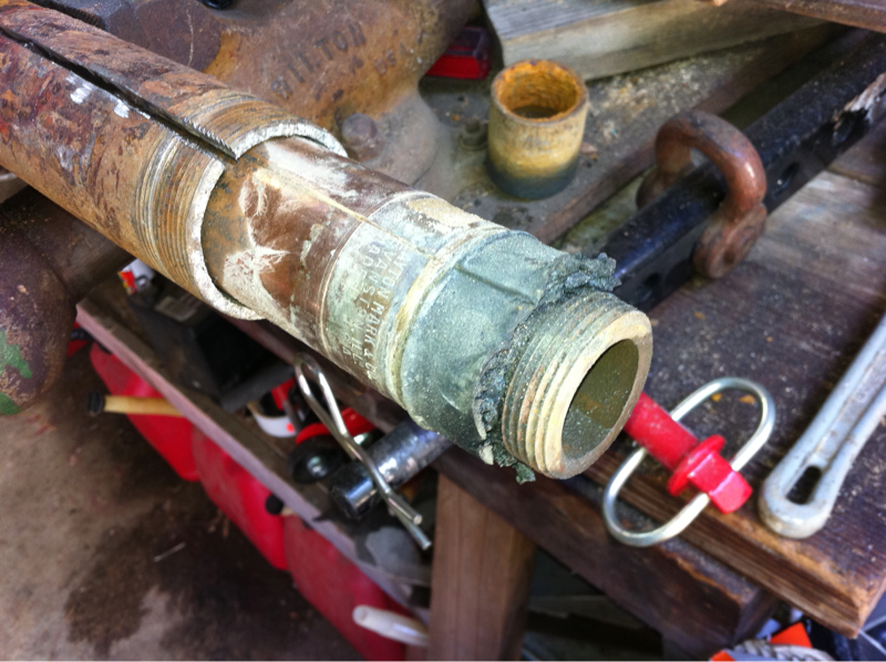

I ended up cutting the pipe into a few pieces so I could haul them out of the little pump room. I use a grinder with a cutting wheel to slice vertically down the last section of the pipe and splitting it open to pull out the old cylinder.
As you can see in the pictures, it was a brass cylinder with a check valve on the bottom. The whole thing was full of mud and scale from the pipe. I don't see how it could have worked for many years. The bottom of the check valve had a rubber gasket that was squeezed against the casing wall when the coupler was screwed up into it.
It was interesting taking all this old stuff apart. A real pain in the *** though. I haven't found anyone who has seen a setup like this one, with the cylinder set in the casing.
I think I'm going to try the 2" PVC route and use the five foot steel screened section and point at the bottom end. I feel pretty confident that I can get the casing down to twenty feet right away, I can run a line down into the hole that far. And I see water at twenty feet. The problem is how much water is there at that level, if I can drive it down to say, thirty feet. Am I going to be able to use a jet down to 25' ( the max) and not suck it dry before it has time to fill.
