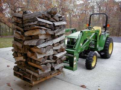

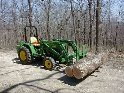

For a place to start, I'd recommend what I have, (Deere 4300), but for a little more beef, a Deere 4700 (larger frame and more hp). Hydrostatic, FEL, forks, 3 ph with 3rd SCV. Mine has served very well for over 10 years now.
I've not found many things the FEL won't lift, given there is adequate weight on the rear.
Other brands will serve you well too.
A pic to judge by:

A pic to judge by:
That's gotta be close to 1000lbs with those to logs.That set up would work for me.
