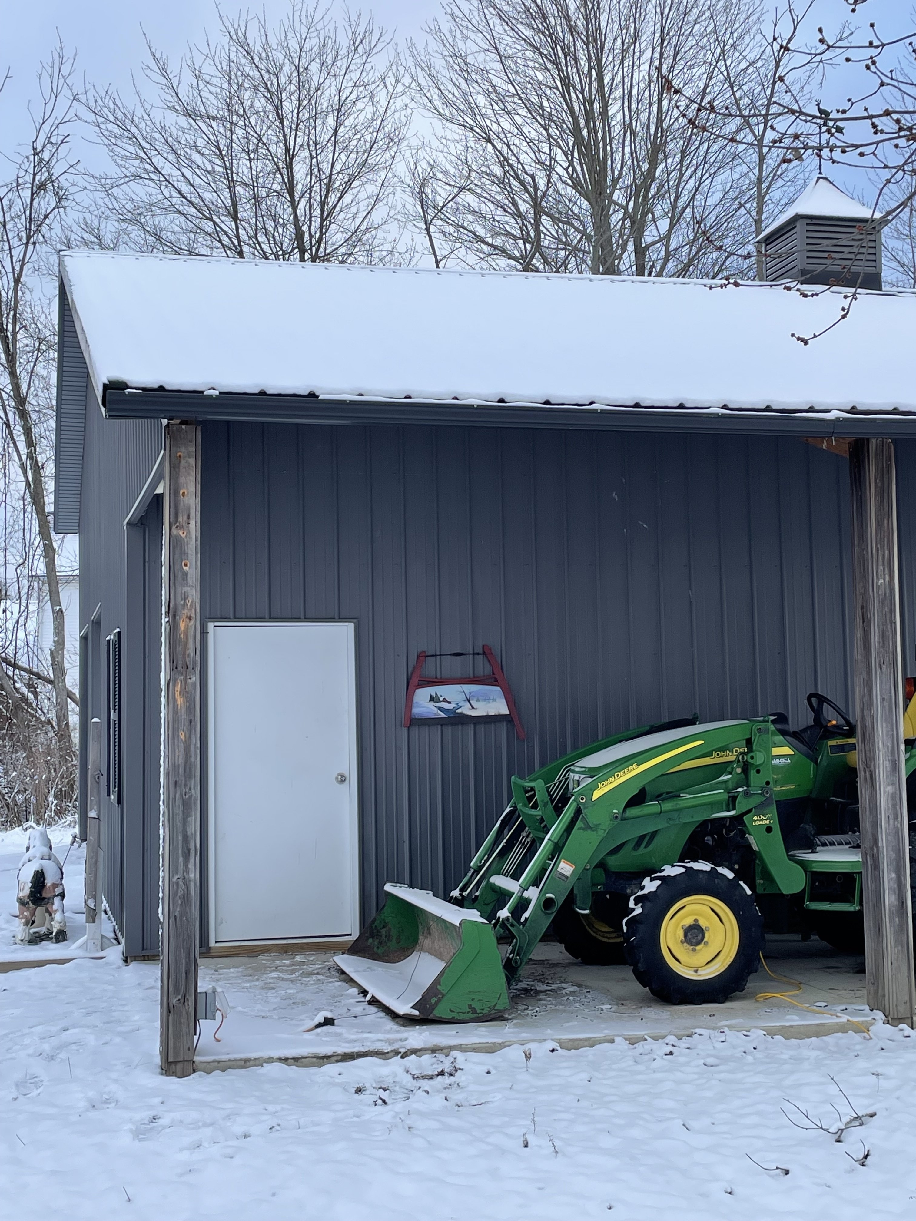

I’ve had pretty good service from the JD 4120, that I bought new in 2005. If you could find one of those, you’d be getting an American made JD Powertech engine rather than the foreign made Yanmars in the 30-20 series. The larger frame size would also be more on par with your old Fergy, and likely handle your other tasks much better. Also pre-emissions which is a big advantage on longevity and fuel economy.
The 4120 works great on snow with loaded rear R1 tires. I use a 7 ft rear blade on it for most of that, and push up the piles with the heavy duty bucket on the 400X loader.

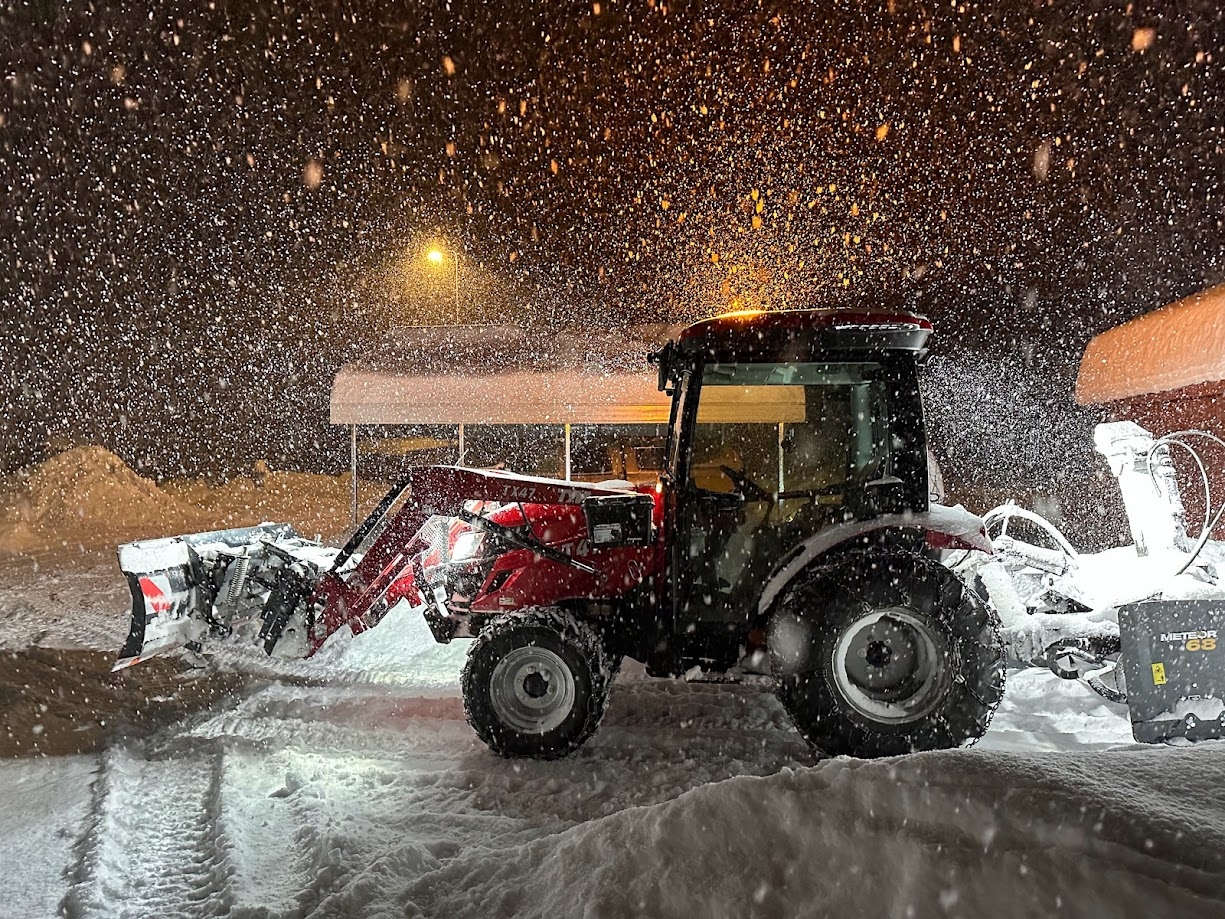

Yes I have a TYM T474 Cab HST with the mechanical injected engine that was made on license at one time from Cummins but made by Kukje/TYM Engine A2300N4. 560h without regen or any issue.
