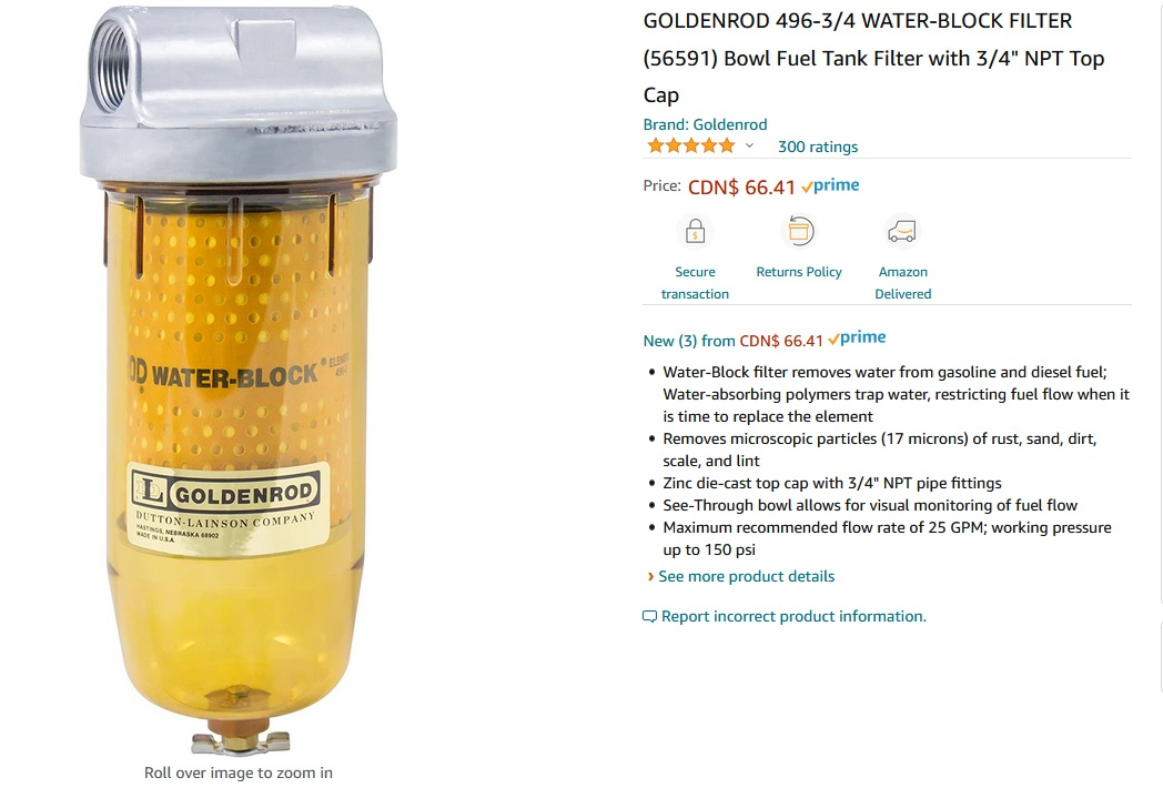

I find the key is first having a water block filter on the outlet of your bulk tank.
The second is before pumping fuel into your tractor, pump the fuel in the hose back into the bulk tank. This stops any condensation etc from entering the tractor system and in effect re-filters the fuel sitting in the bulk tank discharge hose.
My tractor is 9 years old and I have never had to change the tractor filter, never found any water in the tractor system
Dave M040
9 years on engine fuel filter is impressive !! When working on cranberry farm we had a black algae get in our tanks it was a hell of a mess !! It would plug up tank filters and machine filters lucky to get 250-300 we finally got it under control our filters weren’t as impressive as Goldenrod of course machines had water separator filters.Thx for info appreciate it 👍
