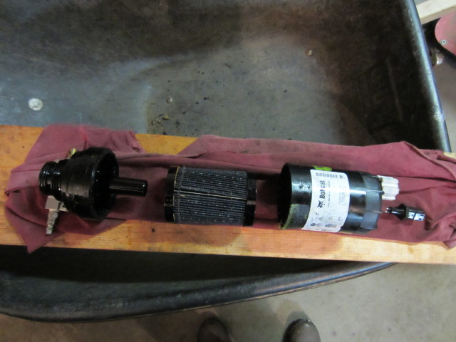

The late E85 bobcat machines take the same fuel filter as my Toolcat. The older ones had a 10 micron filter while the new ones are a 1 or 2 micron filter.....way finer. I cut my filter apart this winter when I changed it out (500hr).
