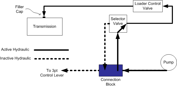

Hello!
The onboard hydraulic pump on my B7100 died last night. You can see a long crack just below the pump's equator in the following picture:
Some circumstances of the failure:
  1. This is the first time I've used the onboard hydraulics to power the loader.
  2. The transmission was filled about 50/50 with gear oil and UDT substitute from TSC.
  3. I was raising the empty bucket at the moment of failure.
  4. The transmission may have been overfilled.
Any idea what could cause such a failure? The tractor has less than 800 hours on it.
Here's a sketch of how I plumbed my hydraulic system for the loader:
Any clues about what might have gone wrong?
Can somebody recommend a favorite salvage yard where I can source a used pump?
Thanks very much.
/chris

I'm not an expert by any means but two questions come to my mind:
Does the loader valve an allow flow back to tank when it's in neutral?
Do you have a relief valve in the loader system?
/ Onboard Hydraulic Grenade
The loader valve causes fluid to flow back into the transmission at all times.
In neutral, it's just an open circuit.
When moving a cylinder, the drain from the other side of that cylinder goes back to the trans.
Yep, it's part of the loader valve.
/chris

Can you tell us some info about the history of the control valve? Is it new? Is the relief valve visible and intact? The pump housing fracture looks like what happens when there is NO relief valve functioning in the system. This can happen when the in and out ports are reversed at the control valve so the relief valve is beyond the load instead of before it. Everything would seem ok until oil was directed to a circuit that was at the end of its travel and couldn't move (dead headed). Then something would have to give - usually a hose blows, or the pump seals extrude out around the shaft - leaking oil into the engine, or maybe the pump housing burst from the pressure spike. As always, prompt cheerful refund if info is bogus. Good luck.
/ Onboard Hydraulic Grenade #10
I'm no expert but I'd have thought that bad or faulty plumbing would have blown a hose (or some other weak spot) before it would crack a casting. Are there any hoses between the pump and any obstructions?. If so, and the hoses are still intact, then it may be just a bad casting.
/ Onboard Hydraulic Grenade #11
After installing the new pump. Put a gage on the system to check relief valve setting. I would guess that old pump cracked from over pressure.
/ Onboard Hydraulic Grenade #12
being a hydraulic "expert", there must be a relief valve in the circuit. The failure is clearly a result of overpressure. You should plumb a relief valve directly to the output of the pump. The statement that the pump should stall the motor before any failure is just dead wrong. Just the mechanical inertia of the engine/trans will be able to generate momentary pressures well beyond the rating of any component in there.
You're lucky nothing else failed.
paul

Thanks everybody for the responses.
Larger versions of the pictures included can be found here.
Here is some more info around the issues you've all raised:
The loader control valve is not new. It's an ancient twin stick thing which was on the tractor when I bought it. I took it into a hydraulic shop to ask if it could be fitted for power beyond. The guy there told me that wouldn't be possible, and that the thing I was looking at was the relief valve. This is the best picture I've got of it, taken before I made any changes.
When I bought this tractor, the loader was plumbed to the hydraulic system on the PTO driven backhoe. The same selector valve I'm using now used to allow me to switch the backhoe PTO system between the backhoe and the loader. Here's a shot of that selector in its old home on the backhoe.
I'm beginning to become suspicious of the thing I belive is the relief valve. Prior to my re-plumbing efforts, when the loader reached the end of its travel I heard squealing from the backhoe. I presume that sound came from a relief valve on the backhoe. I don't know that I've ever heard the relief on the loader valve trip.
There's also the possibility that I've hooked the valve up backwards. I've got the right side of the valve (clearly visible in the picture above) receiving fluid from the pump via the selector. The other side of the valve is the one with the large hex thing sticking out of it, which I believe is the relief valve. Thinking about it now, I'm guessing that the relief valve (if that's indeed what it is) needs to be on the inlet side of the pump.
Okay, some more about what happened:
I did hear a sound when the pump failed. Not so much a "pop", more of a "clink" sound.
I'd just pushed a big pile of snow with the bucket, and was unable to back up due to lack of traction. I was simultaneously raising and tipping the bucket with the intention of lowering the fully tipped bucket to the ground, then curling it to push myself backward.
I'm pretty sure I was manipulating both sticks at the moment of failure.
The fluid flow at that point would have been:
  • Fluid from the pump was extending the lift cylinders
  • Fluid expelled from the the lift cylinders would have been extending my tip cylinders.
  • Fluid expelled from the tip cylinders was getting returned to the transmission.
There's no way that the lift cylinders reached the end of their travel, but the tip cylinders may have. If that's the case, and the relief valve was at the wrong end of things (or non-functioning), then I can see that I may have dead-headed the pump: The tip cylinders stopped accepting fluid from the lift cylinders, which would have stopped accepting fluid from the pump.
Sound reasonable?
I'll take some pictures of the loader valve tonight. I'll be seeking opinions about whether I've really got a relief valve integrated, which side is in and out, and how to test that the relief operates correctly.

It sounds like you may have hooked the loader valve up backwards.
The relief valve is always (far as I know) on the inlet side. If you hooked it up with the "IN" hose going to the "OUT" of the valve, then when you operate the controls, you are isolating the relief from the fluid. Any over pressure can't be relieved and the weak spot is located with much fan fare and excitement.
A second thought, your selector valve. If you operate the selector valve while the tractor is running, it may dead head the pump. Instantly killing it. Don't know if that is the case or not here. Just something to beware of.
Your hyd diagram does not include the BH circuit. There may be a relationship there, don't know for sure.
Also, I got the impression that you put the pump on replacing the function of a PTO pump. Did I read that right? If so, the fluid may be too thick for the pump. Check with the pump mfg to be sure. Over pressure situations can occur even with an operable relief valve if the viscosity is too high. Basically, the fluid can't get out the relief port fast enough to drop the pressure. Again, may not have a bearing on the case. But good to know.
There was a guy on here a while back with a ford BH loader. He had some of the same issues with blowing a new pump when plumbing hydraulics. It's easy to do, happens in a heartbeat and expensive as all get out.
Do try and document the entire set up you have. Folks here will chip in to try and get you up and running.
jb
