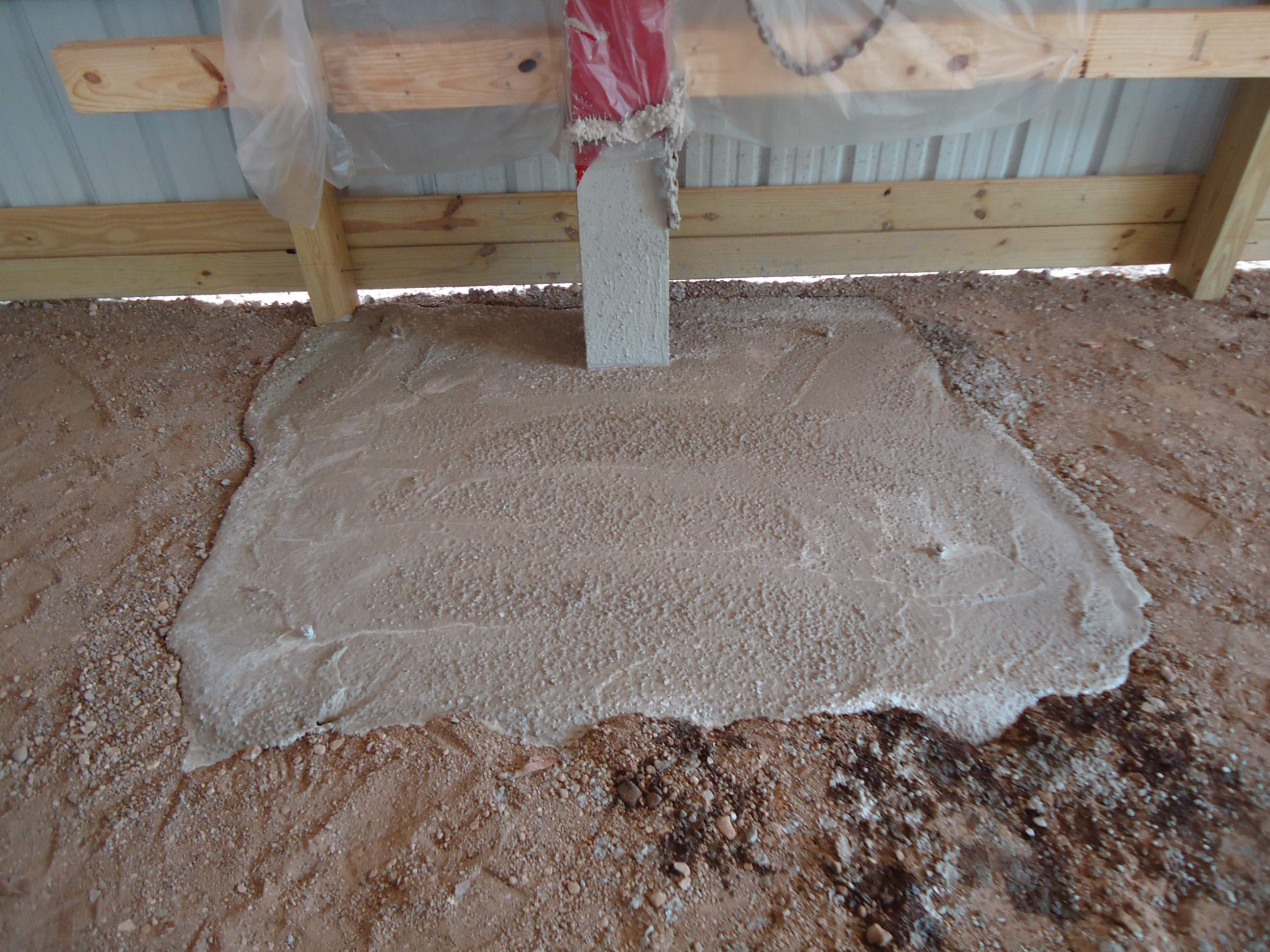

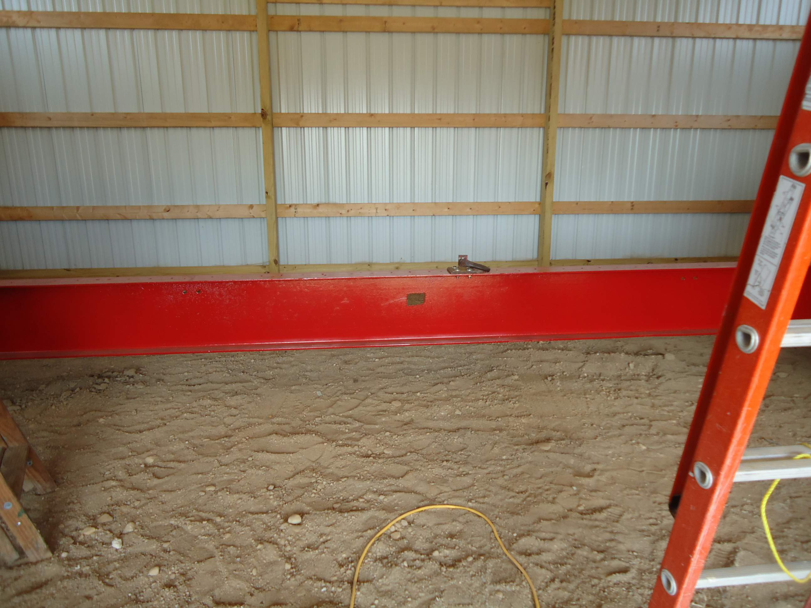

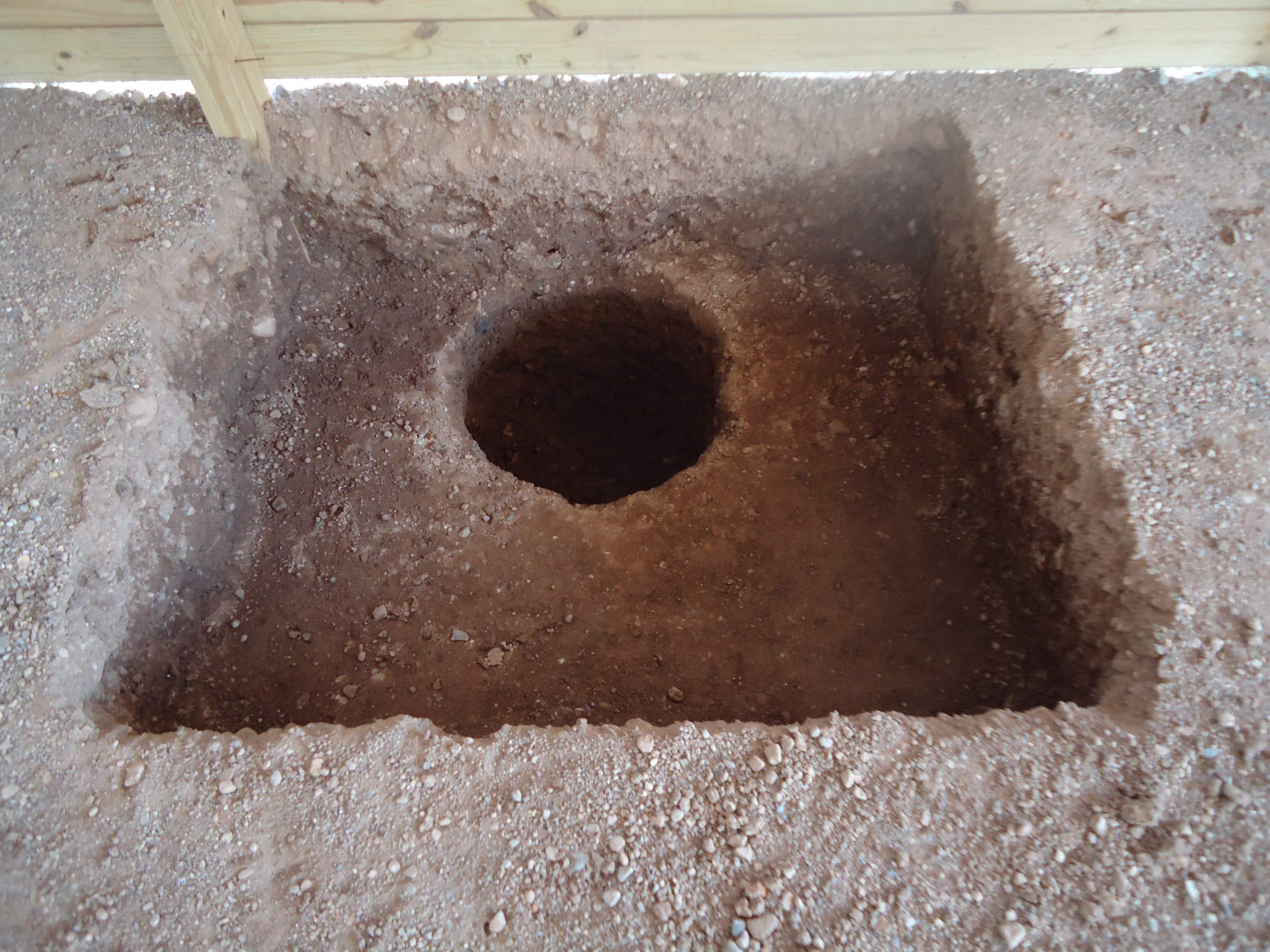

Beam uprights are of 1/2" X 8" H-beams. Cross beam is, I'm thinking close to 1/2" also, maybe 7/16" X 15" I-beam. Uprights are 4 feet-6 inches below the floor. I dug out a hole approx. 48" wide, and 36" towards the center. Poured up within 6" of the base material, then put 1/2" re-bar pins in to tie it into the floor. I also welded re-bar to the uprights, down in the anchor portion, so as to spread the stress. First shop picture is of when I was hoisting the cross beam up.

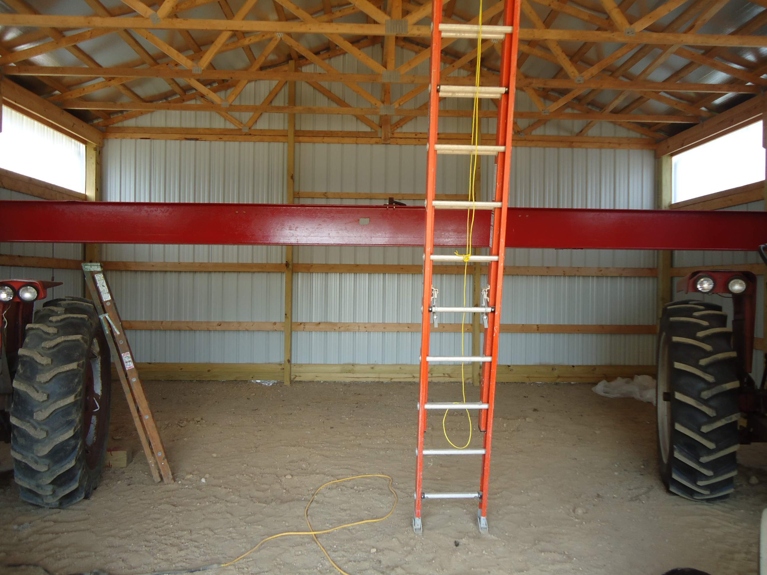

The beam is pretty handy. Made an array of lifting tabs to bolt onto things, then hook and pull. With 3 hoists on trolley's, pull a piece, and roll it over out of the way, and hook another. Had myself spoiled in the other shop, and decided I'd better put one up here. Well worth it to me...

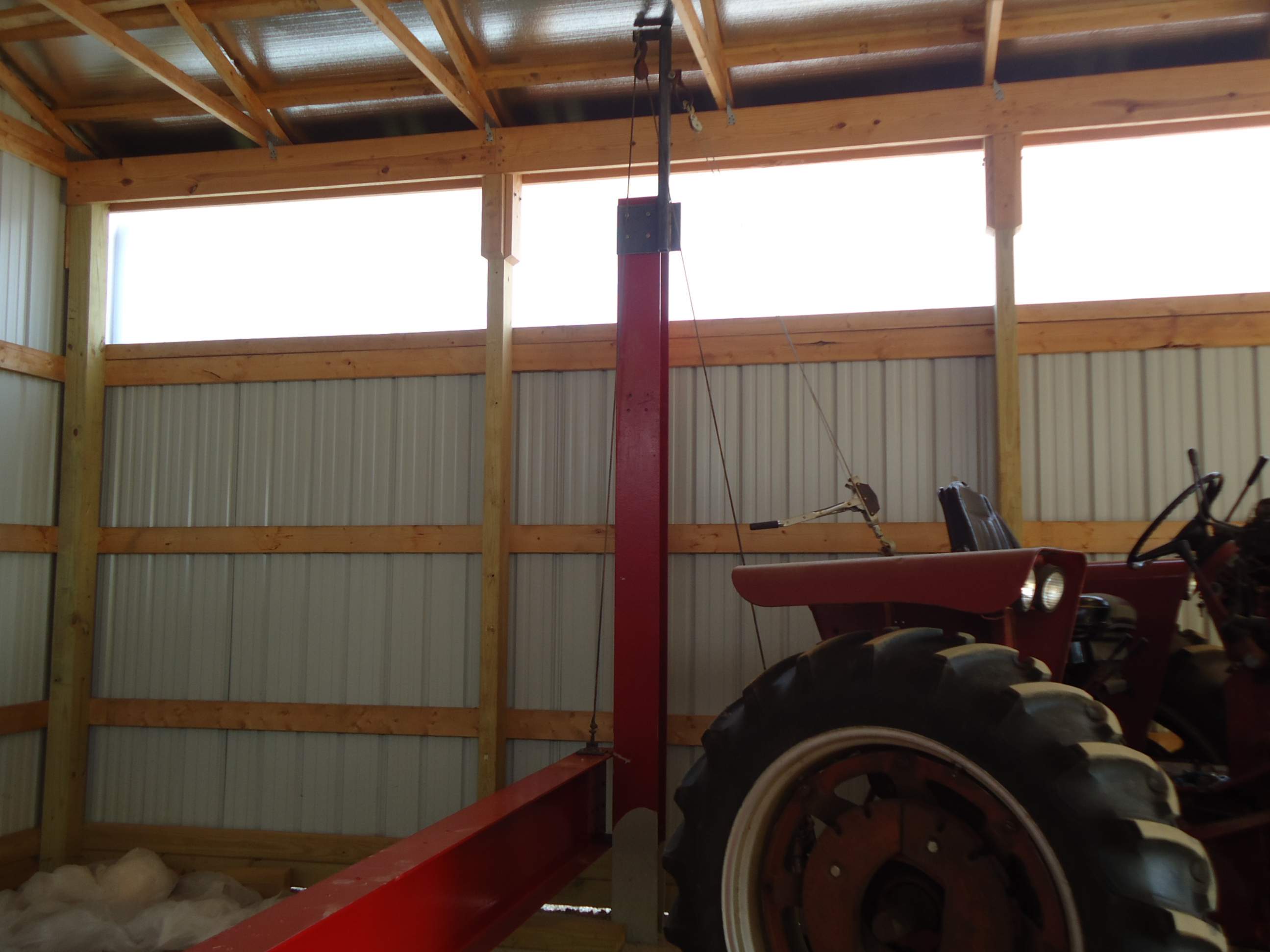

First, here's some pics of how I anchored the uprights. And one of the tab I used to carry the cross beam in with. Carried it in with the backhoe. Had a 1/2" rope tied to each end, and ran through the ROPS, so I could turn the beam to get it through the OH doorway,and behind the uprights. I wanted the beam behind the uprights, so when hoisting it up, I'd have some protection from it coming down on me. Shop I-Beam 007.jpgShop I-Beam 010.jpgShop I-Beam 003.jpg
   / One-point Spreader 1968 IH Farmall 140 #48
I had to do some fine measuring, as I allowed 2" down from the bottom of the truss, to the top of the beam. The metal I put on the ceiling stands 7/8" tall, and wanted a bit of extra room to put cloth on top of the beam when putting the metal up, so as not to scuff it, or get red paint on it.

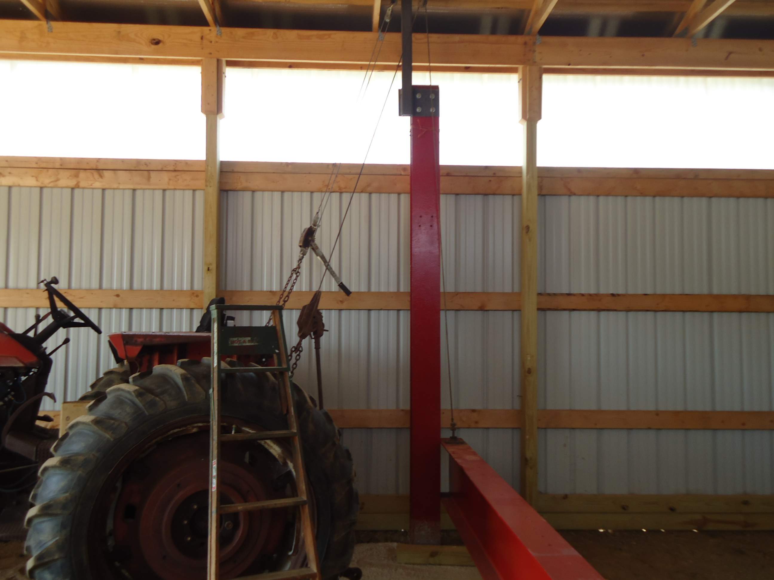

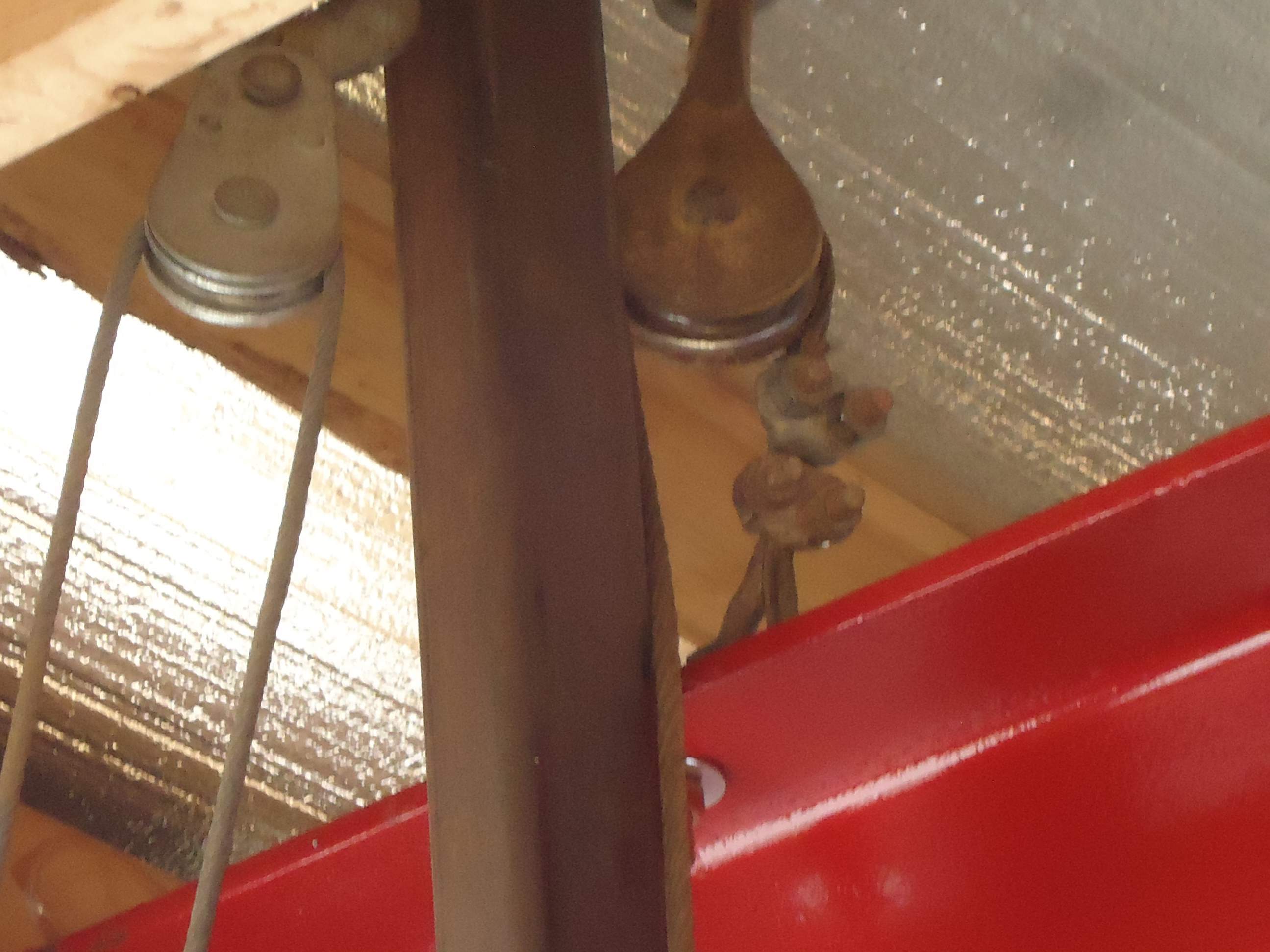

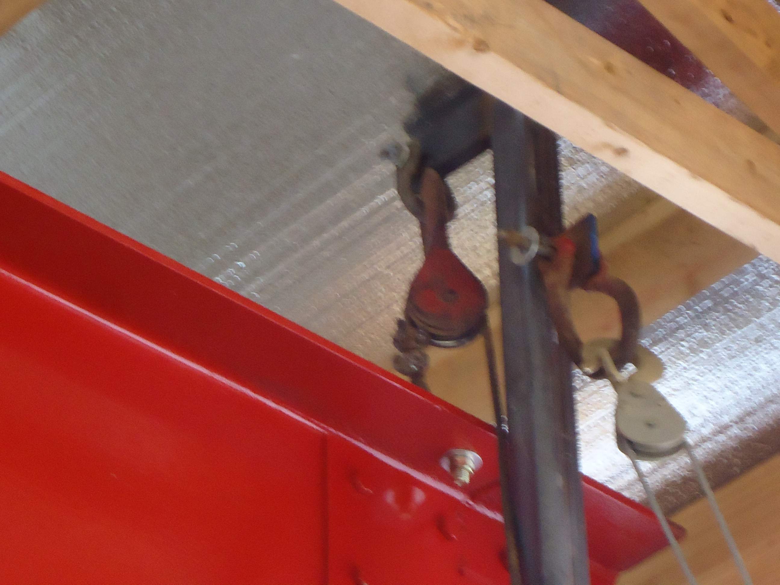

Pics of the jibs I made, and bolted to the top of the uprights to hoist it up. As you can see, I just did have enough room to be able to have the beam swing in place. I knew it was going to be close... I probably could have gone one more notch on the come-a-long if needed, but at the point where the cable clamps are against the snatch block pulley, it swung in place.
The holes in the plates the jibs are welded to were drilled before setting the uprights. Once up, I held the tubing up, and marked to weld, as high as I could get it. The top piece where the shackle hooked in had to be drilled to allow the hook on the snatch block to fit through. Removed the plate, then welded up the jib. Lots of calculating to make from that point, to the lift tab on the cross beam as short as possible. Ended up with a short upright tab with a 3/4" hole, and a cable thimble, just slipped through it. Just didn't want a sharp edge cutting the cable. And using a hook, would have made it too long.
Another tab mid-jib, to hook a smaller come-a-long onto, to take the side stress off while hoisting.
It actually took longer to set the rigging up, than it did to hoist it up. The one pic of the beam half way up is where I took a little smoke break to check things out. Almost seemed to be going too easy. From the first crank on the first come-a-long, until it swung in, and I let it down on the uprights was 45 minutes. I did it all myself, and just went like 6 notches on the HD 2 ton come-a-longs at a time.

Got the pics copied and saved. Is that tab some type of a clevis hook? I see how you have it bolted to the beam. Is that tab something you fabricated or a prebuilt? Looks sturdy.

Well, I've considered myself a "jack of all trades, master of only one or two," but your skill level is light years beyond mine. You done some detailed planning to do this as a one-man job. And it worked. Kudos. That's as fine a lookin set-up, actually the best, I've seen in a private garage; and I've been in dozens over the years. You got a real showpiece there. And it's more than super functional.
Am I seein double in that pic with the ext ladder? Are those twin tractors?
