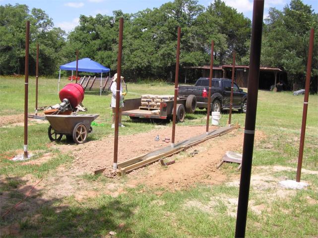

A cool 92 degrees in Texas and a nice day to pour our first beam. This is the most concrete that I have attempted to pour at one time ever, using 80 pound bags. The pour took one and a half hours, 19 bags and five mixers full of concrete. The beam is 8" at top and 10" at bottom and 10" thick.
This is our setup.
(Oh, when I say "our" or "we" it means wife and I. /forums/images/graemlins/smirk.gif)

One more mixer load to go....
The plywood on the 1"x1" (on the right) was used during the wheelbarrow pour so the concrete would not spill over the other side. It worked well.
(That metal thing in the background is the wife's project. We will get to that later in the thread.) /forums/images/graemlins/grin.gif

We then rounded the edges and smoothed the top.

I put in the bolts in for the doorway purlin connector.
Tomorrow we will pull the framing and see how we did on the 2"x2" ledge. /forums/images/graemlins/smile.gif
