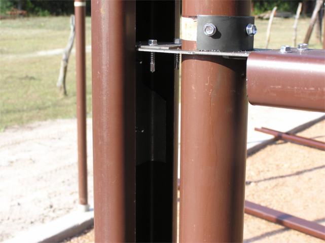

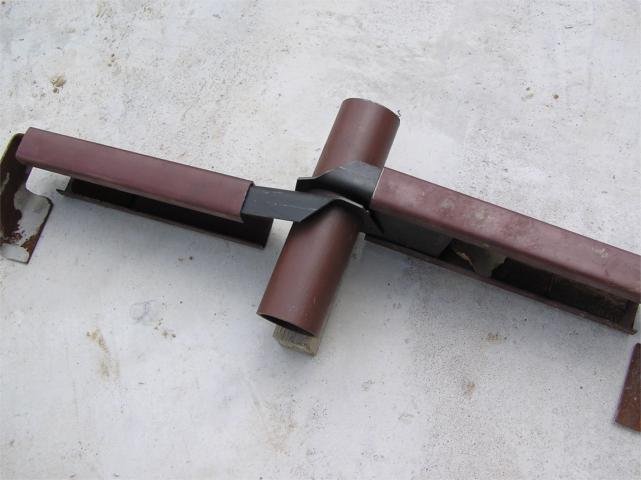

Harvey, I made this mock-up of the way I figured to cut the connectors on the pole side of the doorway. I just cut one set and will wait for your advise before I cut all six.
I cut a couple of inches off the "L" connector and cut a 1/2" off the "thru" connector. I also notched the "thru" connector. See attachments.

That looks good Don.
Remember when you lay out your door to allow some spacing for shimming the pre-hung door frame when you're plumbing it up.

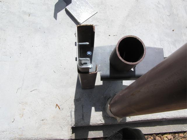

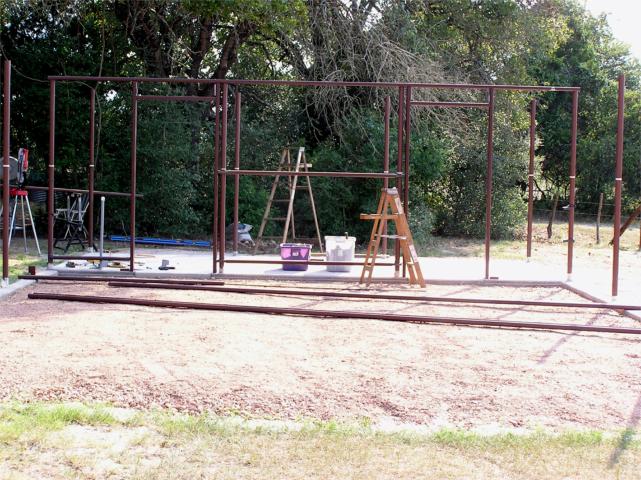

I have not died of heat exhaustion. However, I have found it incredibly hard to think when the temperature goes above 100. Yesterday I got an outdoor mist fan from Wall-mart that lowers the temperature down to 79 F when you stand in front of it. I'm moving slowly on the framing and am just about through with what I consider the hardest wall, the inside wall, because it has two framed doorways. I made it more difficult than it needed to be by putting the doors too close to the poles. I had to make Harveys brackets shorter to get the frame close to the pole so the threshold would fit the slab protrusion. This would not have been a problem if I would have put the doorway at least 8 inches from the pole. I also had to "stretch" two connectors because I put my cement bolts just a tad too far from the doorway. Next time I'll know better, I guess I'm getting experienced.

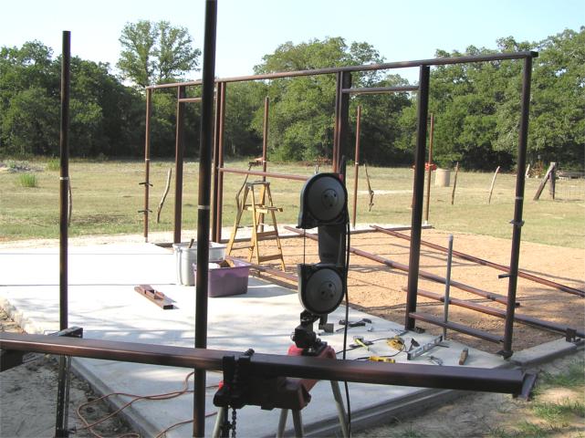

While Harvey's choice of saws for cutting the purlins was the chop-saw I prefer the portaband saw on a stand. (This saw was also great for cutting the poles.) The cut is clean, fast, less noisy, and there are no sparks. The clamp down chain holds the purlin secure while it is being cut.

Here are a few pictures I took today. If you can see where I need to put three more 3' horizontal purlins on the inside wall you are good and must be in a cool place.:D

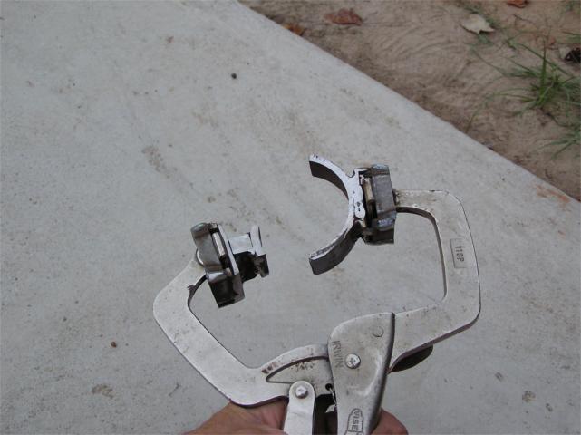

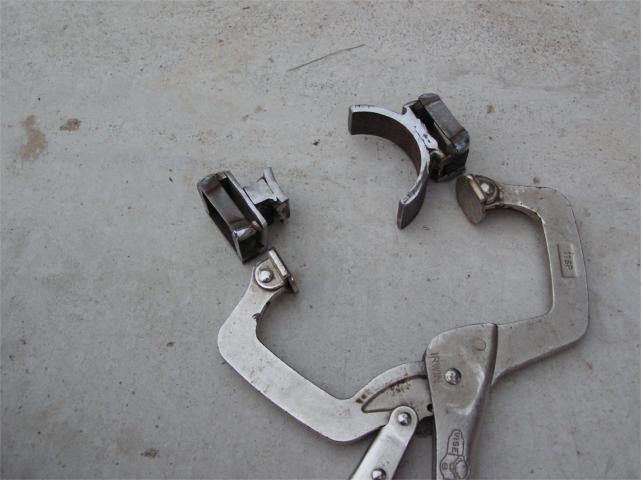

Harvey, when we were at Scott's, attaching connectors to the poles, Jinman was there to hold the connectors. I noticed in one of your pictures you used a vice-grip tool you made to hold the connectors while you attached them to the poles.
I decided to make a slip-on attachment to my vise-grips that would securely hold the connector's tab to the pole and be out of the way of the drill and screws. They would have to be adjusted easy to level and square the connectors. If that did not work I was going to weld-up on my new vice-grips but they work great.
I guess The connectors carry some of your LUCK with them!
Here are a couple of pictures of the vice-grip slip-ons.

Don, those look great. I think you should call them "Jimfingers".
Your having more fun than you carport is going to be able to store. Keep the pictures coming. I'm enjoying your progress.
James
