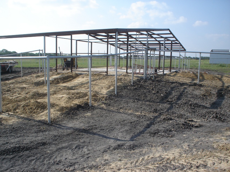

I decided it was time to get back to work after having to rescue my equipment twice in one day. The first was when my trail mower (Farmall A) got too close to the edge of the dam and then along with some big ant beds and the inability to hold the line I quickly shut her down before the point of no return. The next was just a stuck golf cart in the sand on the bank of a pond I had opened up to let the spring flow. (See Rescueme Collage).

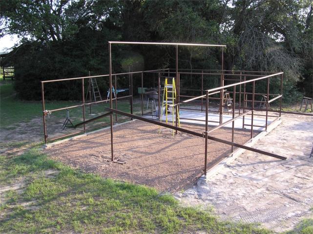

On the building I started by making tree stands and cradles on the metal I had Left over. This will serve to temporarily hold the ridge beam while I construct the rafters. The height of the ridge beam from the top plate is 51 inches. This is a bit taller than originally planned but it looks good.

That's a heckuva pitch Don for central Texas. ;>)
In other parts of TBN land I'm sure it's not much but in the southland, but it will look good.
There will be 3 purlins, one at the top one midway and one at the wall.
The rafters will be made by attaching at the midway to lower part with a purlin and "V" purlin supports.
Are 3 purlins longways connecting the rafters sufficient?
One purlin will be running on top of the top plate. Another purlin will be running about eight to ten inches from the peak. That leaves you about five feet between purlins if you run in between the two purlins.
Even with that steep of a pitch I'd have concerns about where to place my feet when walking on the roof. And it is much easier to install the roof sheets from on top. So I recommend one more purlin. That would leave you thirty nine to forty inches between purlins. You would be plenty comfortable walking on the roof.
Should there be a purlin attaching the front poles, or will the first rafter be sufficient?
What height should the ridge pole be above the top of the wall?
The end rafters should have purlins attached at a right angle for the end sheets. So your end rafters will be four inches inside the outside wall line.

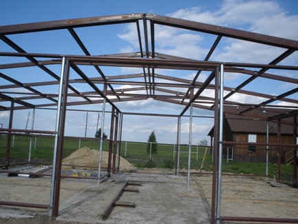

Here's a picture of the end rafter assembly that we used at the horse barn.
Using the right angle brackets we added supports from the top plate to the rafters on the ends.

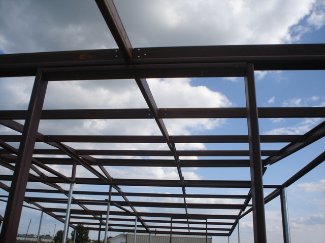

Here's a picture of what I'm talking about Eddie. There's a purlin on each side of the peak.

If you look at the above posted picture you will notice the pipe runs length of the peak. The pipe holds the brackets which accept purlins as rafters to the top plate. No figuring pitch except for ridge cap. The pitch is decided by the location of the pipe. That pipe or combination of pipes, or ridges if you will, determine the pitch.

I recommend Don put a purlin eight to ten inches down from the peak on each side. This gives more metal and framing for attaching the roofing sheet and the ridge cap.

If you look at this picture you will see I use a piece of purlin as a brace between the rafters. This reinforces the truss principles of the rafter system using the brackets.

Eddie, I was baffled when you said that the rafters would be harder to build in the air. I'm glad Harvey explained it to you. It is so simple. This will be my first gabled roof, so I really do not know what I'm doing, but it is doing well. The simple roof framing is what attracted me to this method of building. There are no angles to figure and all cuts are right angles. One good metal saw, one drill, one person 95% of the time is all that is needed. All of the structure members are easy to carry. Since I have never skinned or trimmed a metal building I keep trying to figure out the unknown steps ahead. I'm depending on Harvey to guide me through the steps. It is kind of like a puzzle; every piece of steel that goes up defines the building a bit more.
Harvey I'm trying to figure out the end gable. I saw the picture and saw the open side out, 4" from the end, and the purlin at a right angle. Do you have a picture of how the right angle purlin is attached too the end rafter? I was thinking it is just screwed in and resting on the inside lip. Is that correct?
   / Only in Texas, Don and Harv doing
#280
Ideally Don the end rafter will be lined up with the inside of the top plate. That will enable you to screw through the rafter into a purlin that lines up with the wall framing. Then if you want you can put in a couple of vertical supports from the top plate to the gable purlin attached to the rafter.
