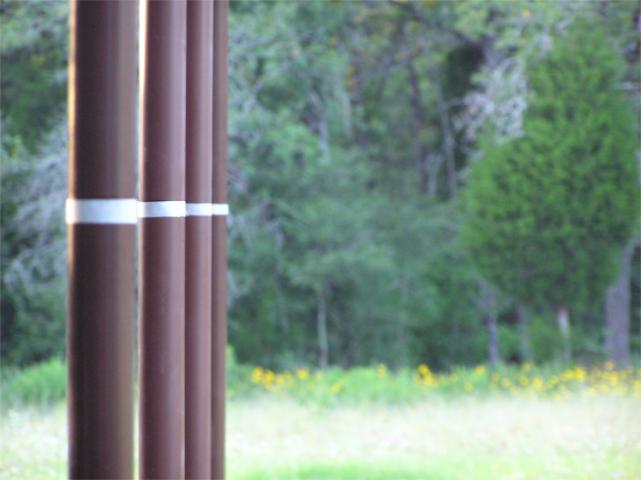

Thanks Jim. There are eighty bags of sacrete hidden under those poles.
With the poles up I can think of no reason to keep the batter boards up so I have taken them down. Everything gets lined up on the poles now.
The reference line has been marked on the poles with a laser level. I put masking tape on the lines so they would show up in the picture.
The concrete level has been marked on the poles and the foundation and beam framing wood and re-barb has been delivered.
Mikem has delivered a cattlegaurd which will be used about 40 feet in front of the carport (no more gap to open).
Harvey, any tips on framing the beams and slab? /forums/images/graemlins/smile.gif

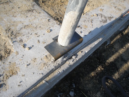

Morning Don,
I was up until ten thirty last night repairing the factory class three receiver hitch on my son in laws K3500. And I'm running late this morning.
Maybe this picture will help you until tonight when I can find the pictures of the framing etc.
