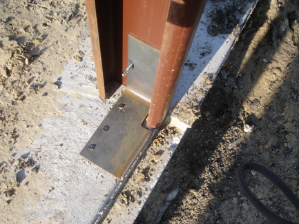

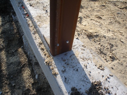

One of the things I like to do is have a shelf for the sheet metal. This helps prevent water coming through the wall during a heavy storm. It also makes it easier to block off insect access.
This is one of the doorways to a stall. As you can see the shelf ends where the doorway will start. I use the regular bracket for attaching the door jam to the concrete. I just use a powder actuated fastener, here, three powder accuated fasteners.

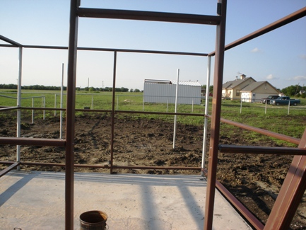

Here's what it looks like from inside the doorway.

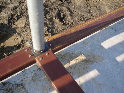

This is the way a three way connection looks. Say like when Don's interior wall attaches to the side walls.

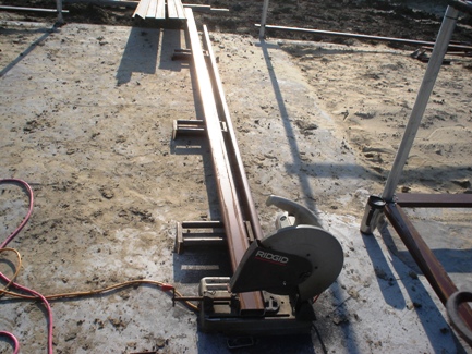

I don't like chop saws. I don't like the sparks nor I do I appreciate the noise. But on a job like this it's the best tool for cutting the framing quickly and easily.
Those rollers are tek screwed to the purlin to hold them in place.
It's a pretty good system.

Harvey, when using the powder nailer on the door brackets did you drill holes in the bracket or shoot through the bracket? Also what loads and lengh of nails did you use?
Thanks
James

I used a single shot Remington. I don't use them enough to need a fancy one like a Hilti or Ramset.
I used the green load and one inch concrete or steel nails.
I pre-drilled the plates. I tried it without pre-drilling and I'd have needed a stronger load to get a good seat. I didn't feel like walking back to the truck. /forums/images/graemlins/blush.gif
One of the more interesting experiences I've had with the powder actuated anchors involved trying to attach eighth of an inch thick aluminum sheeting to a half inch thick steel lintel. I couldn't get a good anchor in until I pre-drilled the aluminum. Then I got perfect penetration into the steel.
I guess the soft aluminum absorbed enough of the energy from the charge that it sabotaged the penetration of the steel.
