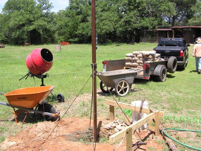

Eddie, I laser leveled each post to be sure they were all above the 8' mark. I guess I should have made them above the 8'4" mark to leave room for the slab. We also have some extra room on the slab because the metal will come lower on the side of the slab and rest on a ledge.
Also, as you were saying, the outside metal can be cut to any length when ordered. I am working in-between rain showers and only have 5 poles level and in cement.
Attached is my set-up for installing the poles. I open the bags and put them in the gray cart then I shovel the cement into the mixer to the right consistency then pour it in orange wheelbarrow then into the hole. The re-barb/pipe stabilizers help make this a one man job. It takes about two cement mixers full to fill each hole which is about 5 bags.

</font><font color="blue" class="small">( re-barb/pipe stabilizers )</font>
I don't believe I've seen that before, Don; pretty neat idea.

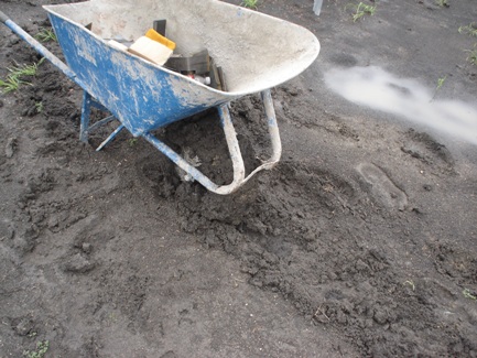

Don I shut down yesterday after lunch because the mud had made it too difficult for an old man. I've found I'm not near as agile and hearty when my tail is tucked between my legs.
I tried using the wheelbarrow to get the tools and brakets to the new barn from the old barn.
I got about half way.

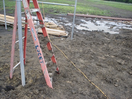

I left the wheel barrow where it sits. I did turn it upside down so if we did have another storm it would hopefully wash the mud off the wheel.
It's one of those situations where mud is on everything. That includes throwing the GFI circuit often. It seems mud is a conductor of electricity as well as misery. /forums/images/graemlins/grin.gif
Check out the rungs on the ladder.

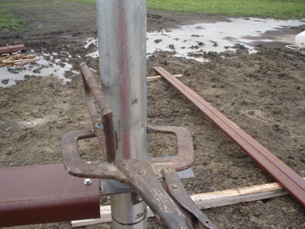

Here's the tool I made to help install the brackets correctly. I still need to fine tune it but it helps a lot as it is.

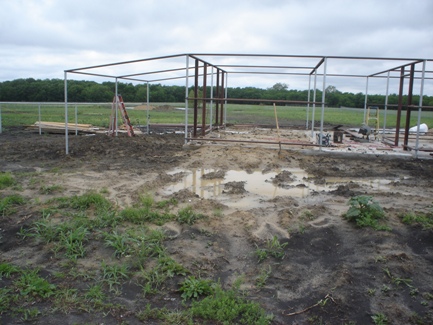

This horse barn will have a 1 1/2 to 12 pitch.
Mud everywhere. /forums/images/graemlins/frown.gif
I know we need the rain, but mud? /forums/images/graemlins/blush.gif

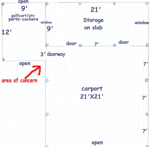

After Harvey and I drew up the basic design I added the golf cart/ATV porte-cochere. This will be where the golf cart will recharge during the night.
Harvey I have a question? See Attachment.
Do I need to put in another pole at the front corner of the porte-cochere and the carport. The 3' door way will not have a door it will only be an opening. I have an extra pole. Another Idea is to add a cement threshold and shoot in a bracket. I haven't cemented in the middle poles on that side so another idea is to move the poles on that side to 9', 9',3' but that might interfere with the rafters since the other side is 7', 7', 7'.
Another concern is: Do I have enough connectors with this addition.
I like your clamp! /forums/images/graemlins/smile.gif
The pole holders were Karen's idea - a larger diameter pipe, cut in half, with a strip of foam inside, (so it won't scratch up her paint job or slip) and a re-barb angled welded to it. /forums/images/graemlins/laugh.gif
