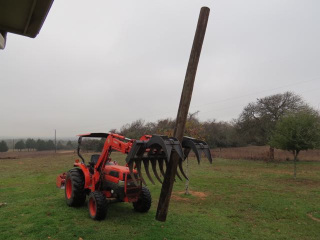

I was going to used my BX24 to raise and set them in the hole.
Here is a pic of a 14' post on a 5030 chained to a grapple for stability to ponder if you BX is up to the job.

Good.points on limiting your liability. Do whatever is necessary with the school board to assure that.
Regarding construction, I think you need to see if there is another dad or two to help, at least with the.poles. I think 2 or 3 guys and a BX can get it done. Consider nailing a 2x4 across the post about in the middle. A guy on each side with loader and chain up higher to get it in the air.

A BX won't think twice about standing up a 16' pole. Put a flat board at the back of the hole and the tip of it on top of the hole, lift the BX bucket up a few feet, lift the end of the 6x6 up and put it on, and drive forward all while raising the loader. A simple loop of chain loosely around it to keep it on the bucket if necessary. This is how I stood up my 35' steel pole.
