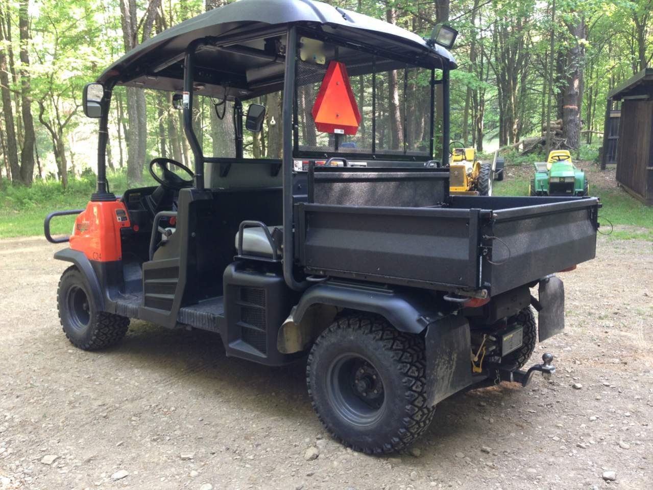

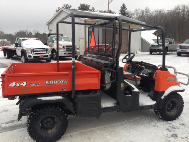

We bought our first piece of diesel equipment, our first Kubota, early this year. Previously owned a Kawasaki Mule 2510 and still own a John Deere Gator 6x4. Our Kubota RTV1140 is awesome! I have really come to like the Kubota products. Our RTV is a 2009, and we have put about 45 hours on it since purchasing it in late January 2014. It is very well built, rides quite well (better than the Mule ever did), has plenty of power and extremely versatile. The RTV does take some getting used to when it comes to operating the transmission (starting, stoping, shifting), but once you get the feel for it, it is leaps and bounds over the belt drive systems in most all other UTV's. The RTV acceleration and deceleration is so smooth compared to our Gator. When it is time to replace the Gator, we will most likely go with another [used - cheaper] RTV (perhaps a 900 - two 1140's might be a bit much). Here is our RTV upon purchase and after sprucing it up a bit:

We bought our first piece of diesel equipment, our first Kubota, early this year. Previously owned a Kawasaki Mule 2510 and still own a John Deere Gator 6x4. Our Kubota RTV1140 is awesome! I have really come to like the Kubota products. Our RTV is a 2009, and we have put about 45 hours on it since purchasing it in late January. It is very well built, rides quite well (better than the Mule ever did), has plenty of power and extremely versatile. The RTV does take some getting used to when it comes to operating the transmission (starting, stoping, shifting), but once you get the feel for it, it is leaps and bounds over the belt drive systems in most all other UTV's. The RTV acceleration and deceleration is so smooth compared to our Gator. When it is time to replace the Gator, we will most likely go with another [used - cheaper] RTV (perhaps a 900 - two 1140's might be a bit much). Here is our RTV upon purchase and after sprucing it up a bit:
View attachment 384631View attachment 384630
