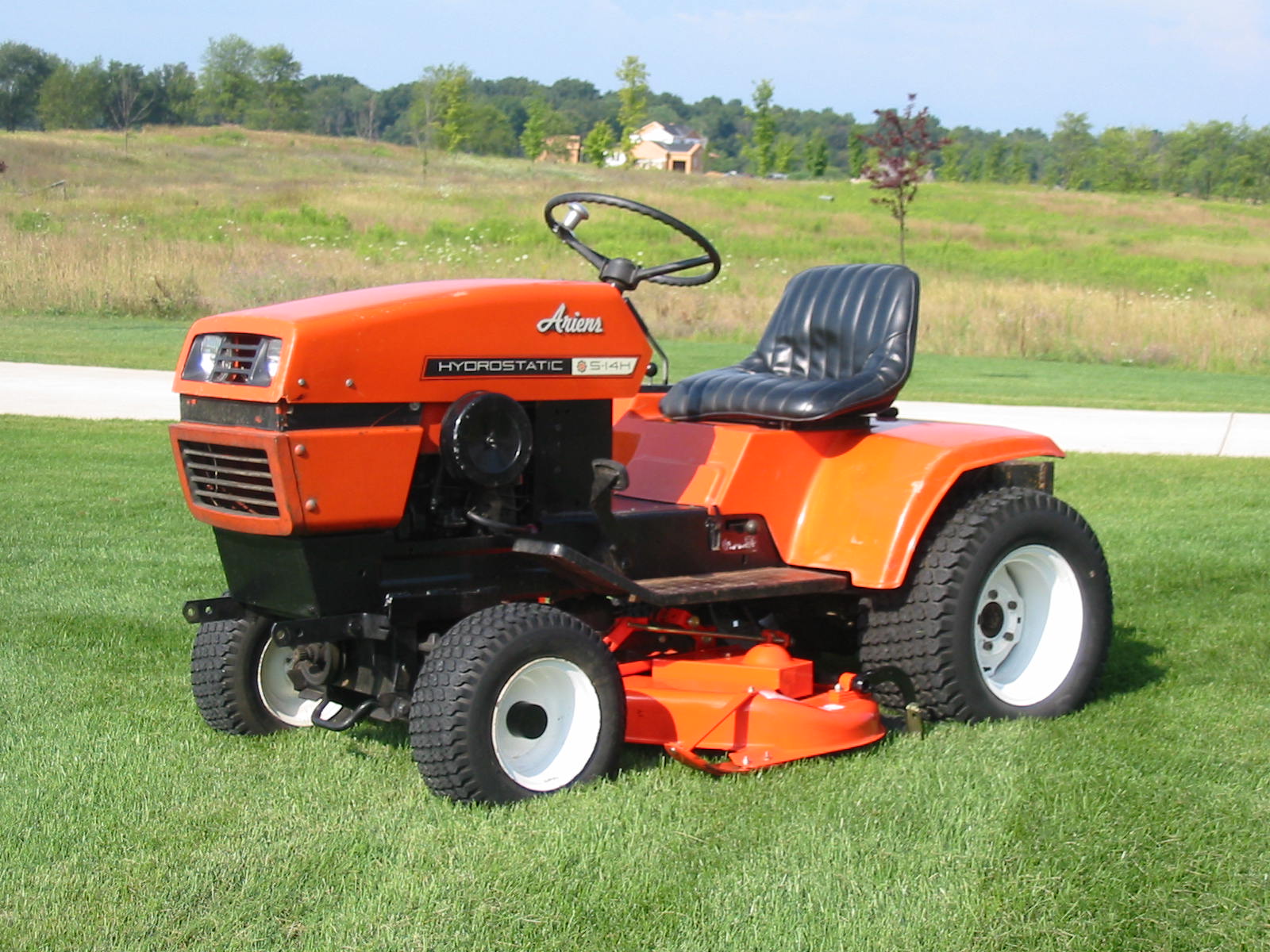

I use an old Case 446 18 HP gasser to blow snow here in a snowy part of Ontario and it does the job quite nicely.
It's the craziest thing, but I swear my 30 year old 14HP ariens would handle its 48" front blower much more easily than the Kubota would handle its 51 incher. I have no idea why this is.
KB
