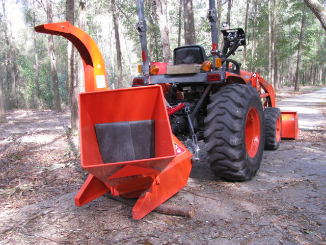

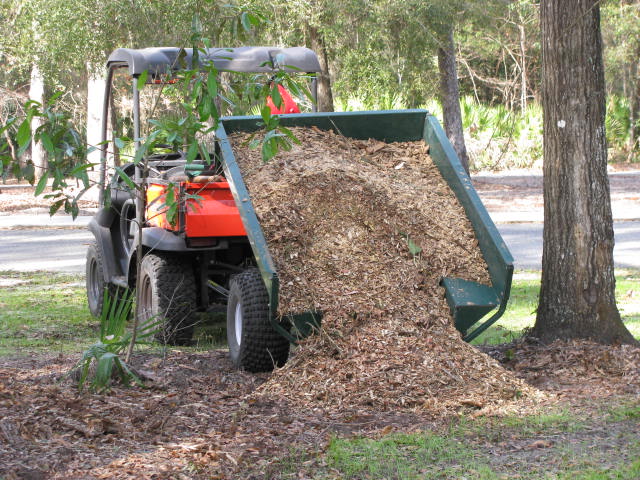

A bit pricey but Wallenstein is the PTO powered chipper or chipper/shredder of choice.
I bought my BX42s from Iowa Farm Supply.
Simple design, heavy steel, great build quality, trouble-free.
There is a Wallenstein distributor in Pennsylvania that has had excellent reviews on T-B-N.

Every piece of gear requires some kind of maintenance/repair.
Do not complicate your life with a SMALL chipper, just burn small amounts of debris.
With a larger, heavier chipper you can be efficient and create enough chips to mulch.
I had a 13-hp stand-alone gasoline powered chipper/shredder and it frustrated me no end.
The Wallenstein PTO chipper is trouble free and really produces chips.
"Light duty" and "tractor" do not usually co-exist very well nor very long.
