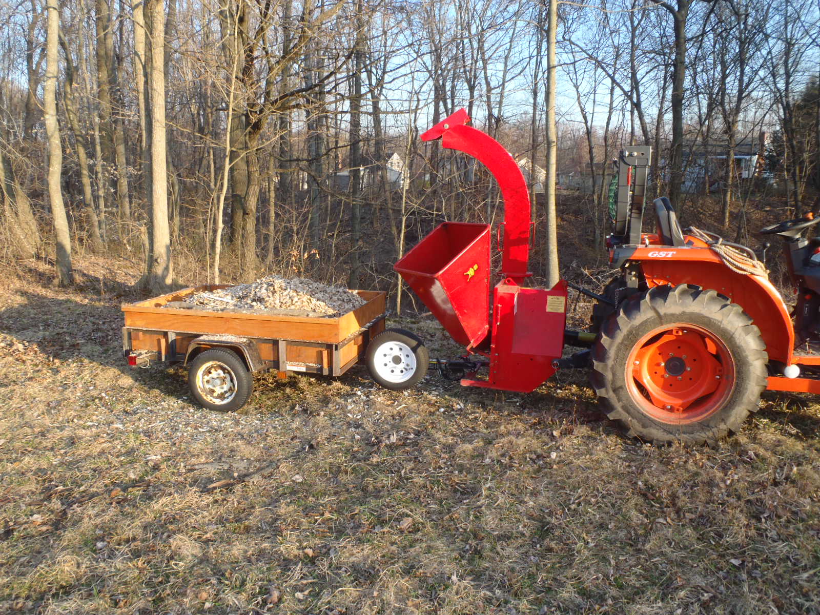

I have the chipper pictured in the OP
'Use it with the Hurlimann, 35hp.
I run at about 1800 engine rpms with the 1000 rpm pto , so call it "reduced HP"
With sharp knives, anything that fits in the chute is self feeding. at times a bit agressive.
The shredder is very useful for gardening needs and does a good job of putting out uniform chip sizes.
Since I burn wood for winter heat, anything bigger than about two inches gets stacked. "Limb wood is the best wood"
Though I have no great amount of material to be chipped at any given time, I likely process three 100 foot tall maples or hemlecks a year.
Yesterday I ran the shredder for a few hours "re shredding" the chip pile to have material on hand for next years gardening. About 6 yards, processed. With the rotted chips wet from recent rains, I had trouble with clogs. Took too much time to do too little.
If you just want to "chip it and forget it" a dedicated chipper might be a good choice, if not for the big $$. I paid $800 for this one, pretty much as new.
I quit with the brush pile burns.. What a mess! The gardens are doing better than ever!
cheers from VT
Cal

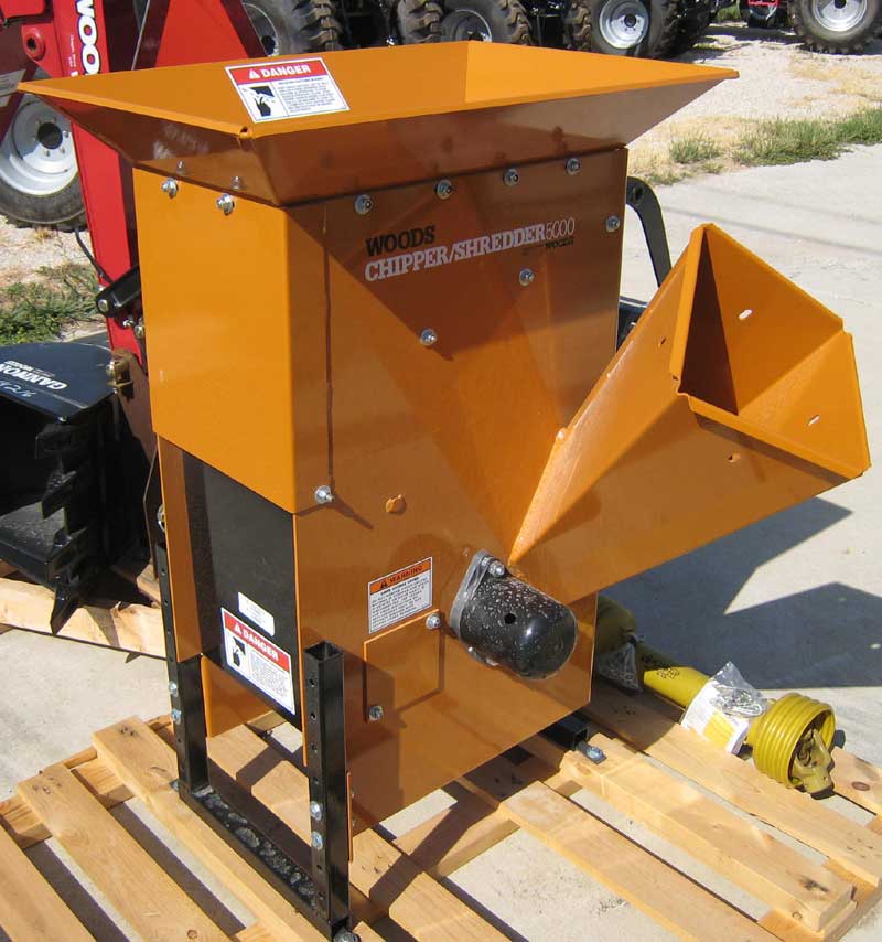

Material is assorted landscape waste/trimmings and various tree branches not worth using as firewood. Leaves. Have a lot of vine waste from clearing/cleaning, but that should go away soon.
Based upon your description of your needs, I suggest a chipper/shredder would be a better option.
Dedicated chippers do great with branches, small trunks and such. They don't do well with leafy yard debris, twigs and such. This is where the chipper/shredder excels.
My chipper/shredder, purchased used for $1000.00, is a Woods 5000. This unit requires 15 PTO HP minimum up to (recommended) 40 PTO HP maximum. It handles branches, limbs and trunks up to 5" diameter (but they need to be pretty straight). The shredder...wow! Great for those leafy tops, small pine branches and that type of stuff...all the typical rural residential or small farm yard cleanup.
As you can see, there's no blower chute and the chipper chute is gravity feed (at a 45-50 degree angle from the horizontal). A blower woould be nice...gotta admit that, But I'm not going to spend as much for the blower option as I paid for the chipper/shredder...definitely not for an implement that gets used 4-5 times a year.
But I do recommend this machine 100%.
By the way, the Woods 5000 is manufactured by Crary Bearcat and sold by them as well. I don't recall their model number.

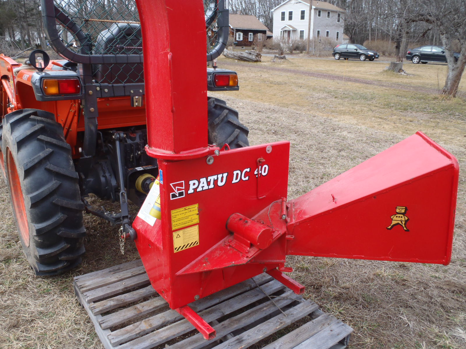

I have an old PTO driven Patu 4". No longer made and if I had to replace it, I'd go with the BX42 for the 4x10" infeed, which would greatly reduce the need to trim branches before chipping. 3 other things to look for in a PTO chipper:
1) Heavy flywheel - more inertia reduces shock loads to your tractor's gearbox.
2) Rotatable chute - lets you put the chips where you want them - like directly into a trailer. Much less work.
3) Low infeed chute - the bottom of the Patu's chute is parallel with the ground, so if you can drag a limb up to the chute, you can chip it without having to lift the whole thing off the ground. This really helps when there are a lot of "Klingons": vines, leaves other branches, even tall grass or brush that you have to drag the limb thru. All that stuff saps your strength after a time and fatigue is the handmaiden of industrial accidents.
Being able to get the tree work done during the few hours of time that I'm not at the office and it's not dark or raining is worth a lot to me and this chipper has been a great investment - no regrets.
