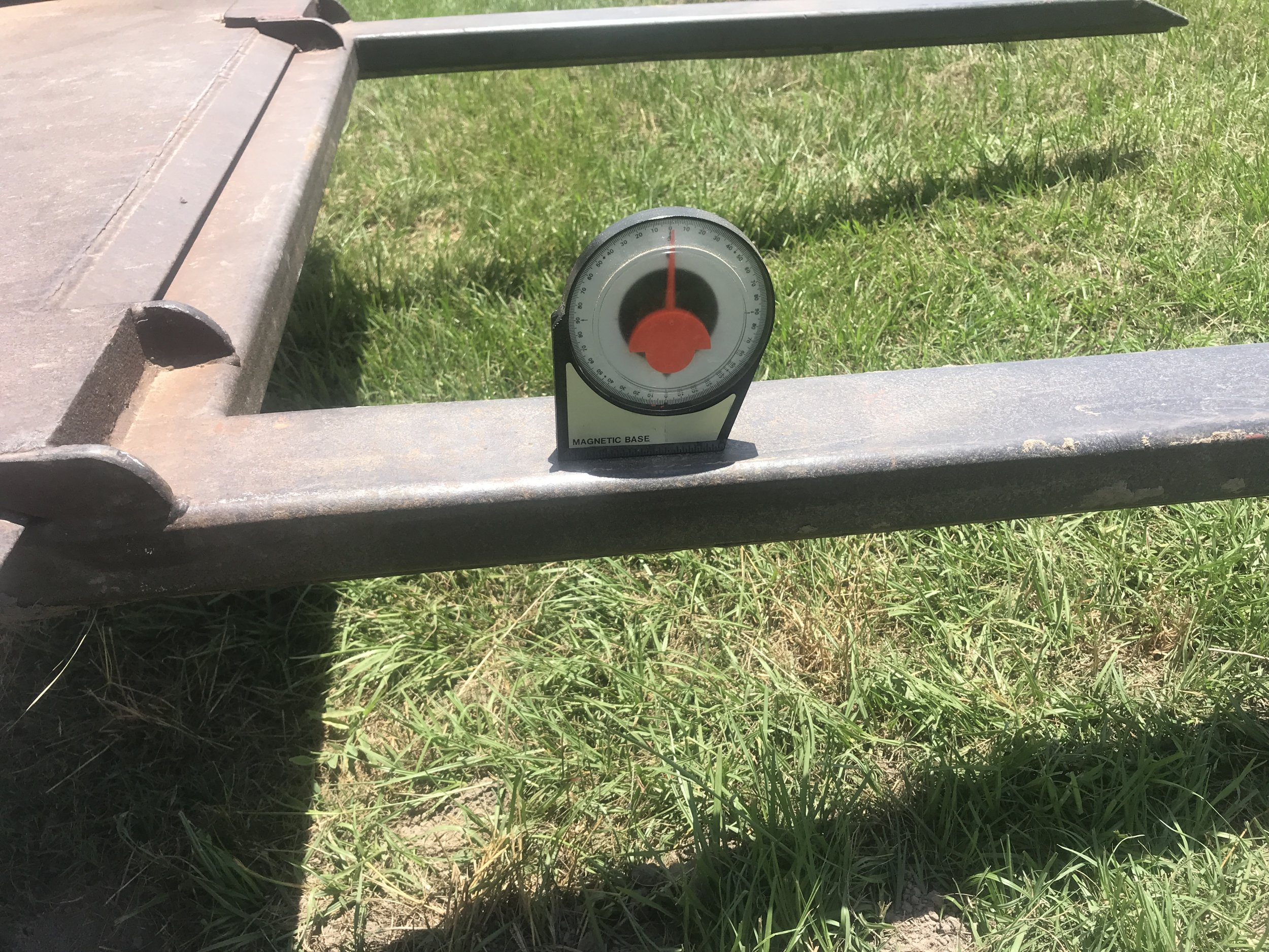

I have used straight forks. They are good for penetrating a pile of brush, but I am bad about digging them into the ground while trying to get under the pile. I've bent some lighter duty forks doing that.
Bucket level indicator helps a bunch to keep tines from pointing down to much in front and digging in...

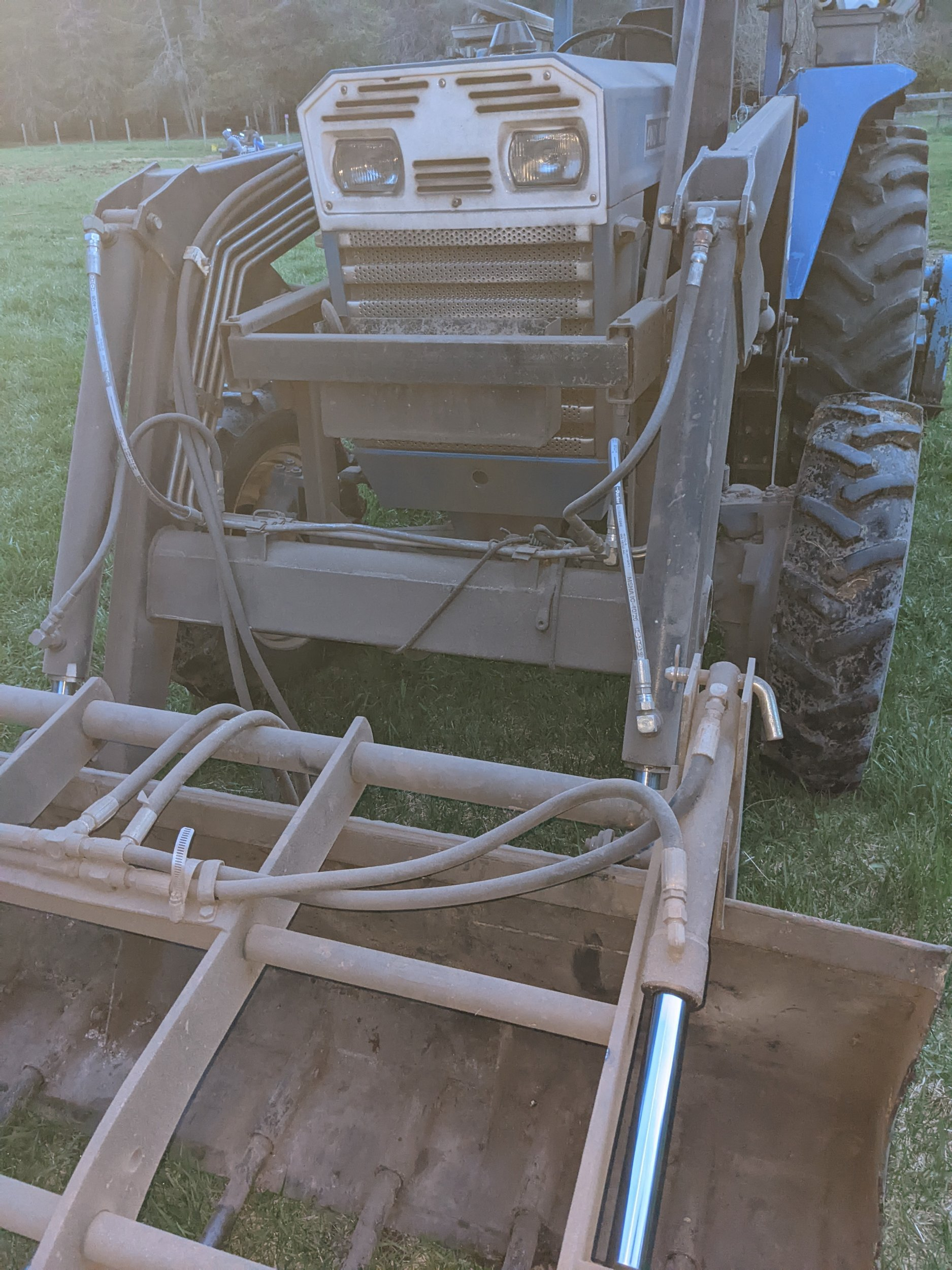

This brush forks is about 25 years old. Made for moving 6´ round hay bales. Four feet long. Slips on front of bucket and 2 nuts hold it on the back side. Slip on and off. There is a rear cross member on back side that needs replacement now after all these years. One tine has a slight bend on it. Mostly used for logs and firewood now. It probably needs a third tine in center. I have a bucket level that tells me position of tips. I can’t see the tips unless I stand up.
