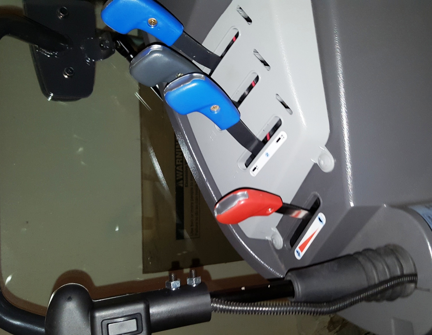

Below are pics of the third set of rear remotes that was added by my dealer a few weeks ago to my two-y/o NX4510HSTcab. In this case, the tech added the set to the top of the existing stack. No space problem at all. As you can see from the pic of the control console, he separated the two blue levers by moving the No. 1 lever (gray) to the center slot.
So EricTheOracle's info on this in the thread you linked to above is quite correct.
If you need the Kioti part number for the No. 2 kit, let me know. It's probably on my invoice, but I can't imagine that the dealer can't pull it right up.

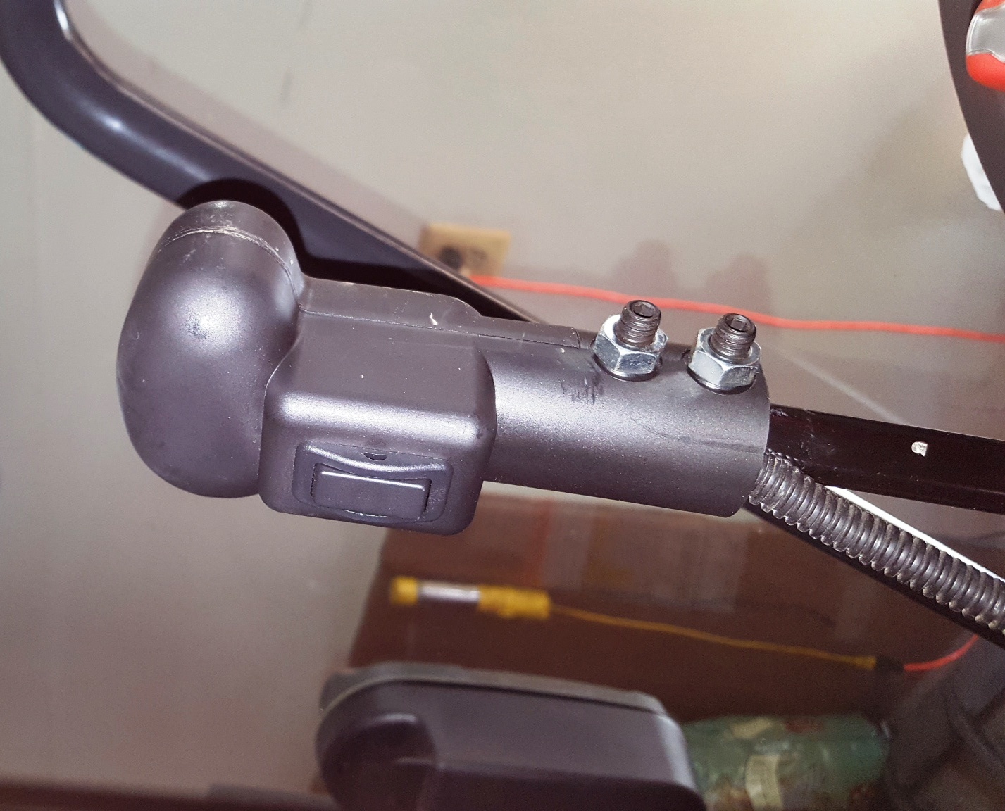

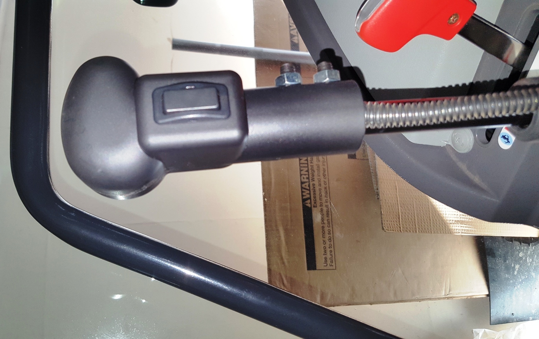

Threepoint, what is that you have on your loader control? A diverter rocker switch?
I have the same tractor and need to add something to the front but would also like rear 3rd remote as well.
I'm thinking diverter on front because you rarely need to do 3 functions at the same time and 3rd rear so for unlimited add ons.
/ Option for 3rd remote on NX? #7
Joe, I have the W.R. Long 3rd function kit, which is electric-over-hydraulic. The rocker switch you see is integral to the grip that replaces the OEM grip. Here are some better pics of it.

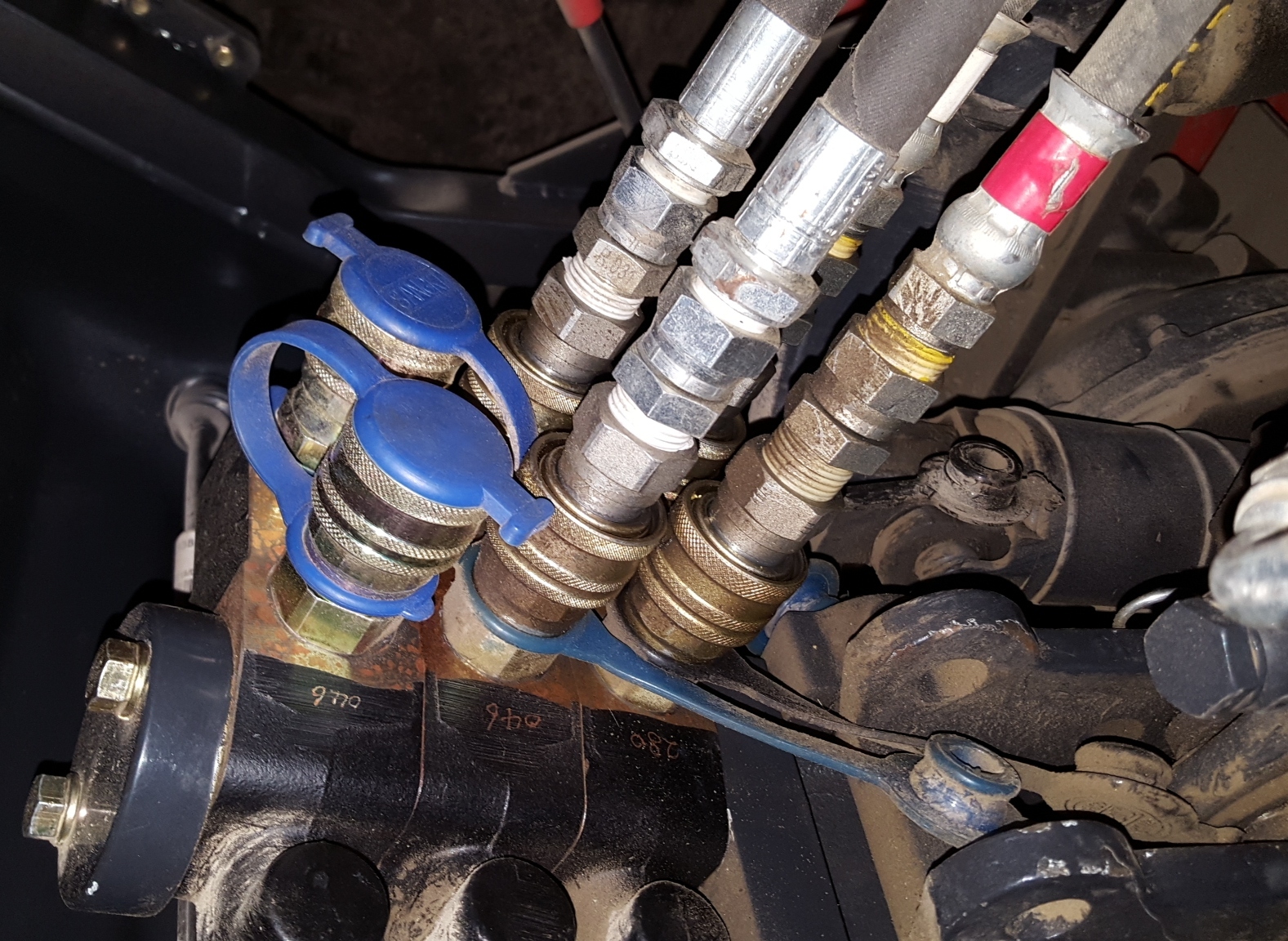

I just added two remotes today (total 3). It's rather easy to do despite the fact Kioti instructions leave much to be desired.
The first step is to open the doors and windows and crank your aftermarket sound system.
I started by removing the plastic cover to the levers, the bottom plastic cover located next to the floor at the back and then the two other grommets on the rear of the tractor. Then snaked a 12ga wire from the remote levers down and out the back. To this point is about 15 minutes if you take your time. I then used the wire to pull the new remote cable through. Would have worked but I was afraid of tearing the foam where the levers come through the fender at the top so I ended up removing the 3point lever handles (using the chanel lock procedure - works like a charm) and then removed all the bolts to let the fender raise up. That allowed the cable to come through followed bt the second one and secured everything. I used the Fasten all bolts recommend here. Ordered them online and was in hand the next day. Once tested I put the cab back together. You can easily do this in 2 - 3 hours if your going slow.
A final note. You need to remove the bracket for the top link holder. I ground the end and also took some of the curvature out so it would have adequate clearance.
If I hadn't cleaned the cab this was a 2 hour job taking my time.20160922_132330.jpg
