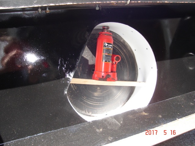

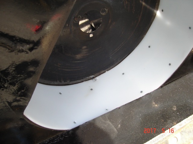

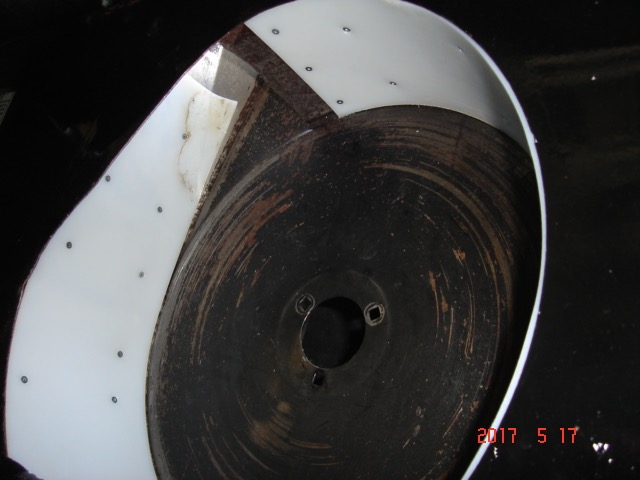

"...though with enough of them you may be good." That's what I'm hoping... I did get some expansion before, but the main issue was the large rock I picked up, hitting the entry point and folding the UHMWPE back, which then caught everything. I couldn't really get it totally flattened out, and I'd only had screws on the entry & exit areas. The next large rock I hit took it out the rest of the way.
This time, I pulled the PE sheet back a bit at the entry point (see pic #2 above), so hopefully the steel will be "the first to get it" when & if I pick up a rock. I've also changed my tactics: for clearing up by the dirt road, I now remove the blower and use the FEL, which is probably what I should have been doing from the beginning, since it only takes a few minutes.... live & learn!
Check out my handy-dandy auger/gearbox lifting arrangement--- that assembly is just a bit heavy for one person to man-handle into place when re-assembling.... it worked out pretty well. Also used a board and a bottle jack to ensure PE was tight to the inside of impeller cavity as it was being riveted.

Did first snow removal a couple days ago (more coming down now), and so far, so good. PE held up well, didn't seem to buckle or shift at all. Blower sounds quite smooth, actually. Time will tell....
Gloss black paint I applied to the inside of the auger housing has also worked surprisingly well at shedding snow -- wish now I had hit the auger surfaces and fan blades, too!
