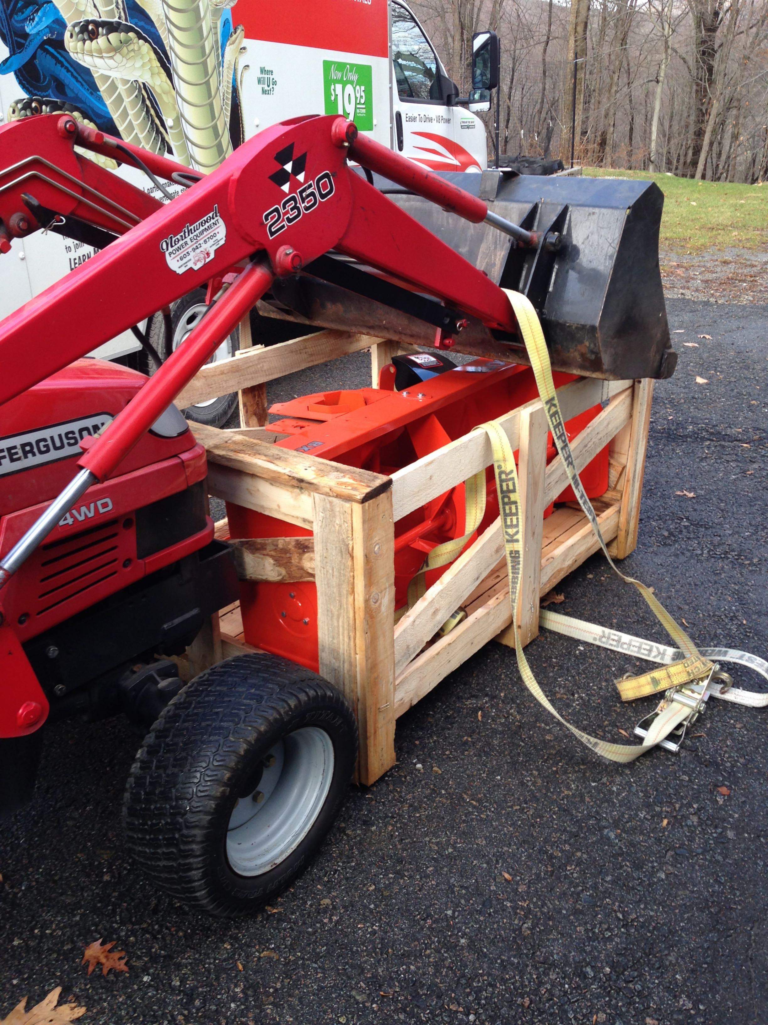

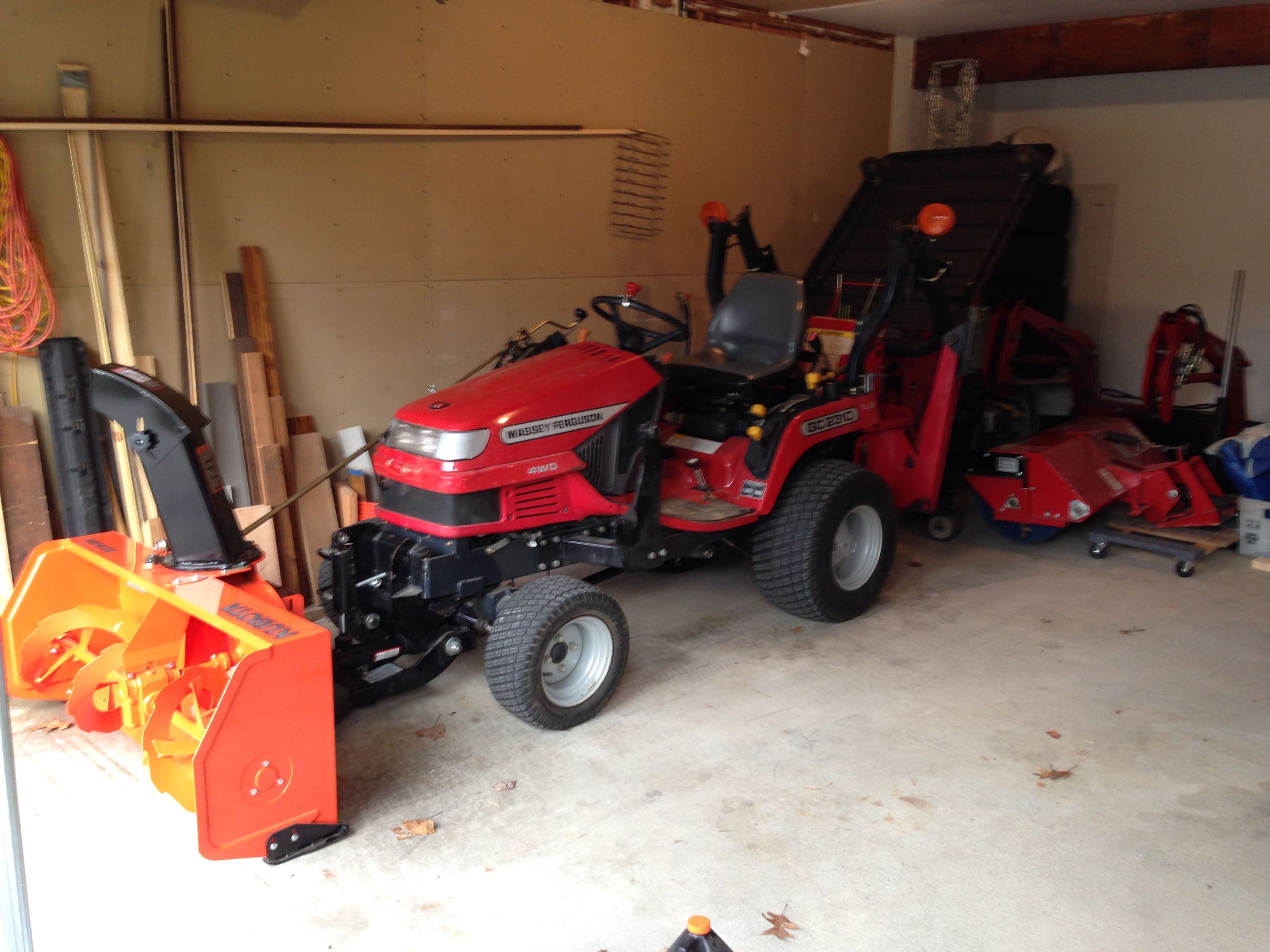

What I need do is figure a way to reload a single garage space, so as to fit storing the loader & backhoe attachments (and 2 sets of summer auto tires),
while parking the Massey w/ the blower attached, AND have reasonably enough room to janeuver swapping the blower for the rotary broom.
A @#$k'n rubrik's cube of a puzzle.

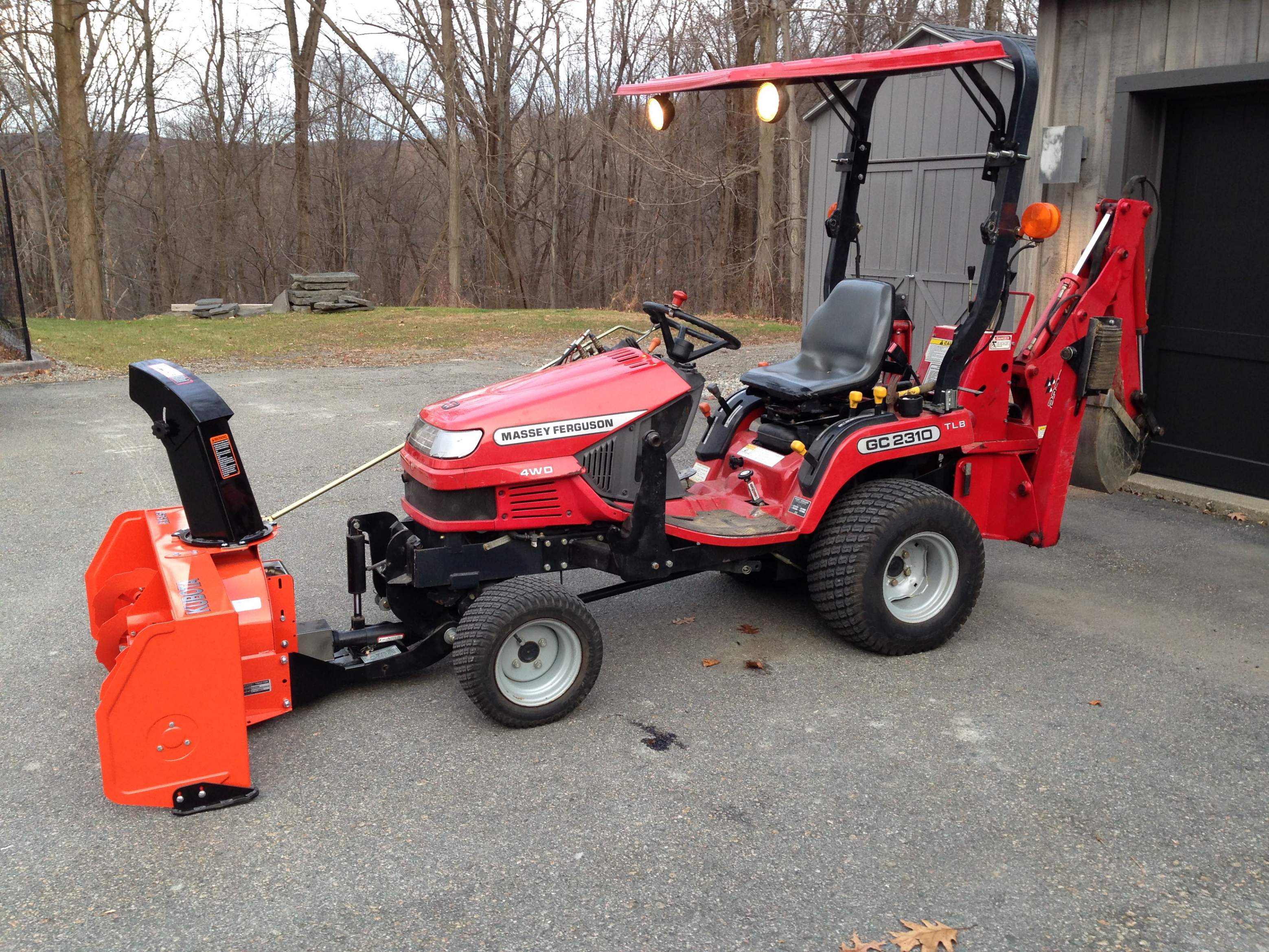

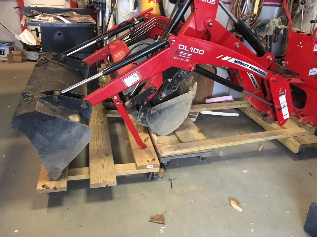

Hi Tim, It would help to know what state you reside. Also, my driveway sounds very similar to yours.
Here's what I do with the dolly's I built and how they "copulate" in the winter to save space.

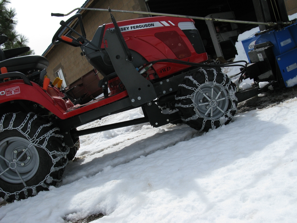

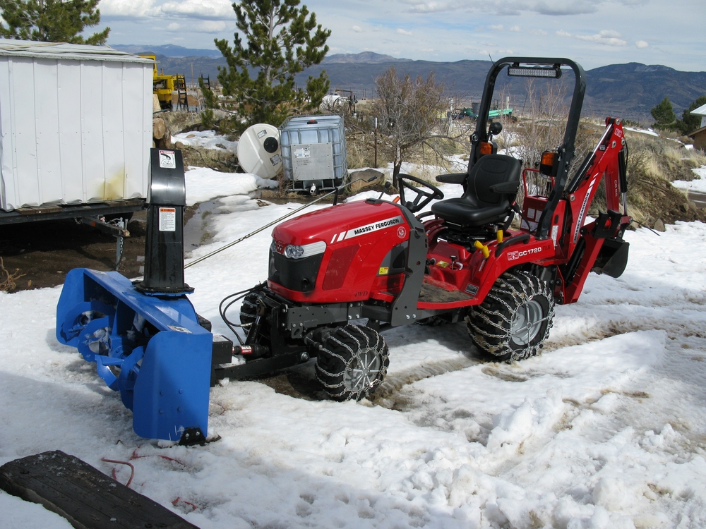

Well, the chains didn’t help much. Still have to get out of float mode and raise the blower a couple of inches when I want to turn. Have to modify the shoes.
I made my own brackets to mount the blue New Holland branded blower to my GC1720 and when I checked this morning every nut on my new brackets was loose. Must be lots of interesting vibration modes going on between the tractor engine and blower drive. Some red Loctite should hold things together. Thought about starting a new Blue on Red thread but decided to just keep it here

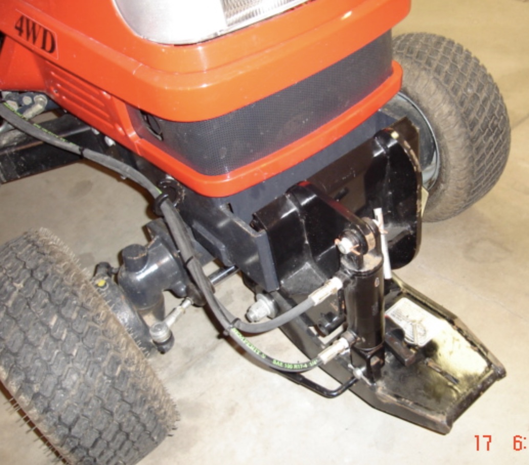

Sorry Langanbob - I haven't checked this forum in a while.

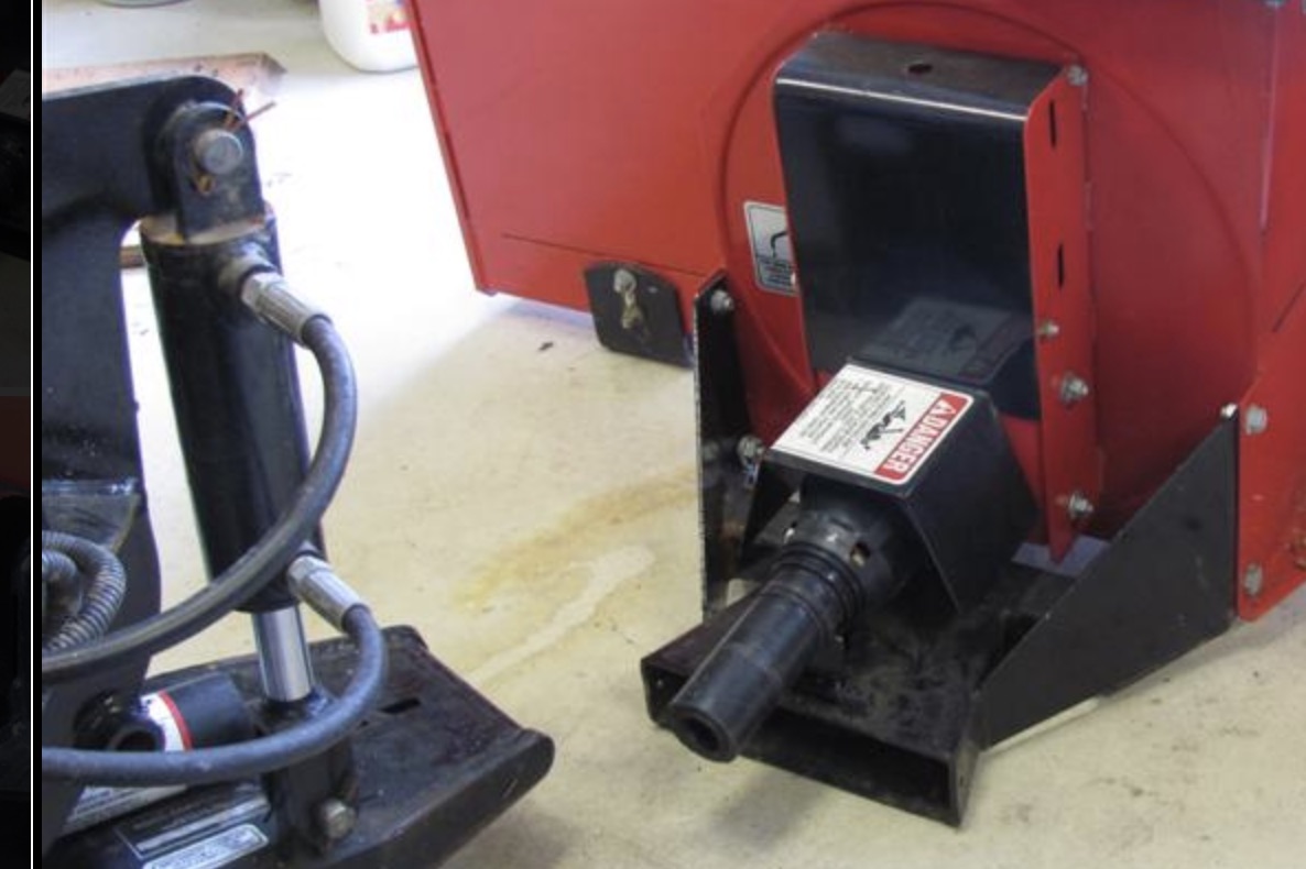

The mount is referred to as the Quick-Hitch subframe. It has a lift cylinder, hoses and a mid PTO shaft.
Looks like this:View attachment 537402
Front implements, Snow blower, Rotary Broom, Blade all have a female receiver:
I got the sub frame, minus the mid PTO Shaft, when I bought my MF 2330 Rotary Broom
The Mid PTO Shaft was a bit difficult to locate at the time. (I was able to order it from Jack's Small Engines)
The same Canadian company makes the Subframe, Snow Blowers, and Rotary Brooms for Red, Orange, and Blue tractors.
The Red Massey Blower is MF2360 (older design)
The Orange is BX5450 (new design)
and The Blue is 50CS (new design)
All are 50" snow blowers and are interchangeable tho I've been told there is a slight difference in Mid PTO rpm's and so the gearing of the chain driven augers are slightly different.

Just as a reference point for anyone who might be considering a 63 inch blower on a GC1700 series or other similar sized tractors, I have used my 63CS through two storms now and I cannot find any fault with it. If I dive too hard or fast into a windpacked drift, the motor will change pitch a little bit and I know to back off. Pretty sure the same thing would happen with a 50 inch blower.
We are at 6,000 feet and even with the elevation de-rating the GC1720 has plenty of power for it. I did not intentionally look for a 63 inch blower, the only 50 inch blower I found was a worn out POS and then I ran across a New Holland 63CS in great shape so I bought it. Actually glad I did. I have a little more than half a mile of road and the extra width makes a big difference and saves me from having to make three passes. Note that although I wish I owned half a mile of property, I do not own the road. It is a non-county maintained acess road to our neighborhood. We all share the snow removal chore.

Here are a couple of Blue on Red pictures. The blower is a New Holland CS63. It took a little bit of fabricating to the mount bracket working right. The mounting system is longer and reaches underneath the tractor, in contrast to the standard MF2360 mounting bracket that bolts to the front of the tractor frame. It all works pretty good. I have some fine tuning to do on it but it will wait 'til spring.
