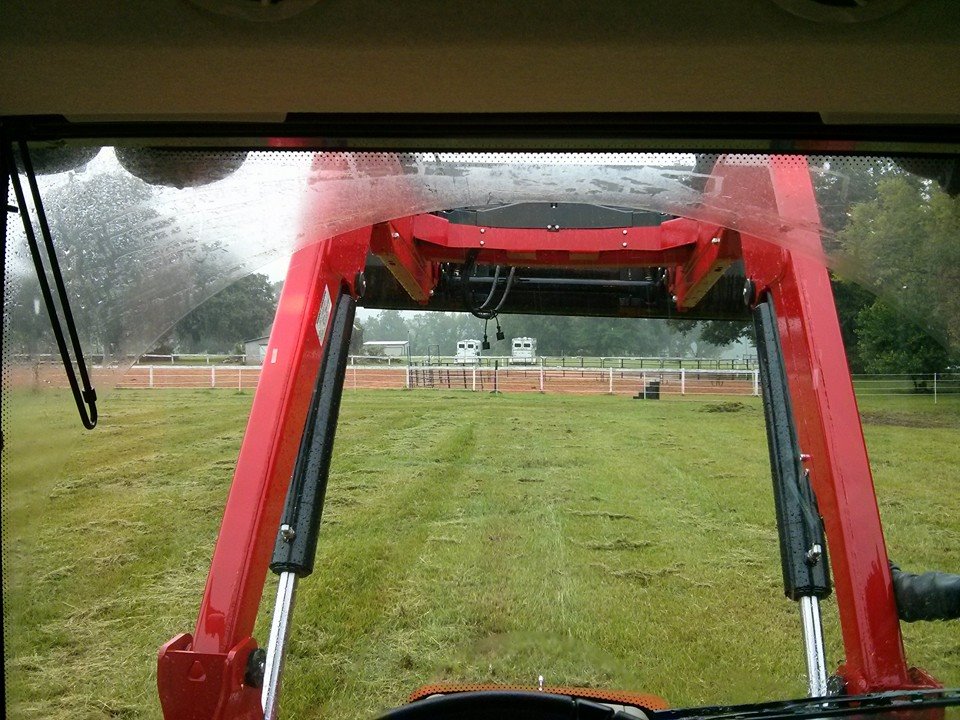

Really enjoying the cab on the MF. Very quiet even running at PTO rpm. Plus, its nice and dry when you have to top fields in the rain. :dance1:
