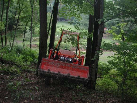

Another pic...the tractor would not take this path if it had a 60" bucket on it.
For moving in your forrest the narrower bucket may make a huge difference when trying to get between points A and B... /forums/images/graemlins/smile.gif

As Bob and Henro pointed out a bucket as wide as the tractor makes manuvering between trees a lot easier. You may have 10' wide paths but, with over 100 acres, there are going to be lots of areas without paths. How are you going to get the tractor in to haul out the game if you can't drive between the trees?
A 60" (5') bucket being half of a 10' path isn't going to help in reducing the quantity of passes thru for clearing. They never line up end-to-end like that. You'll still go down the middle for a clean-up pass--more likely 4 or 5 times.
The narrower bucket will also be easier to use for landscaping on irregular surfaces. The wider bucket is difficult to hit smaller areas with (a wider bucket disturbs more soil than you wish it to do). Sometimes, when I am moving dirt in shaping surfaces, I wish for an even smaller bucket than the 50" I have on my B7610.
Unless you are planning on hauling lots of bulky materials the narrower bucket is the way to go.
