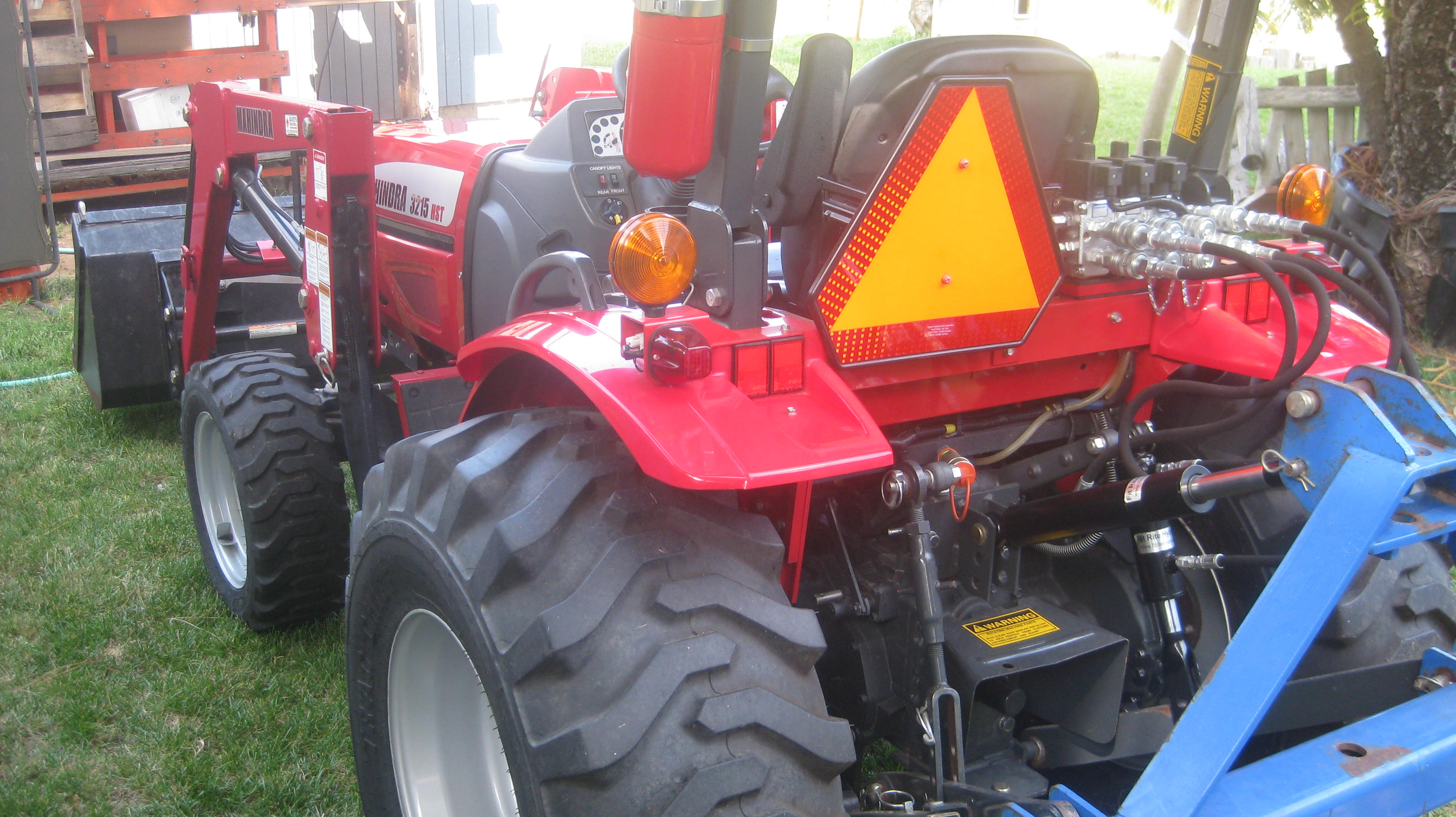

This is what I have on my 3215. Only a single factory rear remote is available, I needed 4. The diverters are mounted in the factory position, just a few more outlets though. :rolleyes:

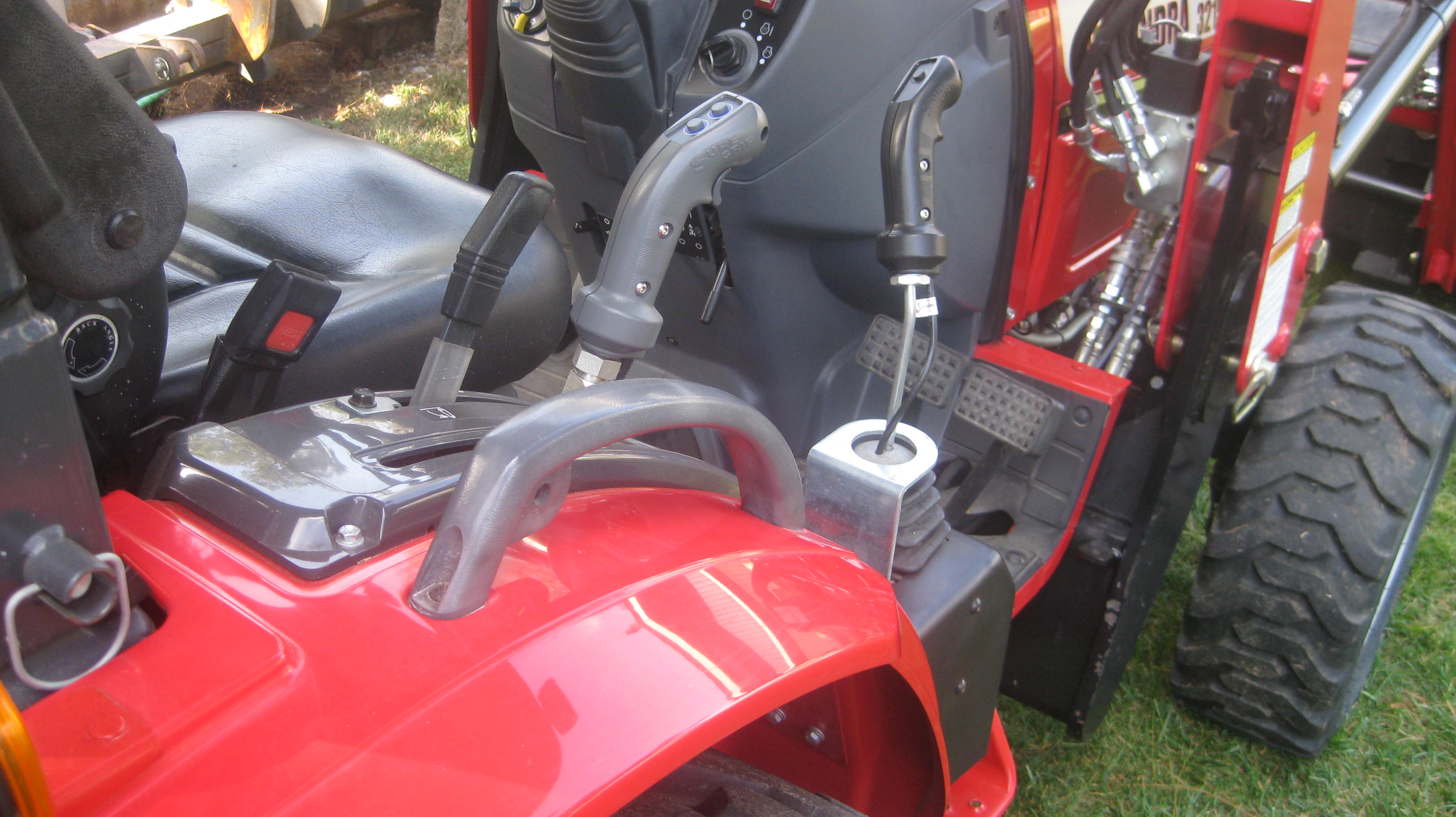

There is the single grey control grip for the rear remotes, it has 3 separate switches in it. 2 buttons, 1 trigger.
