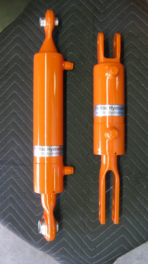

Get every rear remote that is available. You may not know it, but you will end up wanting a top & tilt set for your 3pt hitch with all the grading that you need to do as well as road-drive maintenance.

NONE. :rolleyes: Just reality once the grading begins and the continuous stopping, getting off the tractor, making the manual adjustments that you think you need, getting back on the tractor, moving 50 feet and doing it all again and again and again . If you're lucky you get to go a few hundred feet, before doing it all again. :cool:
BTDT, is why I do what I do.
He needs the set that is pictured, maybe not orange though. ;)

I will vouch for Brian's Top and Tilt. Ordered one for my DK40 bout 2 years ago. I had an issue with the fit and Brian was on top of it. My drive is short (couple of hundred eet) but the hydraulic makes all the difference with a box blade, spreader and other implements.
Never again will i dismount to turn the crank.
Brian i like the orange cylinders. mine re black. Please send me orange replacements !!

Depending on what end of the order you're on, (not so good for my customers:(, but good for me ;)) but currently out at about 20 weeks. Even at 20 weeks people are still ordering at about the same rate that I can build these things. So I'm not expecting the lead times to drop significantly anytime soon if at all.
You would be looking at $890 + shipping costs for a complete top & tilt set. 2 cylinders built for your tractor, 2 hose kits and 2 sets of flow restrictors. Orange paint is optional.
Oh, and I believe that you will find that you will forget about any Harley after working with this stuff. :thumbsup: :thumbsup:
