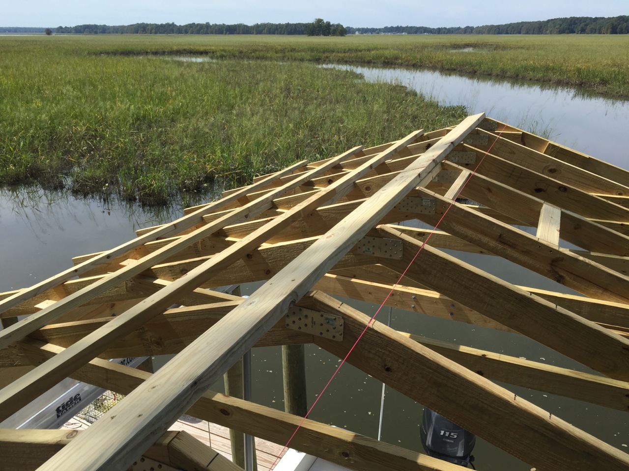

I recently explored this topic while building the roof trusses for my boat house. I had planned on using pressure-treated plywood, and bought a couple sheets. About 50% through the first sheet and a heap of sawdust later, I noticed so many voids in the cut gussets that I gave up on the plywood, as I knew I couldn't trust it for this use (I never would have slept through the night).
So if you do use plywood, make sure it is a high grade that does not have internal voids (I forget the nomenclature, but there is a rating system for plywood that covers stuff like this -- most of the CDX grade plywoods used in construction will have voids).
I'd have no problem using OSB for gussets if they were out of the weather. It is stronger than plywood for applications like this. Glue is important, as well as the nails.
By the way, after I punted on plywood I switched to using 12 gauge triple-galvanized nailer plates and 1-1/4" galvanized joist hanger nails. Did that on a previous shed about 15 years ago, and it worked well then, so I knew I could trust it here. The plates cost about $2 each, and a box of nails was about $16. Put a plate on each side of the joint, with nail holes staggered. Here's a pic that shows the result:
How come we only get to see one photo of the boat house?
