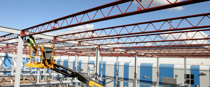

   / OSB or Plywood for Truss Gussets? #50
The web of a beam can be almost completely removed.
