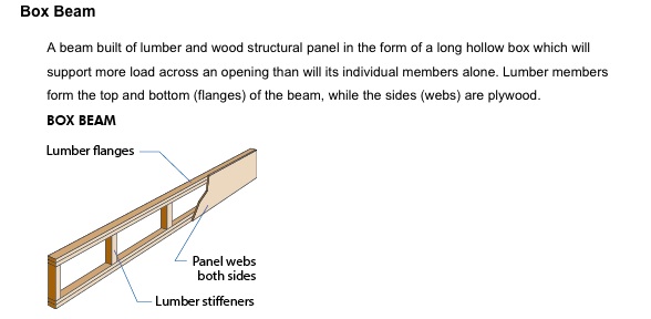

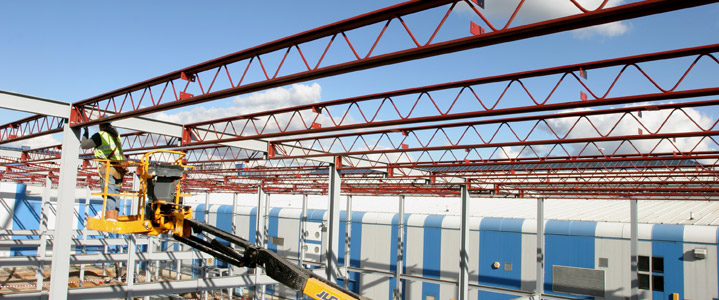

The web of a beam can be almost completely removed.
Bruce
That is like those trusses I was talking about that had angle iron tops and bottoms with round bar in between. (or sometimes little angle iron in between.)

Why not build a truss like the OSB I-joists? No ope webbing, rather all closed in with OSB and 2x4 around perimeters?
Of course not having open webs would be a drawback... But something like 6 sheets of OSB for a 4/12 pitch 40' span truss. That ~$60 and about $40 of 2x4's around the perimeter. I would "think" that would be as strong as one of them large OC spaced trusses that has 2x10 tops and 2x8 bottoms. Cause those trusses are ~$300 or so to buy?
Of course not having open webs would be a drawback... But something like 6 sheets of OSB for a 4/12 pitch 40' span truss. That ~$60 and about $40 of 2x4's around the perimeter. I would "think" that would be as strong as one of them large OC spaced trusses that has 2x10 tops and 2x8 bottoms. Cause those trusses are ~$300 or so to buy? I know its a crazy idea, but I am bored.....what the heck. (I am not actually going to build trusses like this).
I am sure the first time someone had the notion to make the i-joist people called him crazy...
I joists are great, except in a fire. They fail early and often.
That would be the drawback to suing them for a roof truss.
Sorry, bad idea.
