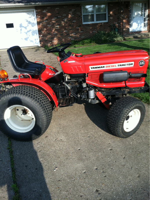

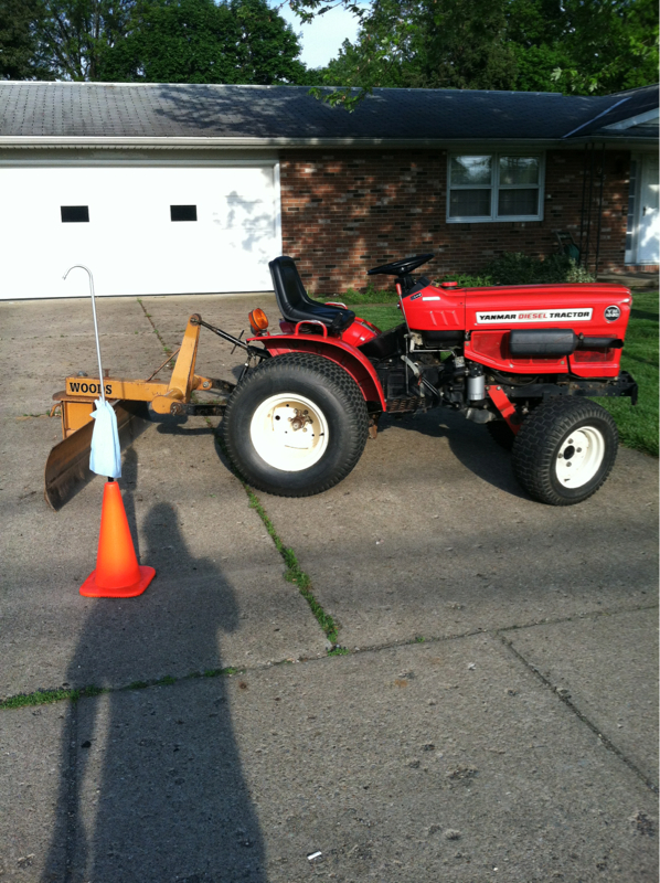

So there she is, found this kind of by accident because I was out and about. Got the number and called. After a long and painful conversation with the owner...painful on his part because he just did not want to get rid of the tractor....I gave my dad a call and told him he needed to check it out the rest is history. We pick it up Saturday.
14hrs on it, I believe he said it is a 1992 model came with the blade shown, dump trailer, roller and hopper spreader.
I would like to hear what the people familiar with these tractors think the price should have been. And any opinions on the unit itself, it is not a grey market tractor I know that but any other advice or comments will be greatly appreciated!

Thanks for the info guys! He said he paid a lot more than 8,000.00 for it new. So by looking at the pictures would you say the condition is??? I have seen a few with a lot more hours go for what my dad paid for it. 5,000.00 for everything mentioned. Thoughts??

You got it for a good private-party price. A dealer wouldn't have paid more but an ebay prospect might have, if the seller went to some effort to market it effectively.
That is a genuine classic. Baby it, park it indoors, and it will be worth what you paid for many years.

If he used it for 1000 hours and it still looks like that, it has been so babied the hours don't matter anyway. There is no way to check the hours aside from the meter. It is a mechanical connection from the engine to the tachometer. While it is conceivable someone would unhook the tach to prevent the hour meter from accruing time, it doesn't seem like he had any incentive to do that. The machine looks brand new.
One can infer the amount (or maybe more accurately, the type and severity of use) by looking at the pedals, floorboards, seat, and other parts of the machine. Worn paint or tread plates show lots of use, and probably in a gritty environment.
Missing battery hold down plates are one of my indicators, too: missing or improvised forms of this indicates, to me, someone who had difficulty affording a new battery, and instead cobbled something out of leftovers. While the tractor doesn't care what battery it has, I am always suspicious that a person who cannot buy a $50 battery before losing the battery hold down may not
have been diligent about regular oil and filter changes or other maintenance.

Just for reference there wouldn't be any paint worn off the wear points from use at 14 hours, like the grab handles or the foot rests or the pedals.
It appears to have had something slung underneath at one time.

Very good advice thanks a ton! He said that the tractor alone weighed 4,000 lbs is where I found he was off. Not a big deal but definitely got the mind wandering, but I will post more pics Saturday when we get it to his house. As far as the wear you talked about it is almost non existent. Thanks again for all the advice i really appreciate it!!

One more thing that would verify 14 hours: on the tires, there should still be some mold flash or rubber pins sticking up (mold vents) in the tread. Those have lasted at least 40+ hours beyond my purchase date on both tractors.
My YM186D has substantial wear to the chrome shift lever where it goes into the 'gate' on the instrument panel. Visible wear there might prove higher hours.
