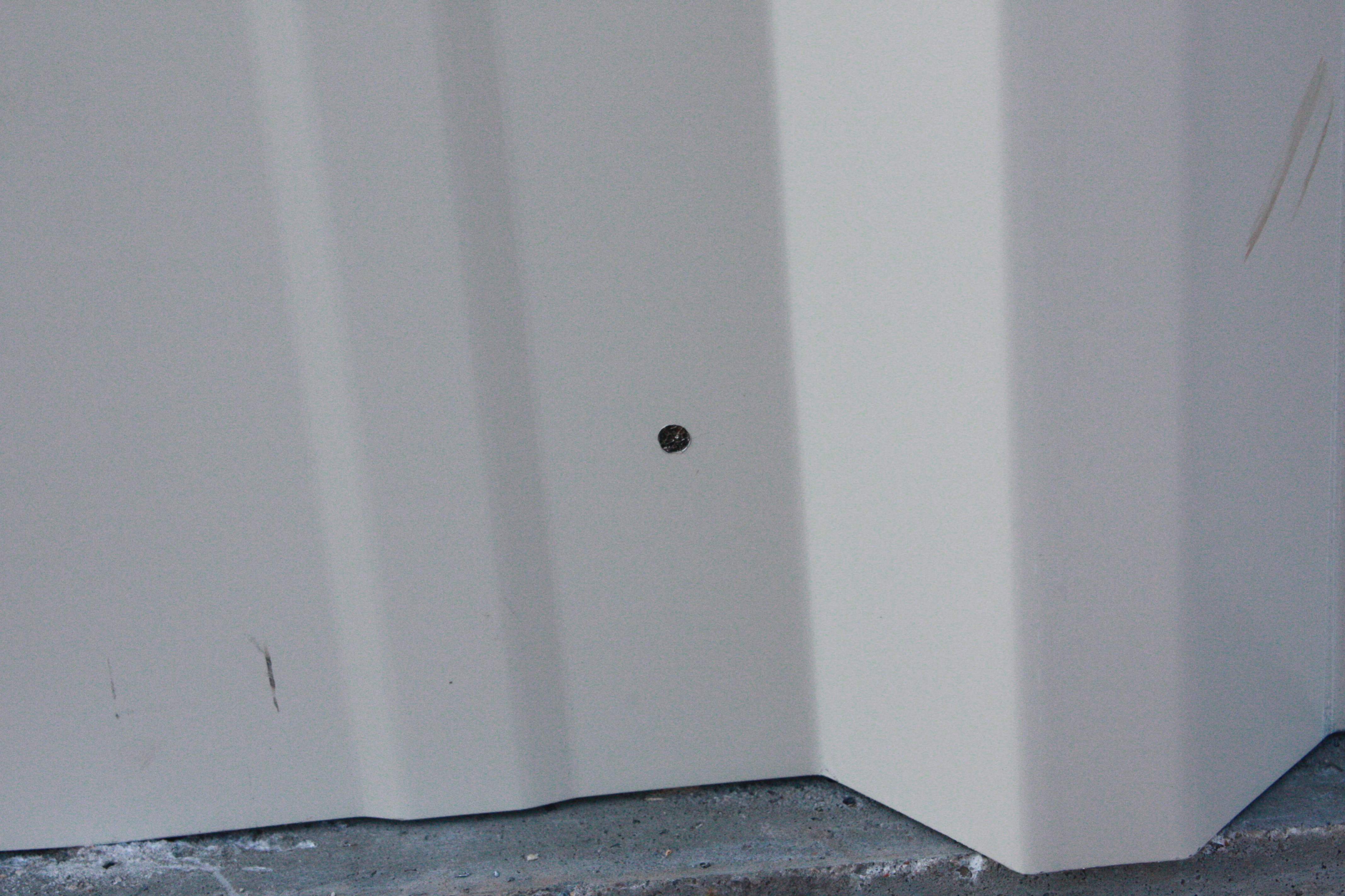

#1 - oops a hole.

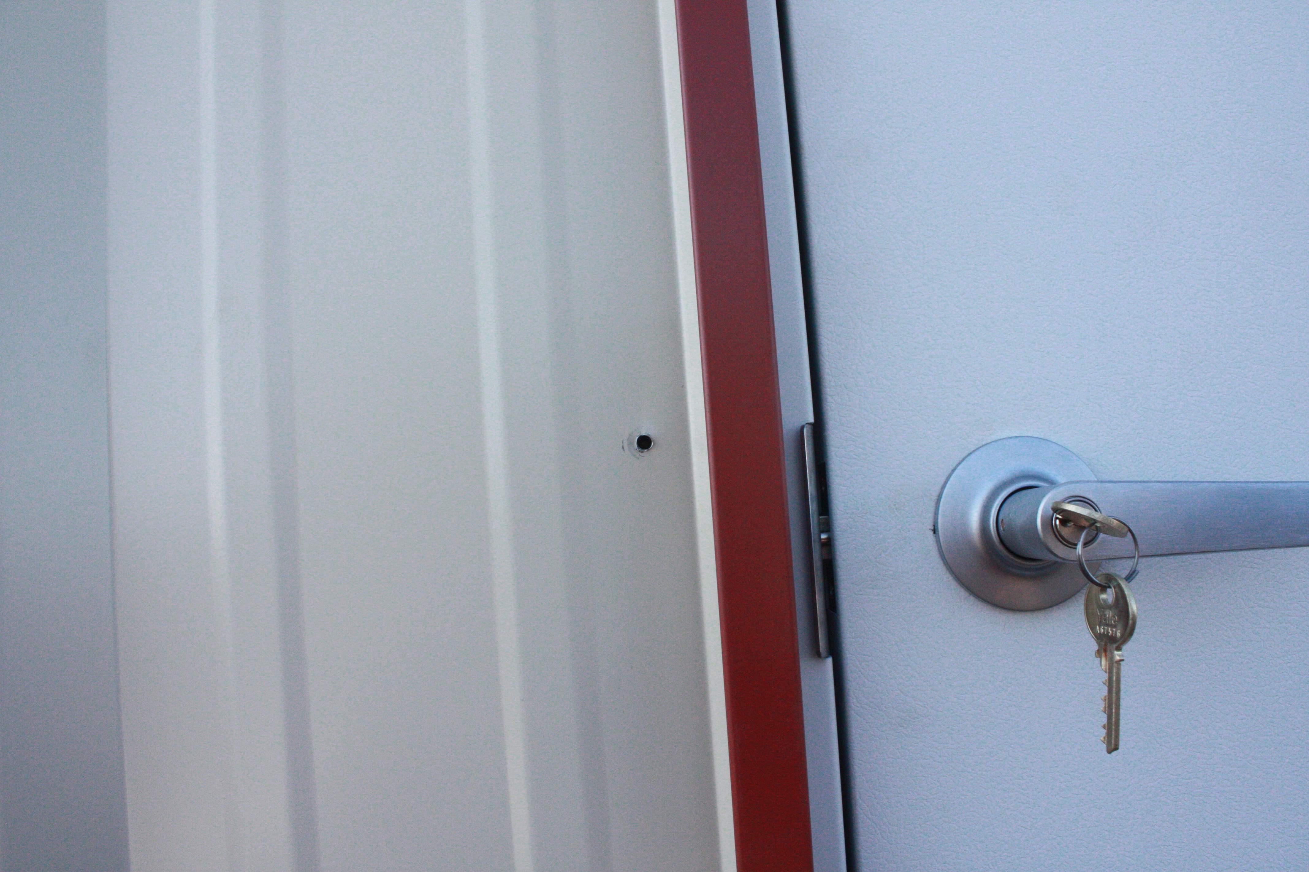

#2 - oops a hole and oops no base trim.

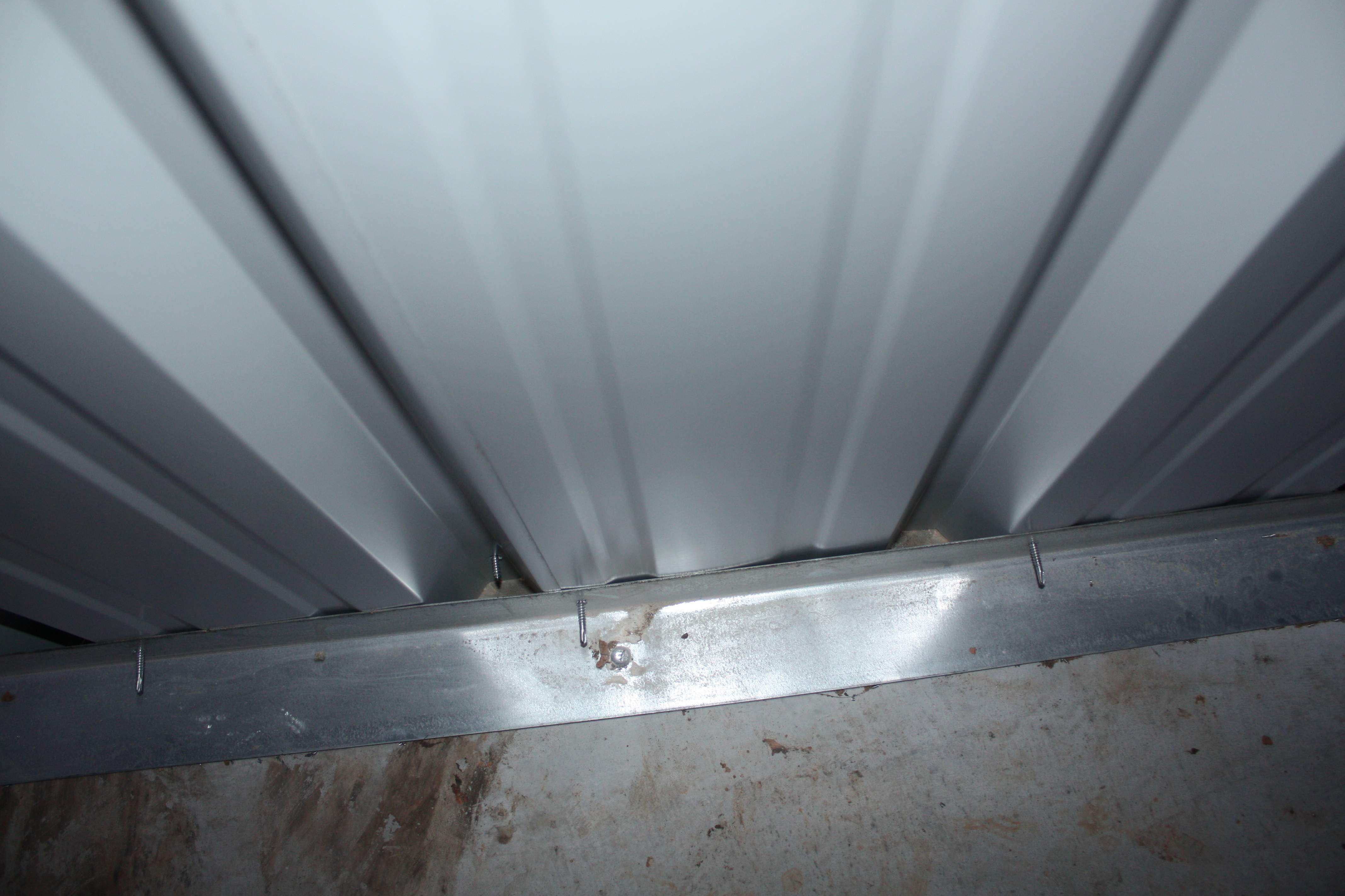

#3 - oops no weatherproofing closure strips.
We have 100's of photo's - this is just an example.
