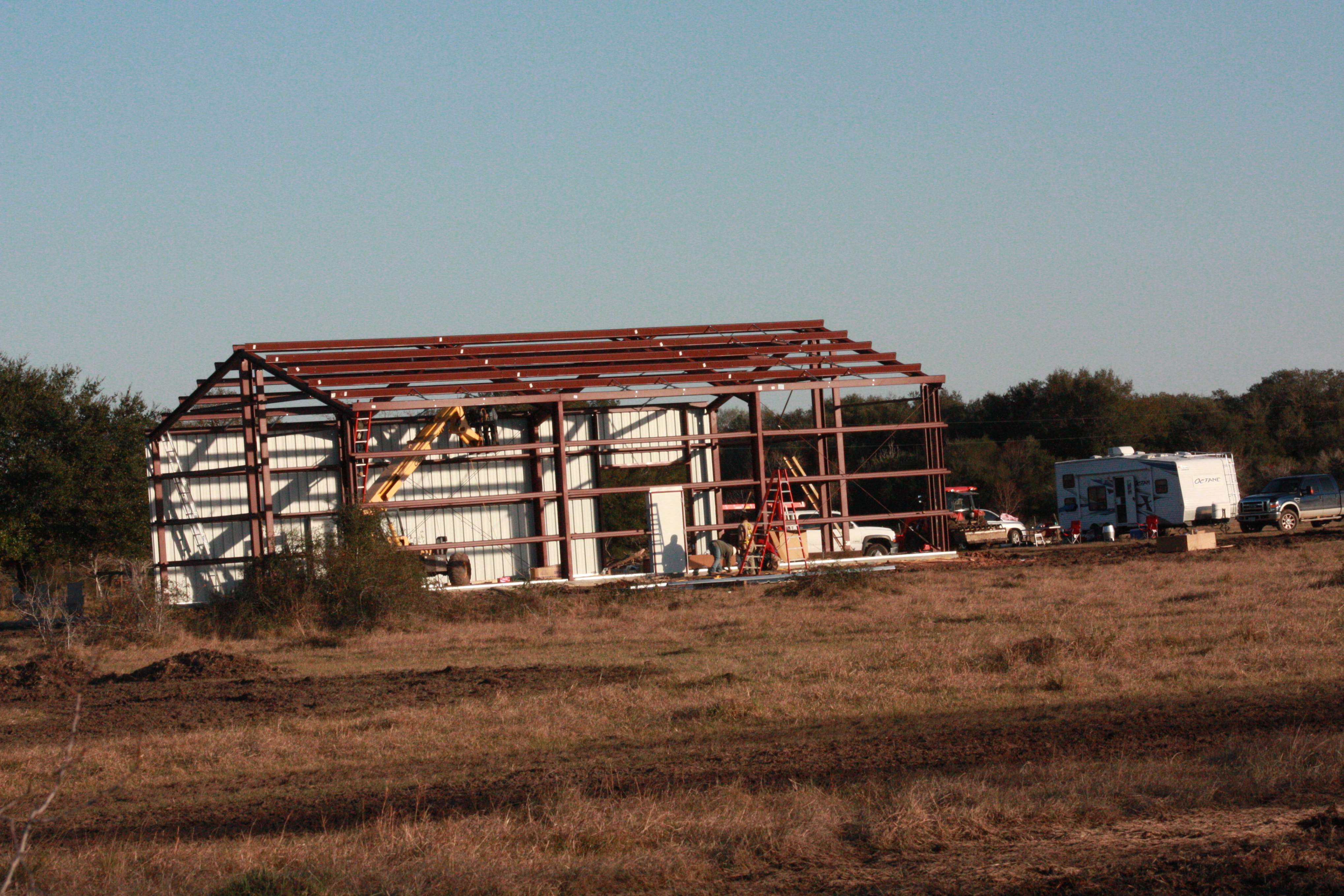

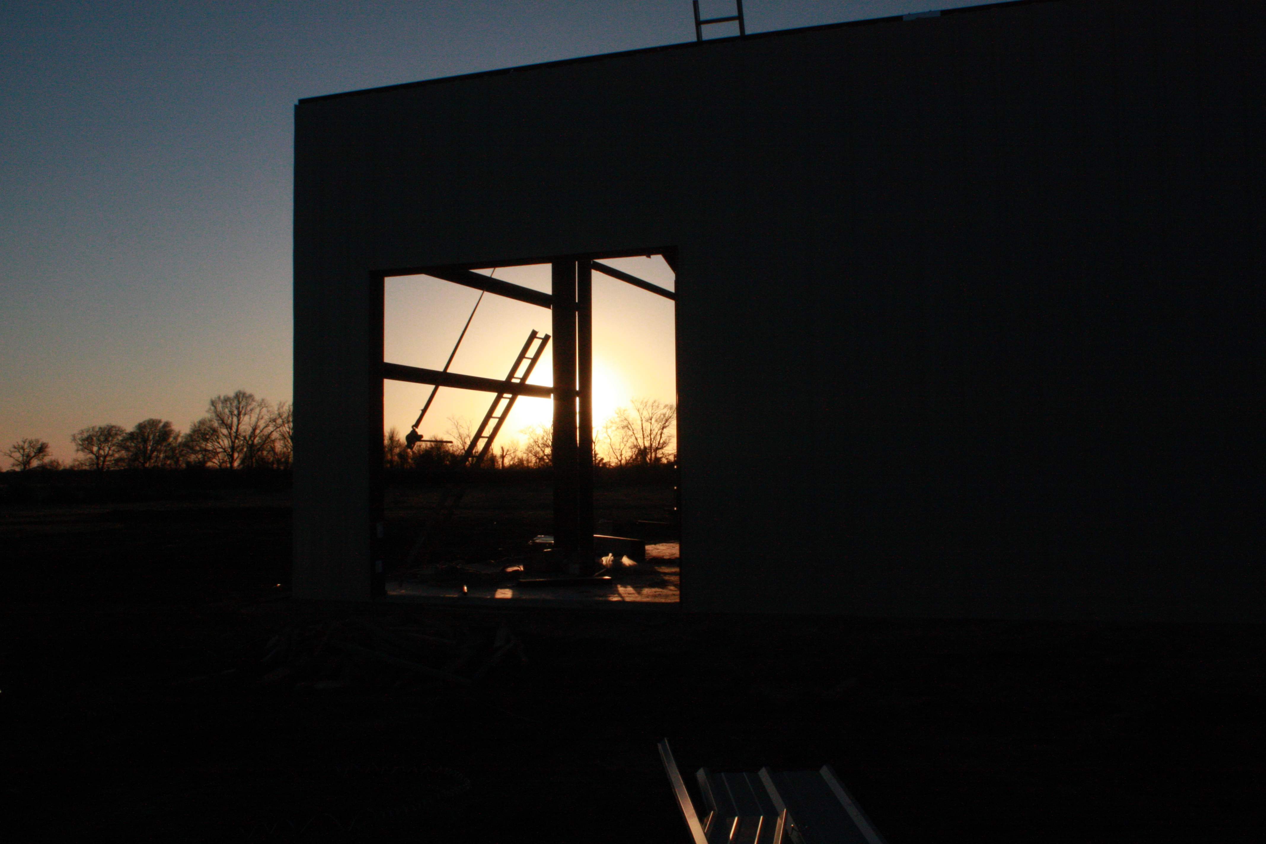

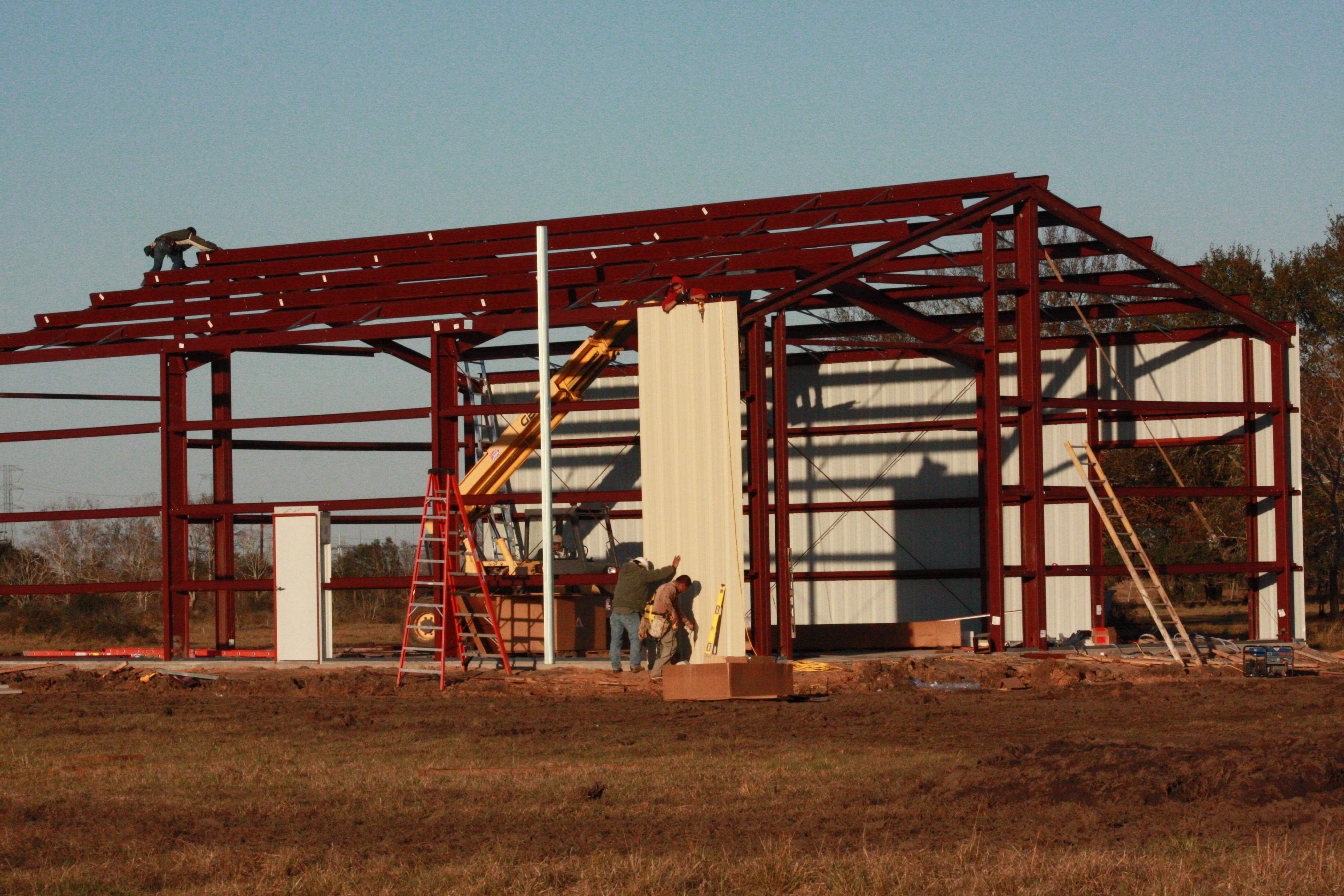

The end of their 2nd day of construction.

I'm somewhat surprised the framing crew didn't assemble the columns and trusses flat on the concrete pad and tilt them into place with the telehandler as that Gehl looks to be more than up to the task of erecting the building that way.
Sorry to hear the GC screwed up on the sill detail.

I looked at what I am guessing is the manufacturer's website. Seems like the sill notch could have been backfilled with treated lumber (or custom iron) bolted to the slab. Maybe not too late? Just a thought.

We've spoken to many metal building companies and industry experts - we are learning more and more about the whole process. Unfortunately the laborers ignored several things from the construction video, instruction manual and engineered prints. Minus the notch in the concrete - It is my personal opinion the project would have gone more smoothly if the GC was present during the building process - he could have explained to the crew what needed to occur - unfortunately he wasn't there for a nano second during the 4 day process. ;)
After we inspected the structure they attempted to remove the wall panels at the door locations (3 roll doors and 2 walk doors) because they fastened the trim before they attached the wall panels. The wall panels had daylight at the doors because they were not affixed - the metal rested on the head of the fasteners that attached the trim to the columns. a.) On a 14x14 door they forced fasteners in to the wall panel - now we have the heads of the self drilling fasteners, that secured the trim, sticking out/through the wall panel. b.) On a walk door they damaged the heck out of trim - looks hideous... it would probably $10 or less in materials to fix it. Regarding the base trim: We are open to suggestions. I think the wall panels height from surface and distance from the columns are based on the notch in the ledge and lack of base trim. I think if the notch was filled in - they'd have to remove and reinstall the wall panels up on to the new ledge aka base trim. I think we'd end up with 100's of more holes... :ashamed:
