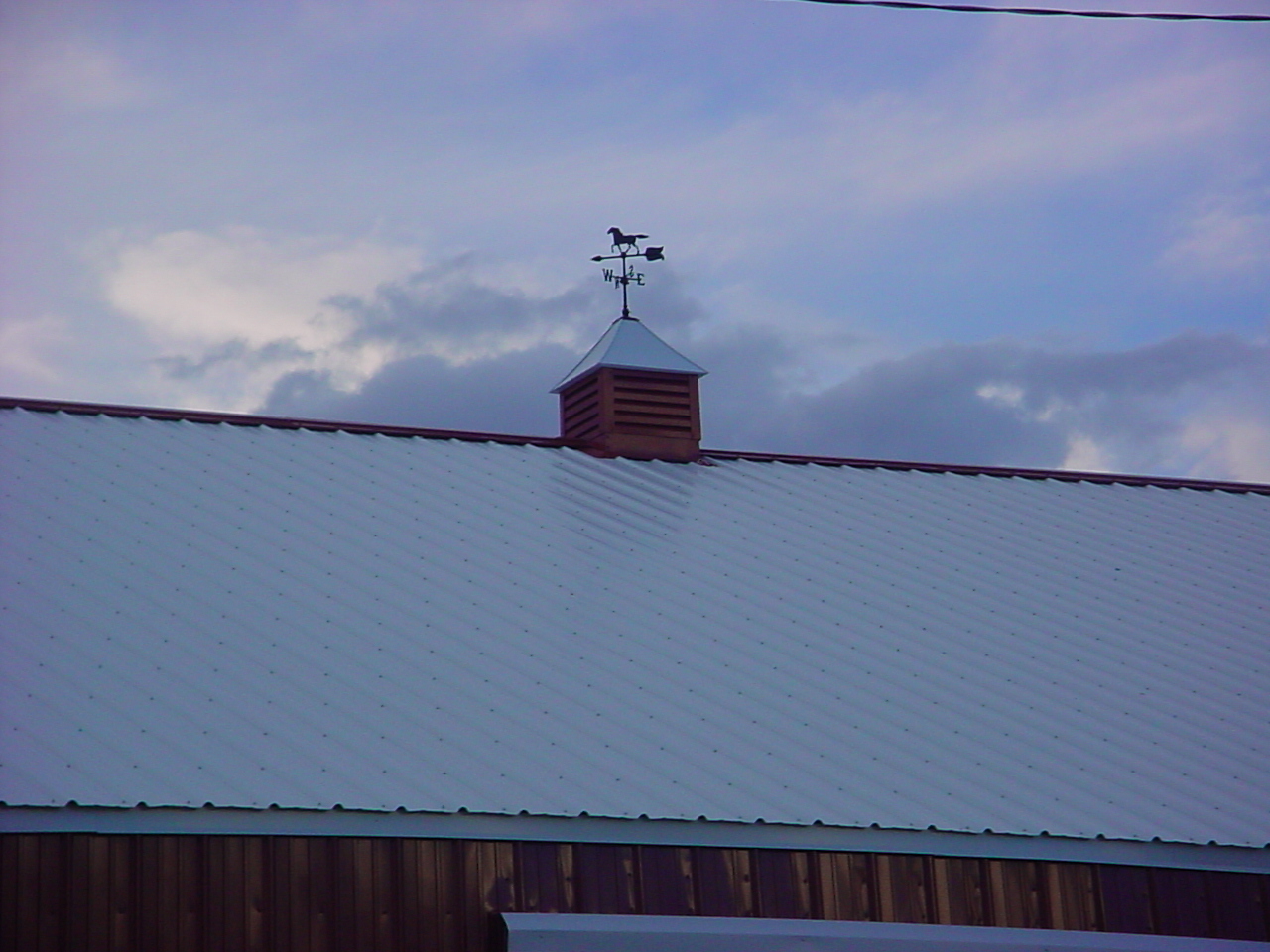

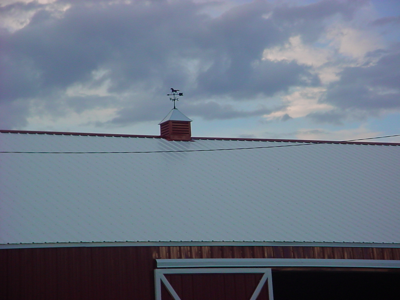

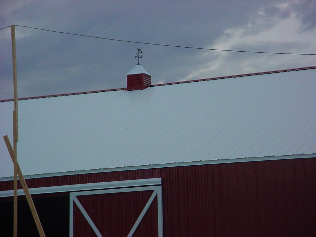

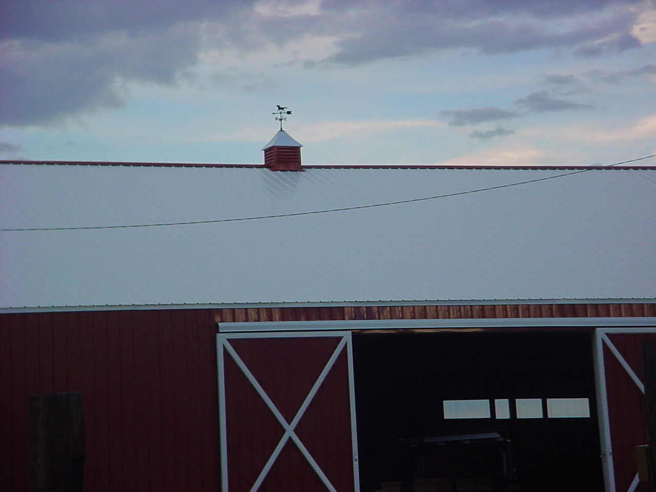

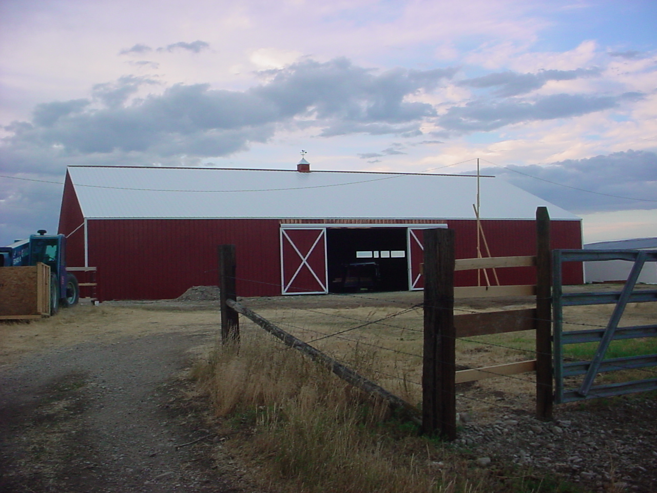

Part 5 , Got the weather vane installed today and we are working on the interior. We are almost finished with it. I will post the final pics when we are done with the stalls and the tack room.
Here's the pics of the weather vane mounted onto the cupola. enjoy! :)
