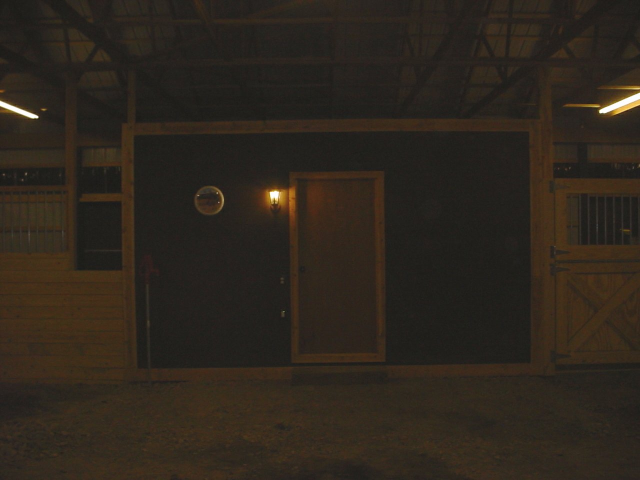

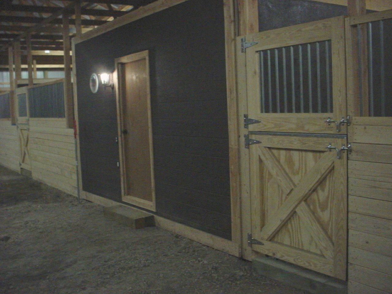

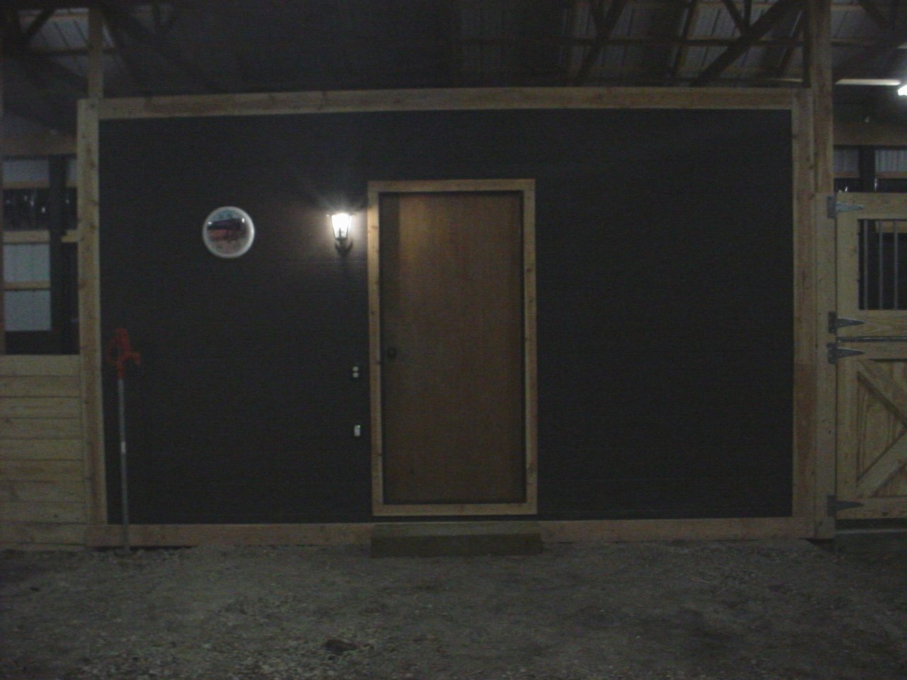

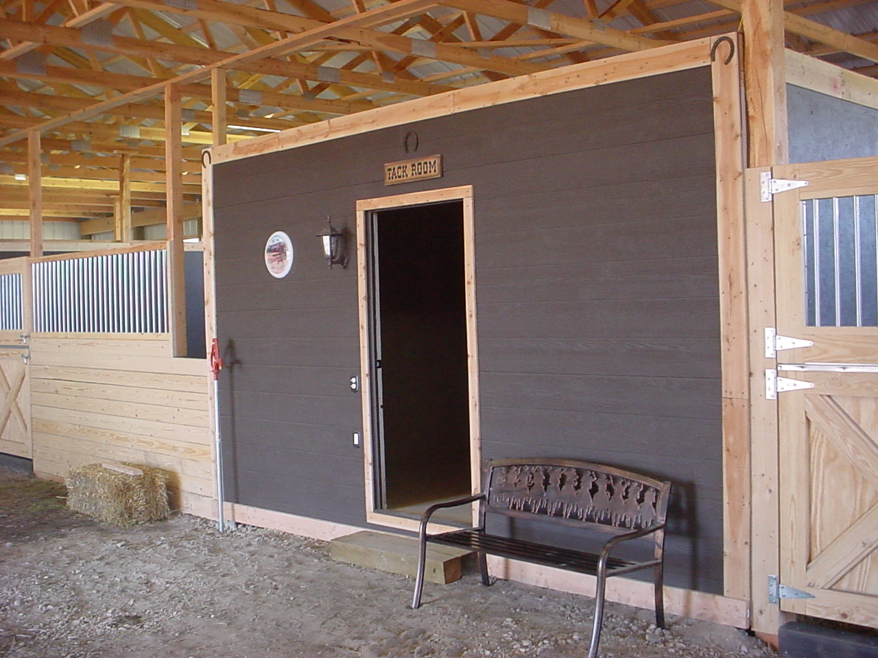

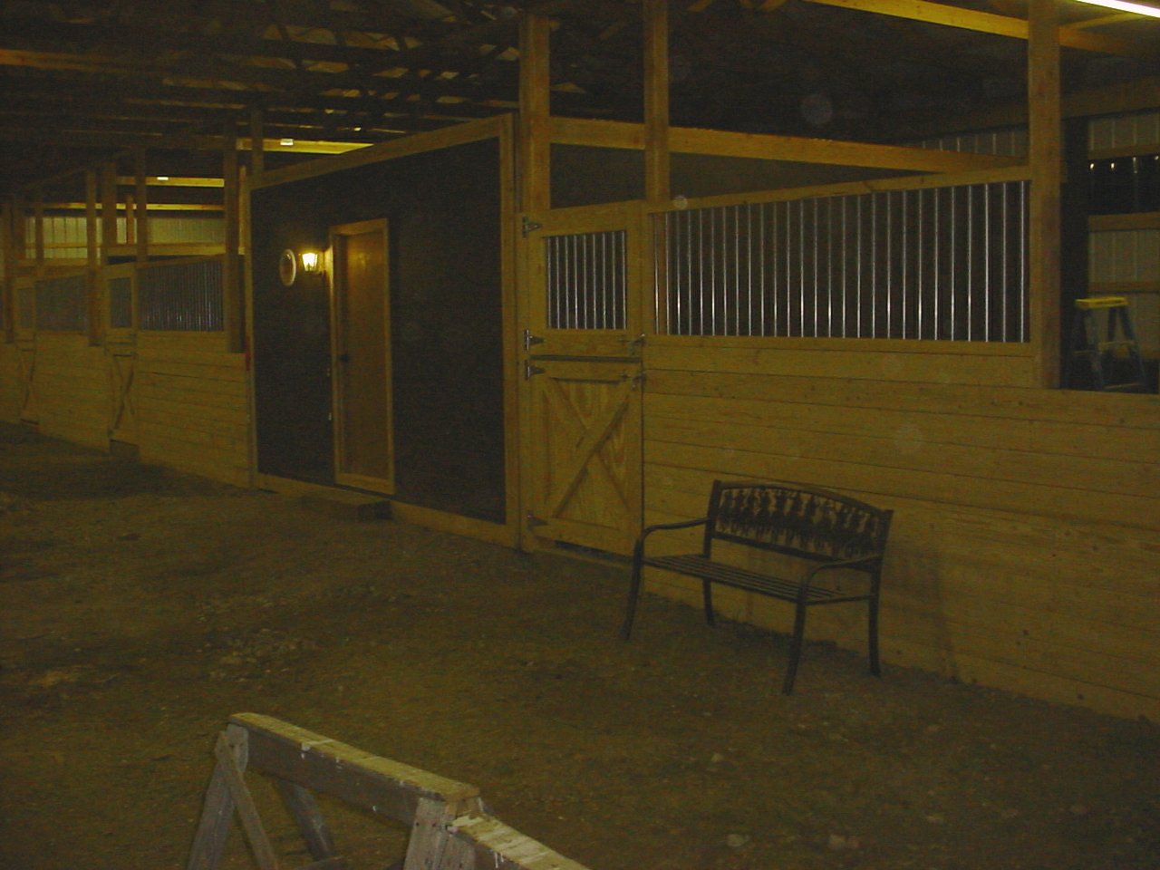

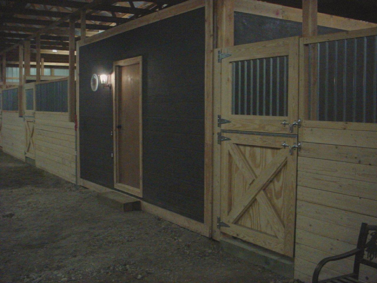

Part 9, These are pics of the Tack Room with all the exterior painted and the ceder trim done on the front. New bronze colored Socket Covers, Switch covers and Door Handle to match the Lamp. On the pics taken at an angle you can see the two finished stalls on both sides of the Tack Room. Just finished the second stall and I have 3 more stalls left to paint and they will be done.
I also have the top of the Tack Room insulated with R19 insulation and capped off with OSB on the top. I didn't bother taking any pictures of the top as it is pretty plain looking, nothing fancy there. :laughing: I put the cover panel on the Breaker Box and got the phone line routed to the Tack Room. Then mounted the outside weather gauge thing on the left Tack Room wall. It is the round thing on the wall in the pics.
I will probably be building the rest of the inner walls of the Tack Room tomorrow then we will be back to painting on both the inner Tack Room walls and the other stalls. I will be Painting the exterior of the Back Stall Dutch Doors with the red and white theme to match the exterior of the barn. That will be coming up on the next real good day we have.
These pictures are ok but they were taken at night so they are not as clear as I wanted. I will most likely add them again later when I get some good daylight pics. Anyway, here you all go, and enjoy! More to come later as we are making good progress. :D
