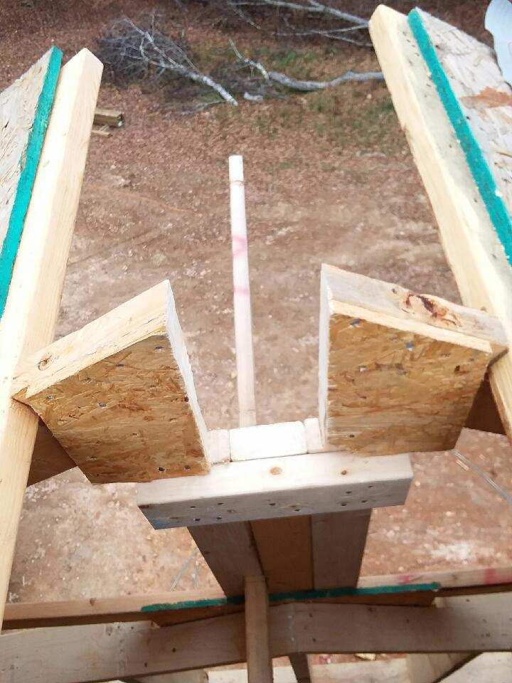

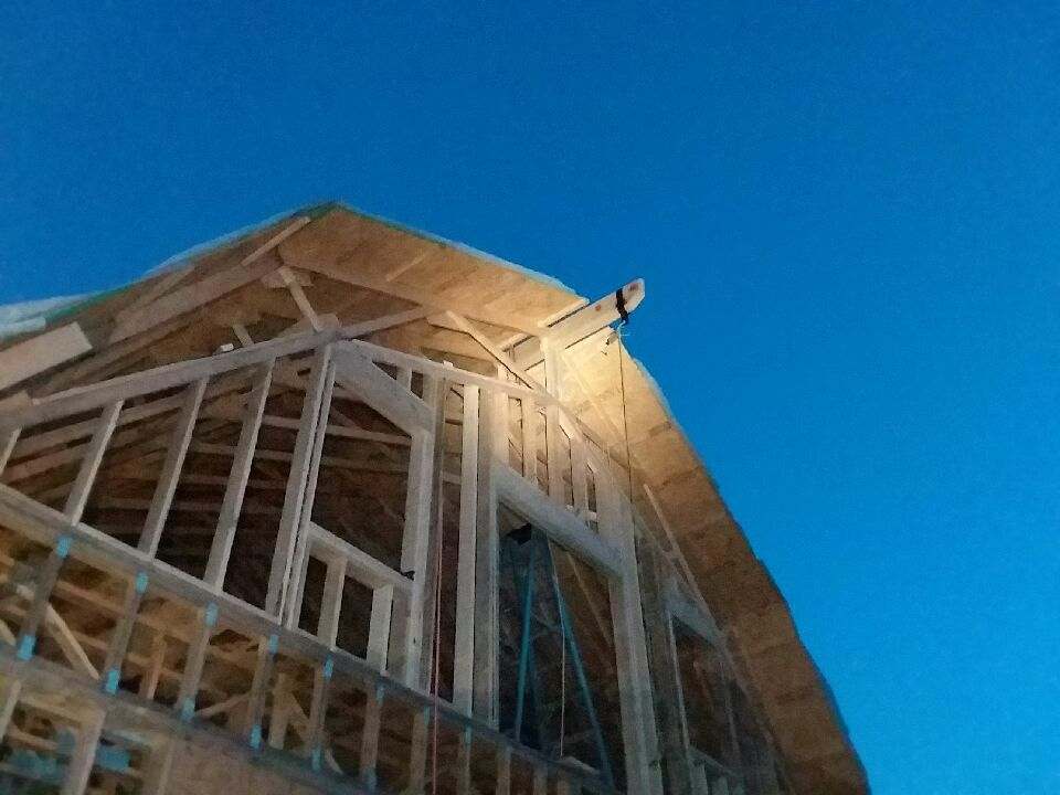

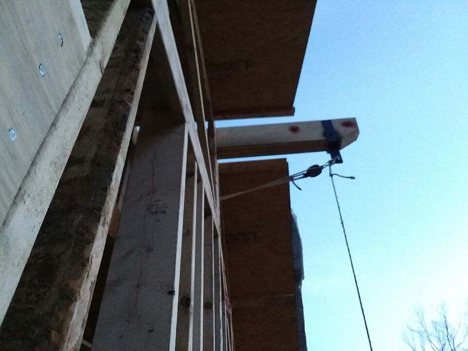

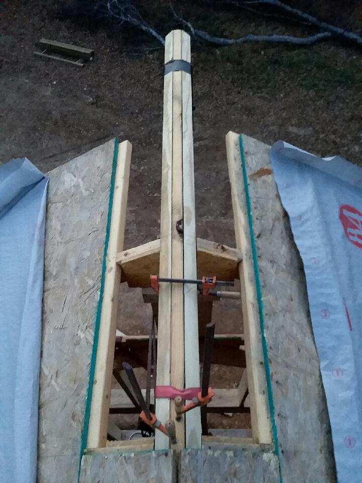

This week they got the beam built and installed for the west crows beak. It is 3 2x12s with a 3"x1/4" strap around the outer end. It is set into 2 trusses and fastened to a third. At outer truss it has a 2x post going down to the door header - 3 2x10s - for additional support. It will get a pulley - mostly for looks but also to lift things onto the 2nd floor.
Beam set in trusses - note the strap set into end of beam.
Notch in outer truss for beam.

Beam from ground with pulley.

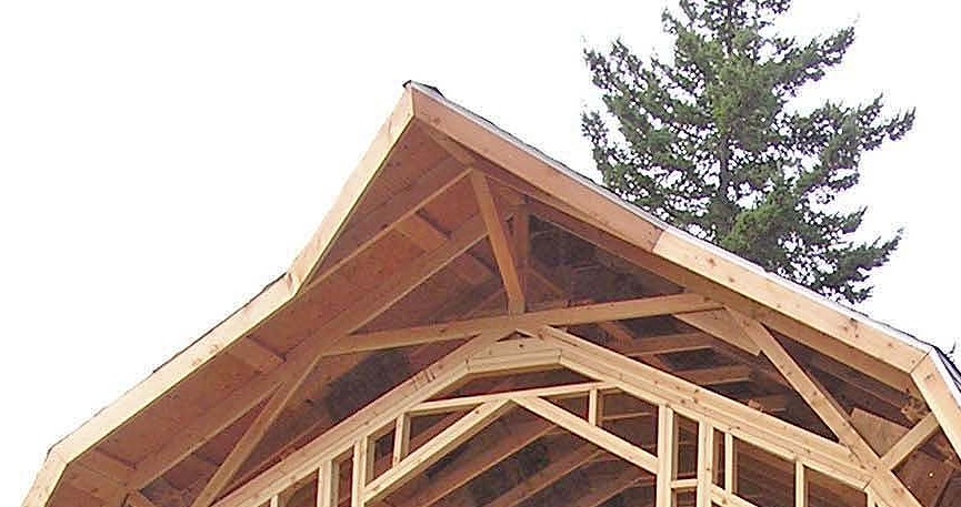

A crows beak example
